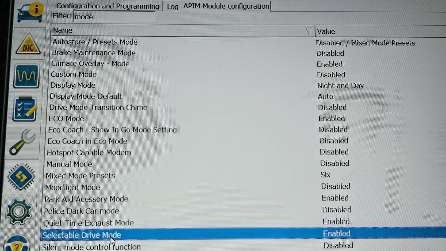

This works on the Asian modules, I don't know about US models. Backup everything on forscan before you make changes!

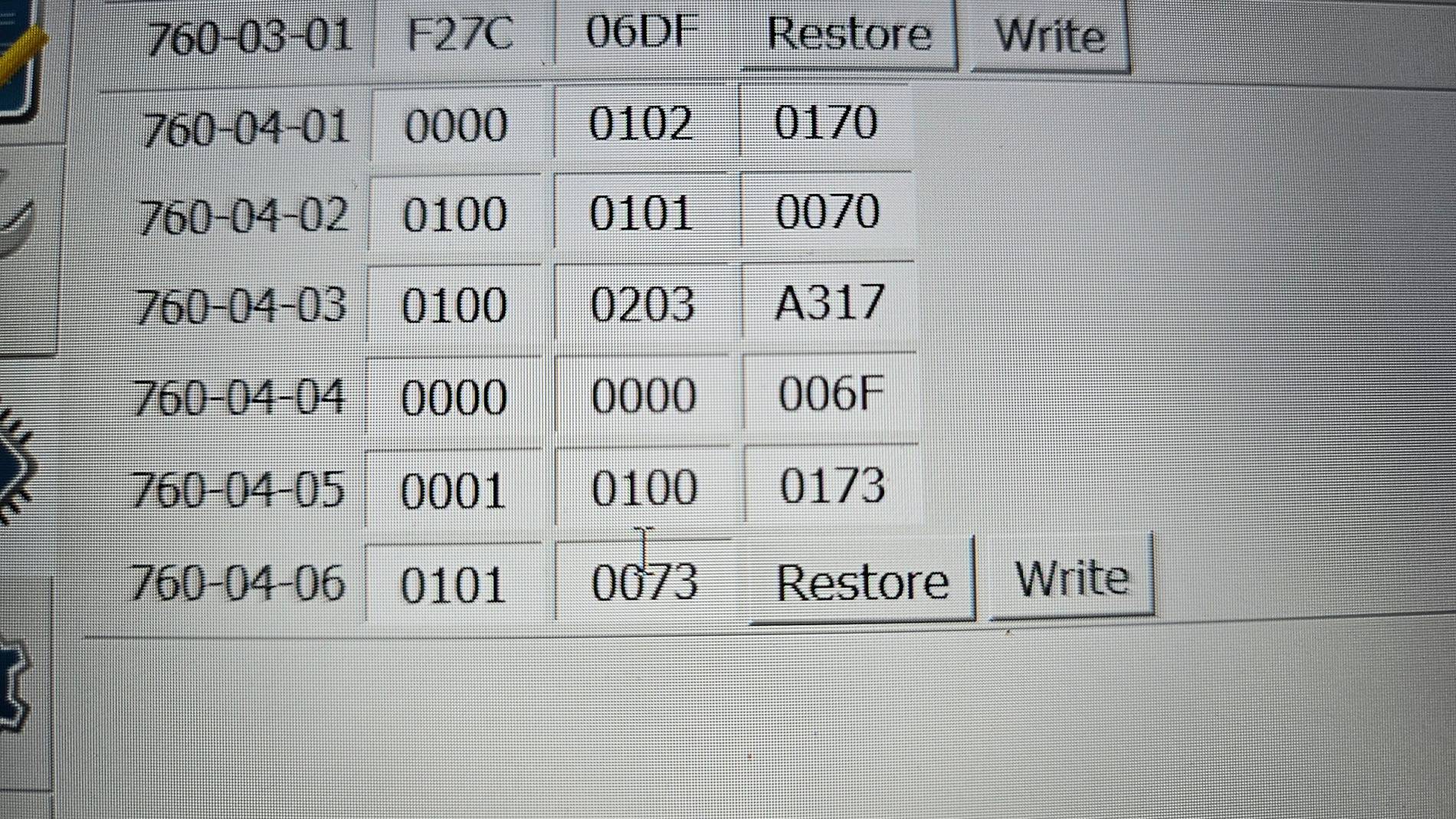

You have to enable "Selectable Drive Modes" and "ECO mode" in the APIM. See photo. Then enable SDM "eco mode" in the ABS module. Then you need to go to the ABS AS BUILT module and change 760-04-05 xxxx-01xx-xxxx.
After that reboot abs module, reboot Apim module. Scan DTC and clear any generated codes.

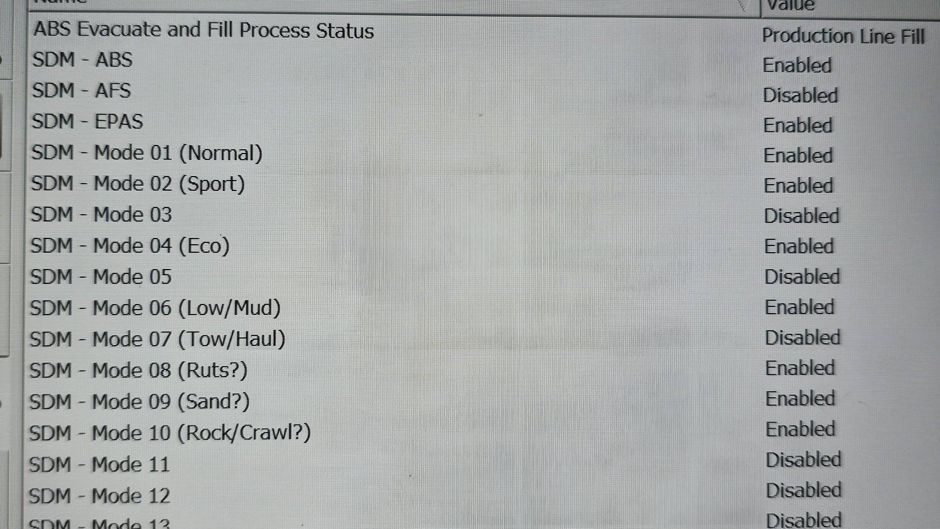

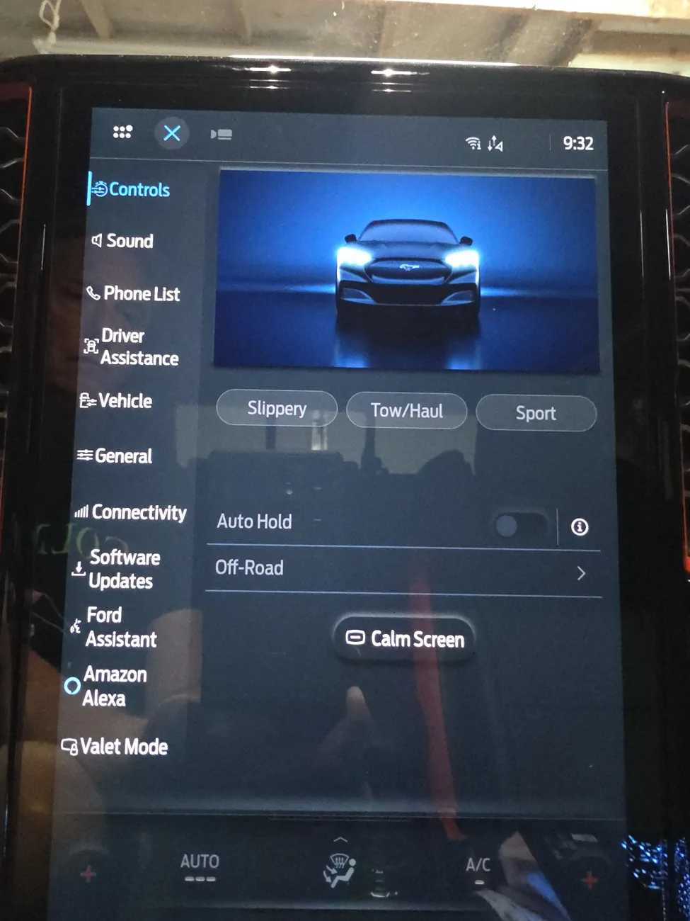

Ok, ran this procedure, since I'm interested in whether ECO mode would give any better fuel mileage driving around town. Was meticulous in all changes you posted and checked them twice. On my US 2024 Raptor, this is the only change that showed up to Modes that I can tell, plus no ECO mode.
I have one question maybe something I did wrong or am not aware of... when you say to "reboot ABS and APIM modules", I am not understanding what you mean? All I am aware of is Writing to the code once changed and saving log file after. Am I missing something I should have done, please elaborate on "rebooting modules"...?
Thanks... Steve W.

when you twist the bezel around the tow knob on the center console, you don't have eco as an option?
dude, thats crazy. i thought all the trucks came with normal, eco, and sport, at a minimum.
