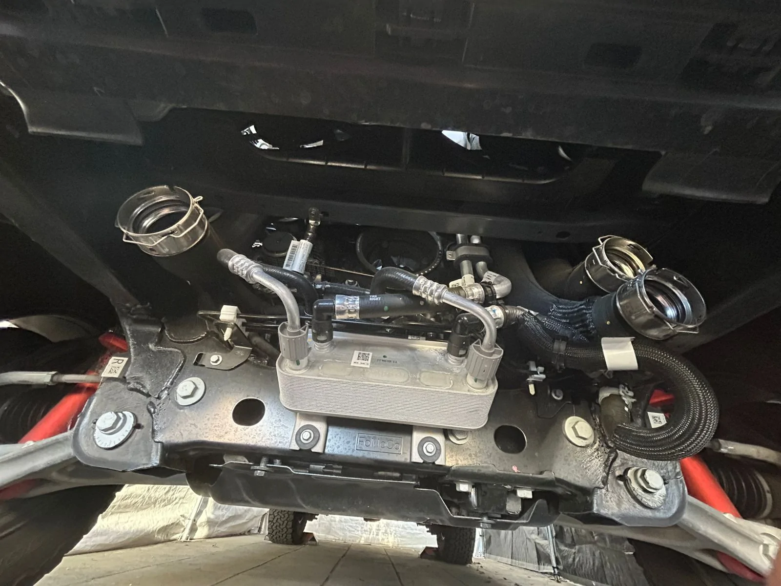

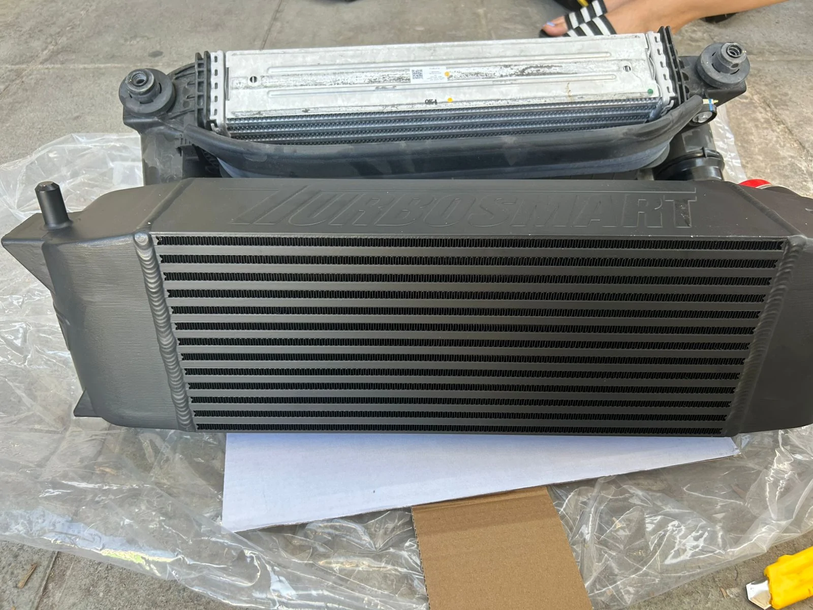

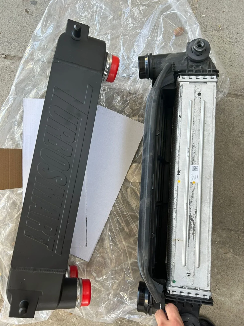

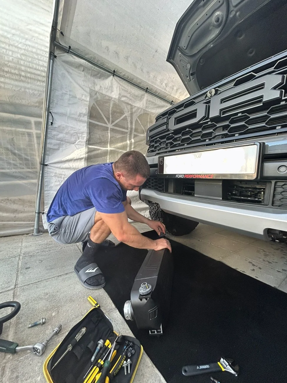

Turbosmart just released their intercooler for the ranger raptor v6 and I immediately purchased one.
The quality is immaculate. Size is around 75% more than stock,
it has a maintenance drain for condensation and blow-by.
It is compatible with oem charge pipes and oem front shutter shroud.
The only thing that is removed is the rear shutter shroud.
Ford Ranger New TURBOSMART Intercooler (Installation Pics) WhatsApp Image 2025-08-20 at 19.29.09_47b0361
Ford Ranger New TURBOSMART Intercooler (Installation Pics) WhatsApp Image 2025-08-20 at 19.29.07_e8bd85d9
Ford Ranger New TURBOSMART Intercooler (Installation Pics) WhatsApp Image 2025-08-20 at 19.29.12_61f88481
Ford Ranger New TURBOSMART Intercooler (Installation Pics) WhatsApp Image 2025-08-20 at 19.29.10_d2759324
Ford Ranger New TURBOSMART Intercooler (Installation Pics) WhatsApp Image 2025-08-20 at 19.29.13_6dsee79dc
Will take it for a spin soon and post air temp changes.

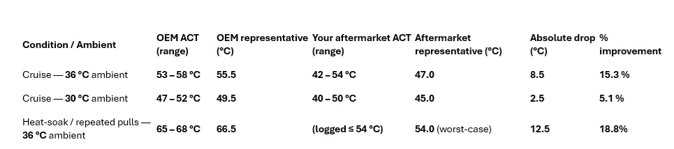

Results are in. I noticed an almost 20% improvement in temps. Truck will not get into heat soak after repeated pulls, it just keeps giving performance every time. Where as with the oem intercooler you notice drop in performance immediately after 2 hard pulls. Tested this in Cyprus morning and night summer weather.

Thanks for the post! Def interested. Any concerns with the loss of the rear shutters? Not quite sure but I think they help pull in air when not in motion? I may be completely wrong.
Salty
Salty
May 4, 2024
Cyprus
Ranger raptor V6
You are absolutely right that’s what they do. Because of the very cheap quality oem intercooler (I have never seen a worse quality intercooler in my life) truck needs to start the radiator fans to pull air through the intercooler to cool it.
There is not one aftermarket intercooler that keeps the rear shroud in my knowledge. The better quality bar/plate intercoolers flow and cool more efficient than the oem one and even when not moving cooling is still present.
The front shutters however, I wouldn’t recommend removing because they help warm up the engine in winter. Otherwise I would definitely recommend this upgrade.

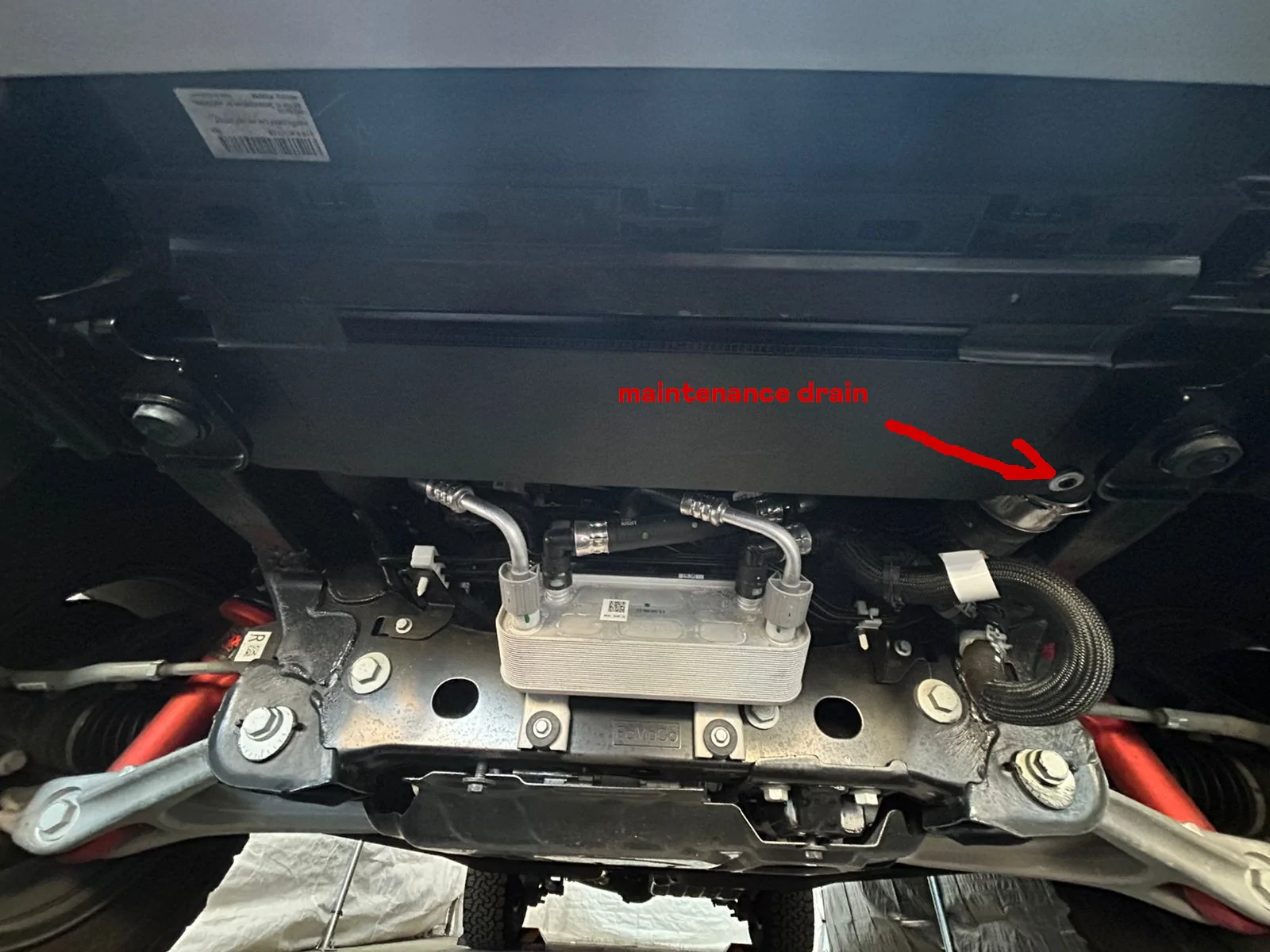

I thinking I'll pick up this same unit this fall, Does the maintenance drain plug come preinstalled? Is there just some thread sealant on it? Tapered plug? is it even really necessary?, at what intervals would you "drain"? Whats really going to come out of there? I have a long history of modding turbo cars in the early 2000's and this is a first seeing this...
Salty
Salty
May 4, 2024
Cyprus
Ranger raptor V6
It does come preinstalled. I haven't tampered with it. It is an allen key plug. I assume it is for oil/condensation blowby produced by these ecoboost engines if you haven't installed an oil catch can. The day before, I emptied my oil catch can and to my surprise I removed around an oz of blow by oil. All that would have ended into my hot charge pipes and eventually sit in my intercooler.
