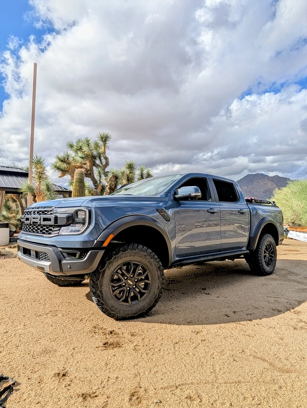

Did you go with the 2"/1" kit or the 1.5"/1" kit? Ive been looking at these too recently. Lots of info on their site. Any pics of the finished truck?

I did the 2-in front and 1-in rear. When I get home from work today I'll take some pics and post them. It's still on stock wheels and tires. I'll have new rims and tires on it by the end of the week. 35x11.5x 17

Wow, now you're socks have way more preload on them, I bet that rides rough, Are you gonna adjust the suspension sensors? reset ride height in forscan?

It rides exactly the same. It's not a preload on the spring. Yes, I zeroed out ride height using Forscan.

Cheers for the support man! Keen to see the 11.5" wide tyres. Reckon it will suit the truck better than 12.5.
Great product. Rides just as it did stock. I followed your link that you posted on how to zero out ride height using forscan. Thanks for the solid info.

Also the rims I got weigh 22.6 lb.. factory wheel is it about 29. I went with Toyo Open country At3..
Right at 63 lb. My tire and wheel will weigh exactly the same as stock but on 35s. I'm going to weigh final weight of each.

Which wheels did you chose? Nice work on the spacer install.
