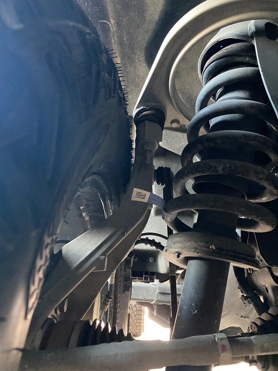

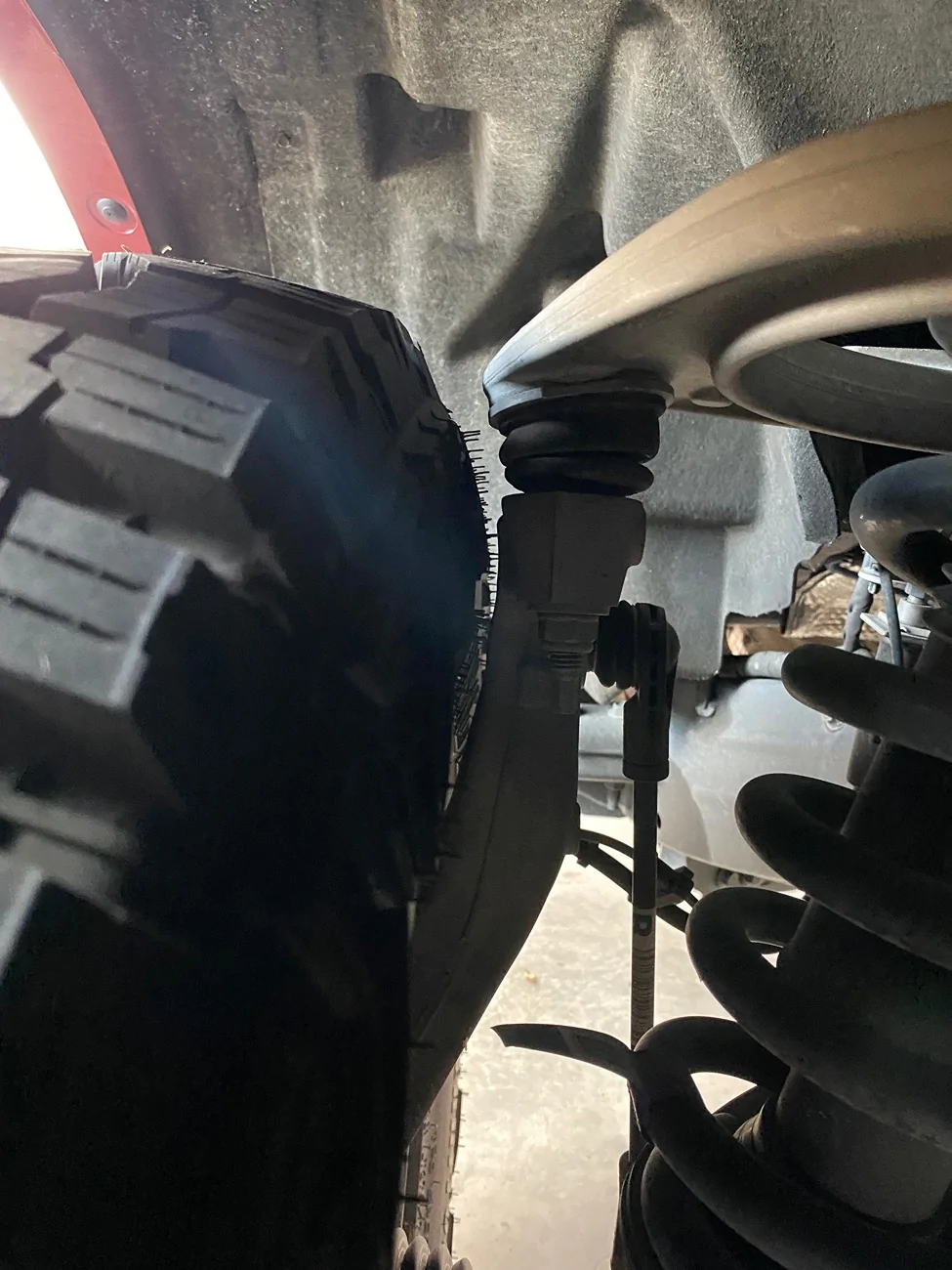

Not sure about wheels specifically on the bap 18s but this is the gap I have. It’s tight but works. Airing down would be different story.
Ford Ranger New tires (275/70/18) on my BAP edition Ranger FX4 on 2" inch level lift IMG_1268
Ford Ranger New tires (275/70/18) on my BAP edition Ranger FX4 on 2" inch level lift IMG_1269

2in ford ranger level
275/70r18
No wheel spacers
No rub
Came out just right.
This size looks right to me, what offset are your wheels. Also you think they would fit with a 1.5" front lift?

I don’t know the specs of these factory wheels but I’d say possibly could with a 1.5 I’ve seen people go with 265 and no lift and clear it.
