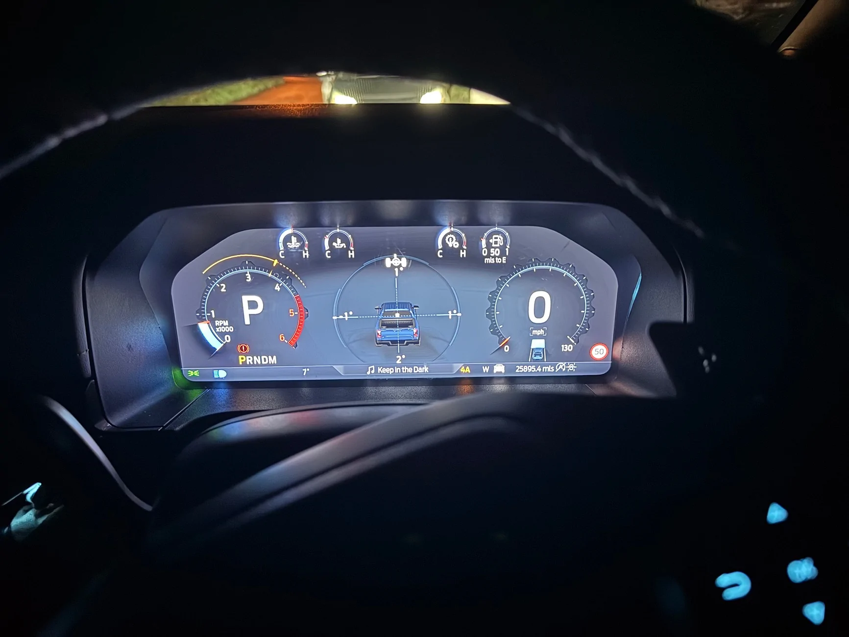

I’ve just done my V6 wildtrak, used a breaker sourced 3.0 raptor clock set.
It worked without any changes but is now coded, works really well.
Only thing I can’t get working (yet) is oil pressure gauge and still have the raptor page, which is pretty useless.
So I don’t select them in displays

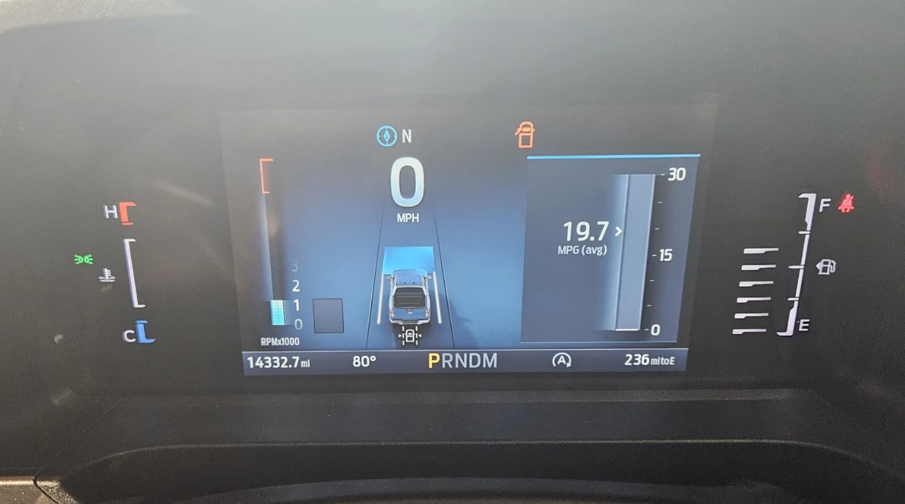

Ok, so after a roundabout saga somewhat fueled by AI nonsense I think I have this working... I restored my IPC data to the new cluster and the RPM and configurable gauges (boost, oil pressure, etc.) didn't work... AI said it was because I didn't hook up the second connector which carries the engine data, and that the connector was there, but tucked away. After tearing everything back apart and digging around more I confirmed the connector is in fact NOT there, but after watching videos of Australian 12" cluster swaps (like the video below) I confirmed that they don't connect that connector either and their gauges seem to work fine.
Then I started poking around in Forscan per the OP's post and enabled the tach, but still wasn't getting the other optional gauges.
I'm going to give https://www.compulsivecode.com/Project_AsBuiltCompare.aspx a crack and see if I can get a better picture of the differences between the clusters to figure out what to change back.

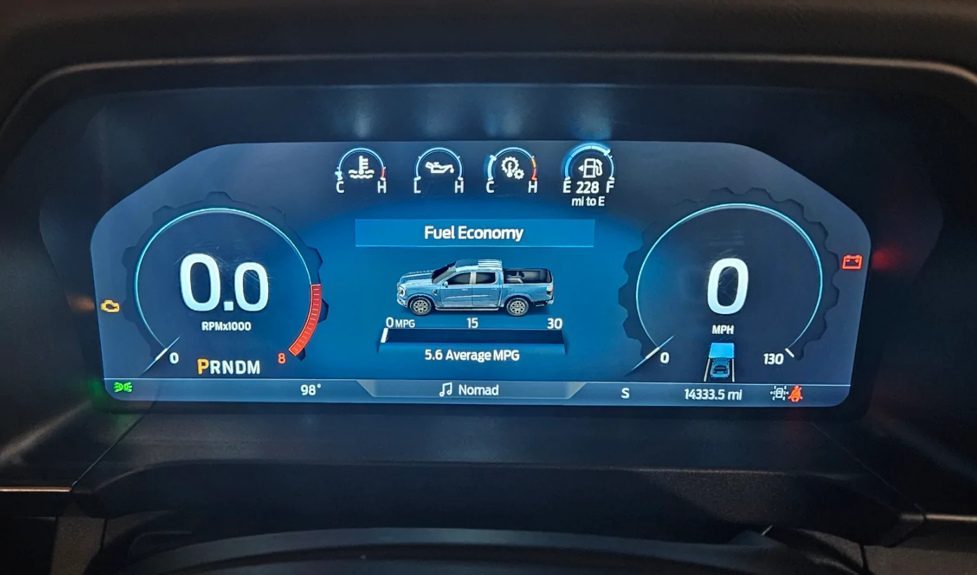

So I went through the asbuilt comparison and switched anything pertaining to gauges back to what the Lariat had and now all the optional gauges appear to work! Woohoo! (This was with the engine off, so pardon the engine and battery icons being on and everything being at 0).

Couple small scratches show here, but I can't see them while driving at all. (Plus this was before I wiped it down, I suspect most of these came off).
The cluster is VERY different... Even the turn signal noise has changed lol. (It feels more "premium", but a lot quieter... not sure I like that. I can't even hear it with the windows down...) I'm also not sure I like how small the driver assistance screen is. On the 8" cluster you could have both driver assistance and the fuel economy up at the same time and they'd roughly split the screen, but now the assistance icon is much smaller. I'm sure I'll get used to it though.
