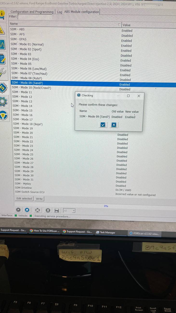

That's because he got his pre-programmed. Not sure why he didn't mention that. If you buy yours off the shelf, it should work on plug in, but you'll need to do some forscan. What? not sure yet. Not feeling like dropping 800 to 1200 on this right about now.

it's all written in the thread...my programming (done by raranger) was nothing else than VIN and km/mi in the odometer. as others say the VIN is not linked to the cluster in any manner, I believe raranger used the VIN to just set the drive mode.

Changing cluster requires programming and this programming is not only VIN change and drive modes. There are other settings to be programmed depending on vehicle features. And to know the vehicle features, you need to check the asbuilt values, and to check the asbuilt values, you need the VIN. So, this is the reason raranger asked for your VIN.
To learn more details, you may ask raranger what asbuilt values they have changed. If they respond, please share it here so everybody gets some additional information.
