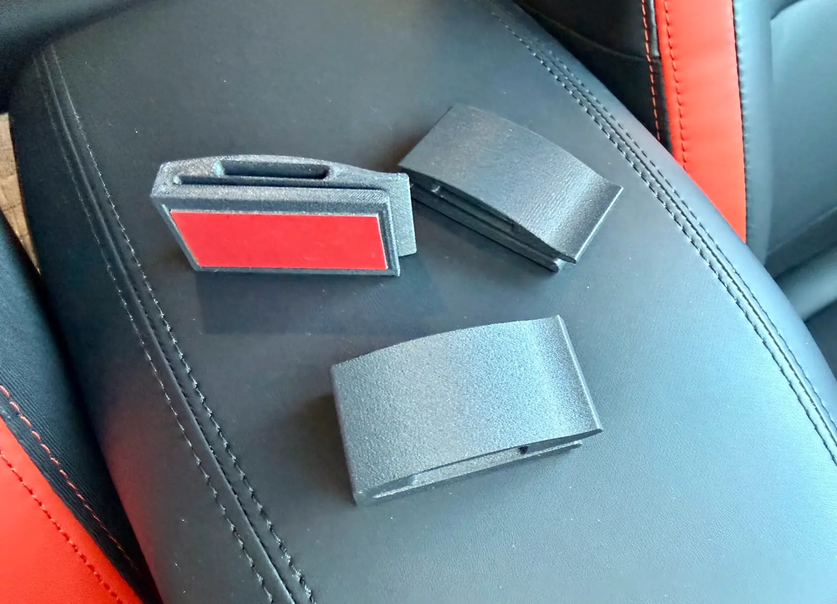

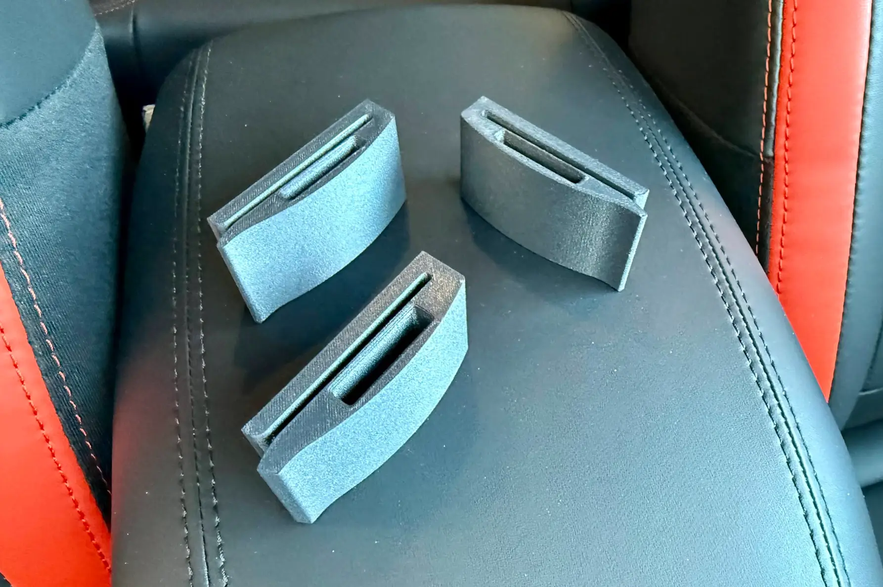

Yet another annoyance remedied by a bit of CAD and some 3D printing. This time it was to create seatbelt holders to stop the flapping when the windows are open, and to keep them from contacting the seat. I have passengers about 0.5% of the time, so the rest of the time I'd rather have the belts more secured. I could not find any commercial solutions. Maybe I'm searching for the wrong terms? Either way... 3D printing to the rescue. Again.
I'm trying to get better about posting the models so here it is for anyone who wants to print a set:
https://www.printables.com/model/1694982-seatbelt-holders-stop-the-flapping
Related thread the inspired this quick project:
https://www.ranger6g.com/forum/threads/annoying-seat-belt-flap.10874/
Held on with Scotch Extreme tape or 3M VHB
Ford Ranger Seatbelt Holders - 3D print rraptor_seatbelt_holder_1
Ford Ranger Seatbelt Holders - 3D print rraptor_seatbelt_holder_2

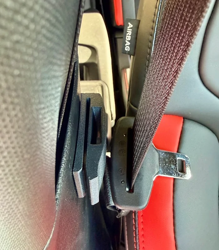

Front passenger belt:
Ford Ranger Seatbelt Holders - 3D print rraptor_seatbelt_holder_4

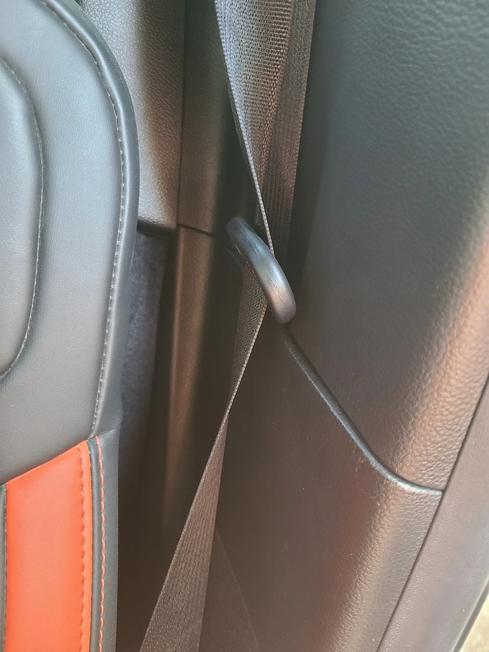

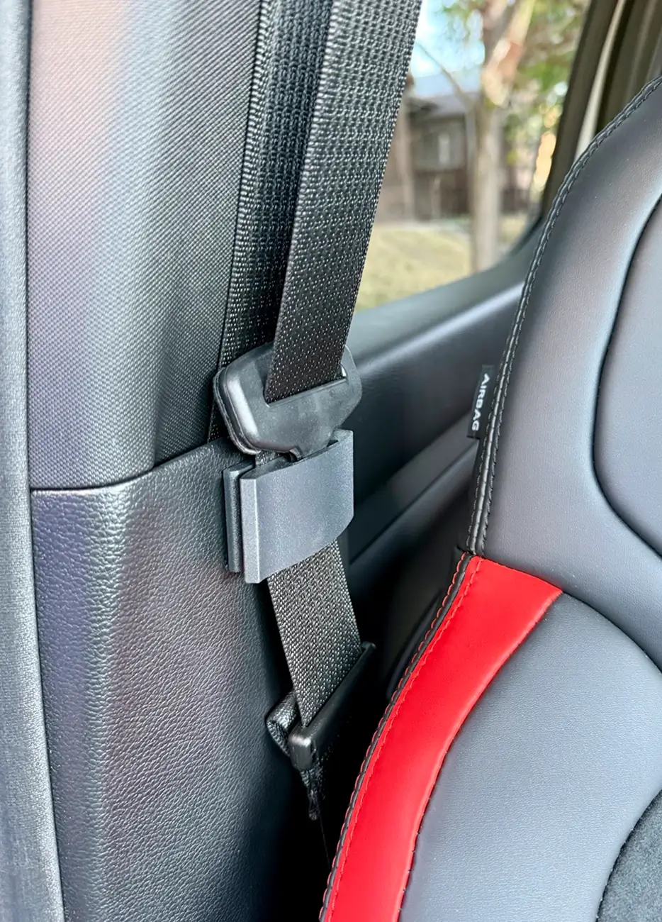

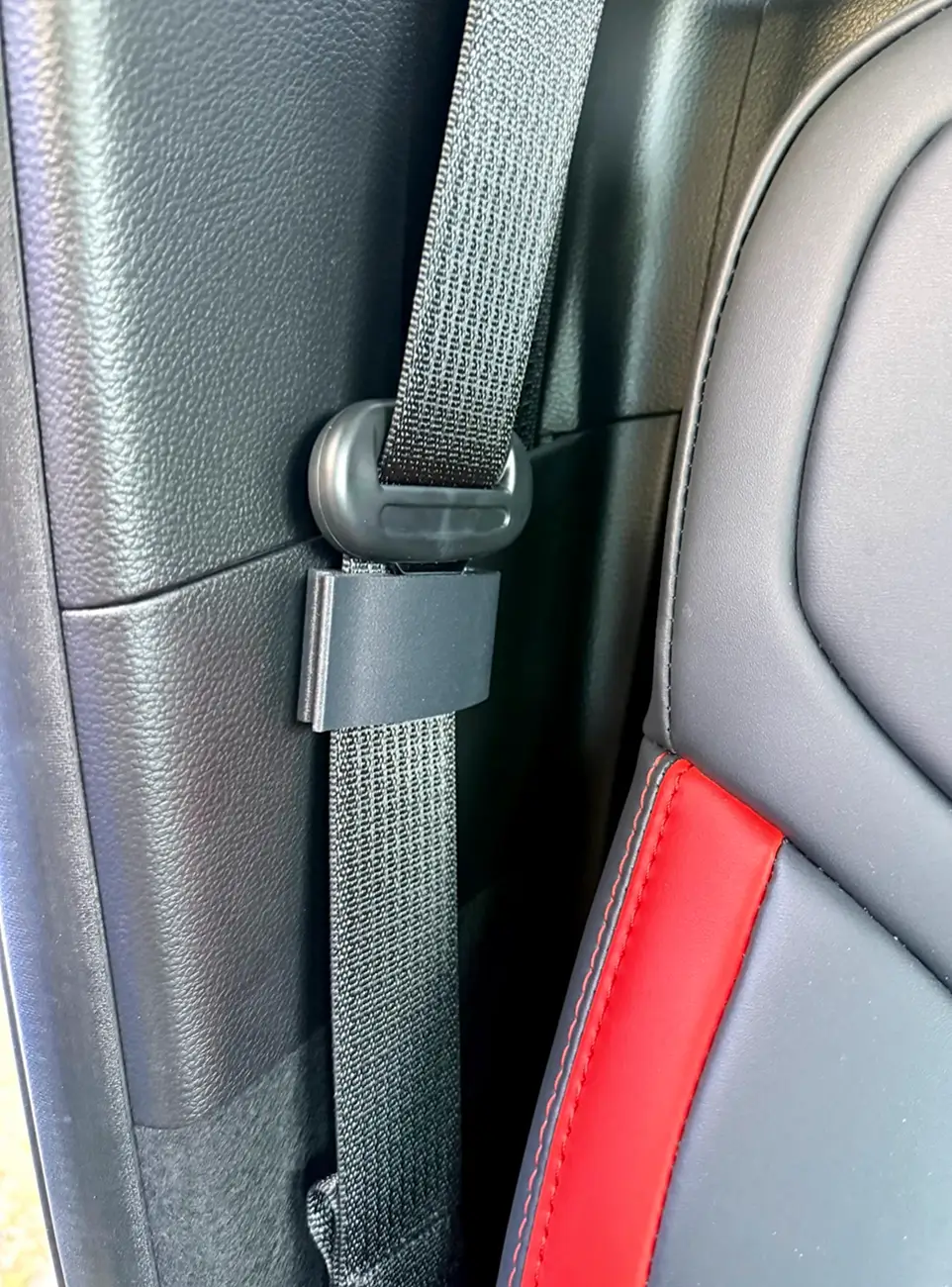

Rear passenger. The driver side is the same
Ford Ranger Seatbelt Holders - 3D print rraptor_seatbelt_holder_3

i so need these. my passenger front seat belt always taps the trim piece it runs parallel to and i hate it. i pull it over so its leaning against the seat but having a clip to hold it from flapping / tapping would be awesome.
and if that tape doesn't work, with how close that color matches, you could easily just put a small bolt and attach it to the trim and people would think it was a factory part

It was mid 80s the other day. The Scotch Extreme tape didn't hold, even on the back. So I removed all the holders, then reinstalled the rears and the new curved front one with genuine 3M VHB. I used adhesion promoter. So try #2 on whether or not they stay stuck
