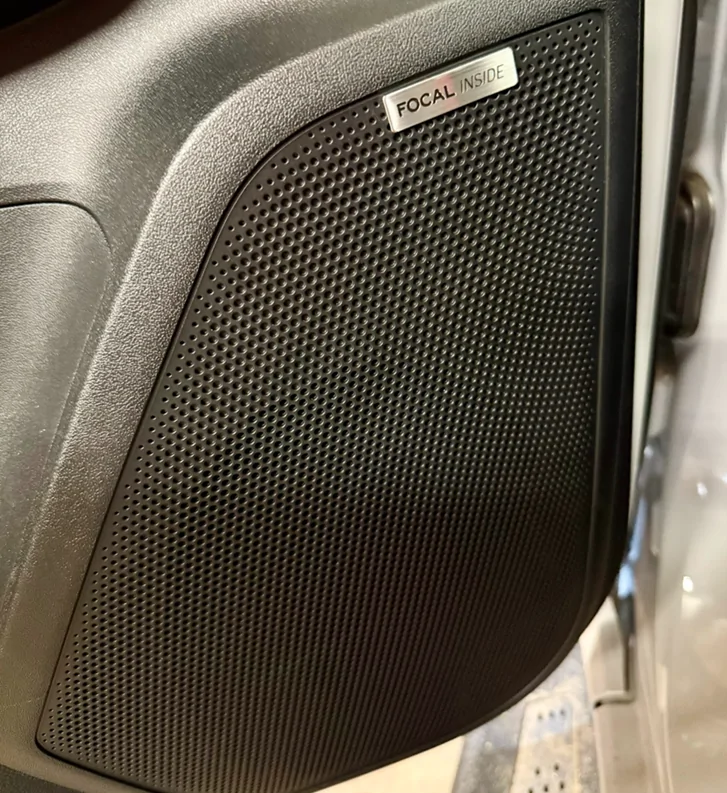

Because none of us can leave well enough alone (and why would you?), I took the last several days to complete the almost obligatory door sound deadening and Focal IS690/IC650 upgrades. I was pretty sick but the wife is out of town and I had nothing but time (and lots of Theraflu).
I ended up getting the Focals shipped in from Germany because they were almost half the price compared to Crutchfield. Siless sheets came from Amazon.
All my info came from this forum and from YouTube. I'll spare everyone every single picture of every single step, just mix in some variety

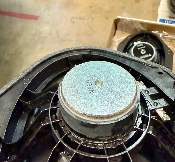

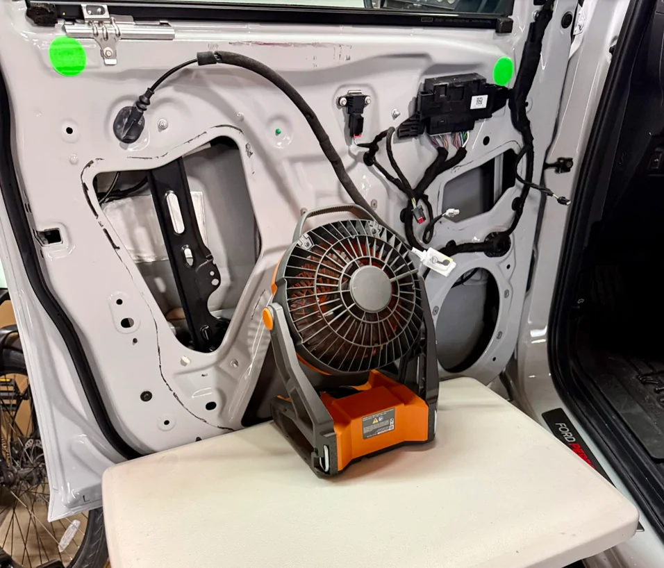

We just got done with a heavy, wet snowstorm here in Denver and the RR was outside, but I was a bit surprised HOW wet it was inside the door panels. I had to run a fan into each door for a good hour+ to dry them out. The back of each speaker was also very wet 😐

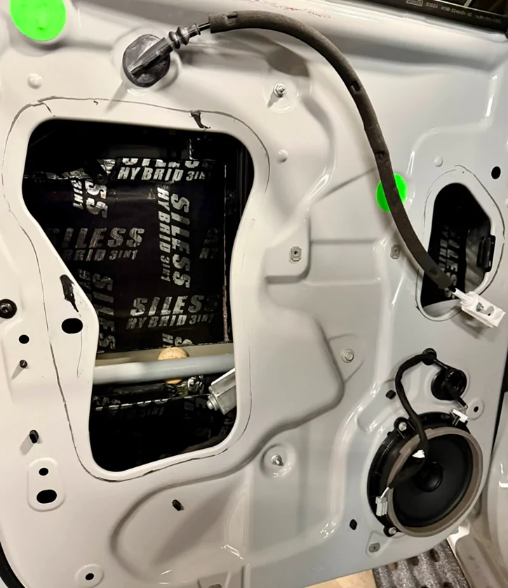

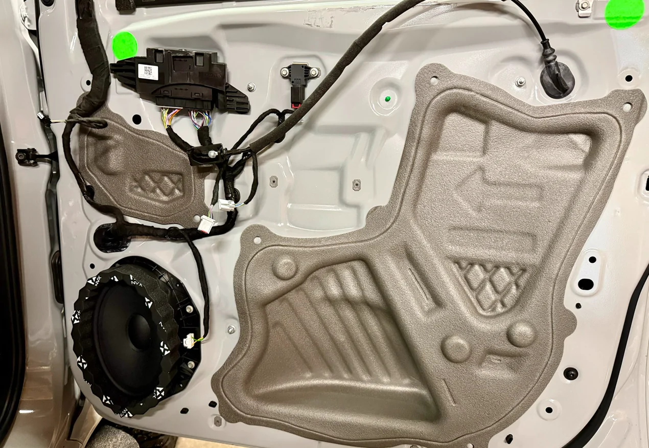

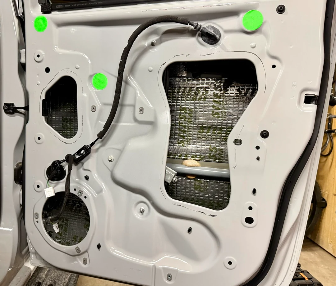

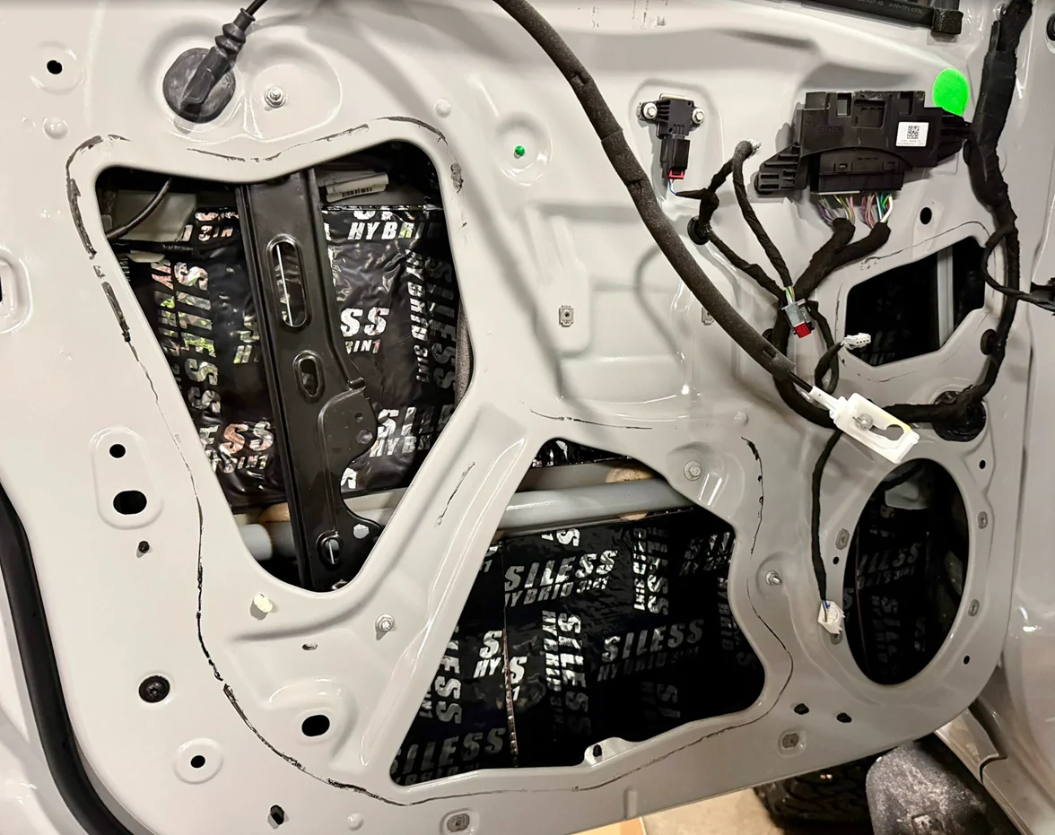

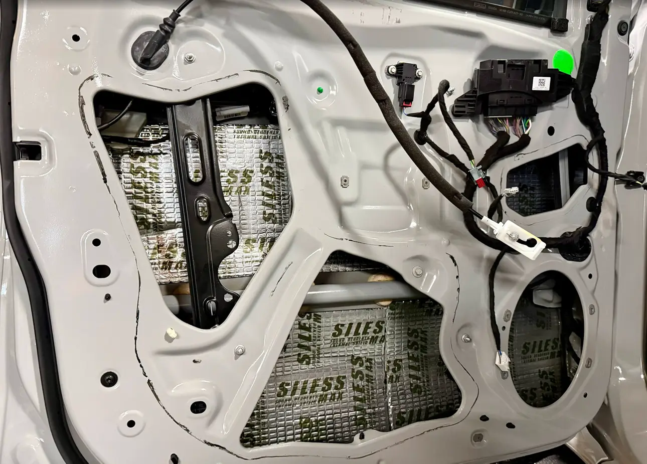

Each door got two layers of Siless: 120mil Max and then 200mil Hybrid. I didn't go for "extreme" coverage, just the largest flat panels
Fronts wrapped up with the IS690 and some NVX foam surround (it is 1" thick very squishy foam and presses against the grill)
Back doors are similar, just with less harness. The one thing about the Focal IC650 is they don't have the big plastic "standoff" that the B&Os have, so they sit further back in the door. The NVX foam wasn't useful because the gap is well over 1"
The speakers came with nice metal decals, which I installed for now. They are just stickers so if I decide I don't like them... pop
And for your listening enjoyment, a comparison of the front (with sound deadening complete) and the rear (no sound deadener yet). It is so satisfying now. Every time I walk past the truck I tap on the doors because it sounds oh so much better.

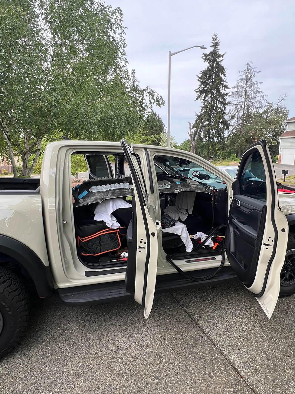

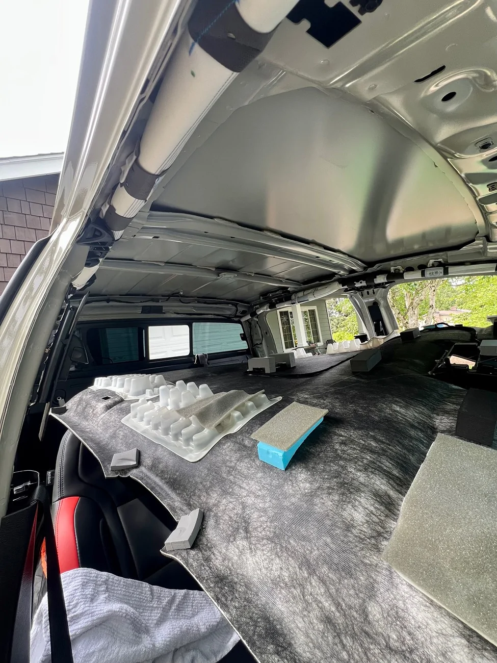

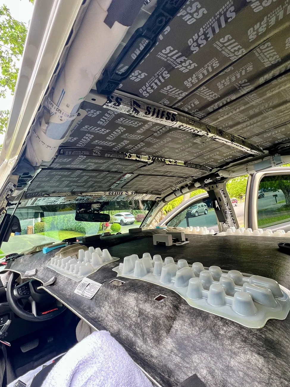

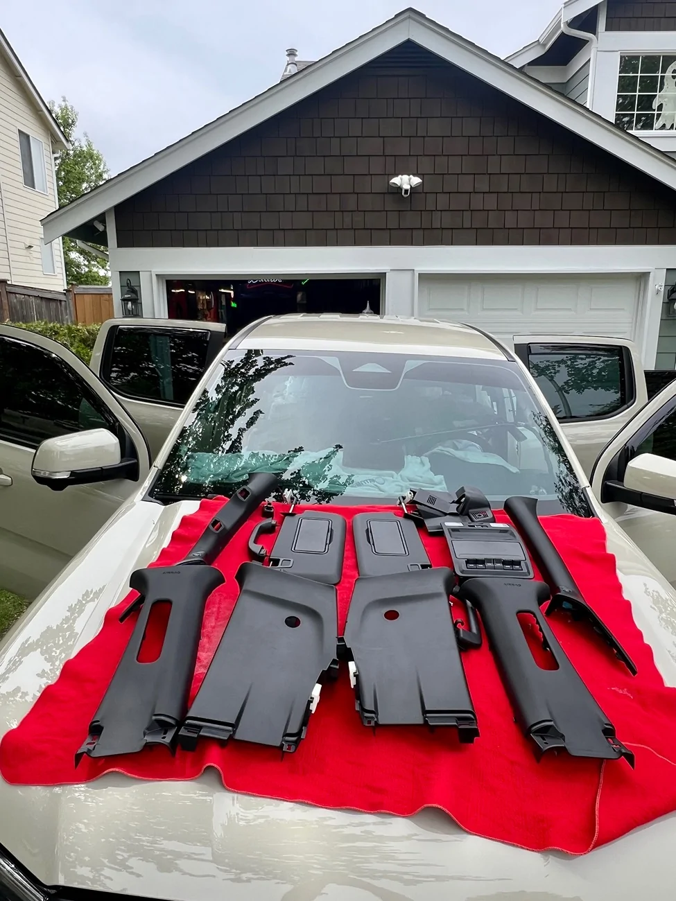

I literally just did this exact same mod last weekend. The Focal Inside speaker upgrade and 2 layers of Siless deadener to all 4 doors. 1 layer of the foil backed mastic and then a layer of the hybrid 3in1. And YES I rattle a knuckle down the door as I walk by now as well. Wife says I’m an idiot….and she’s right…she’s Always right!

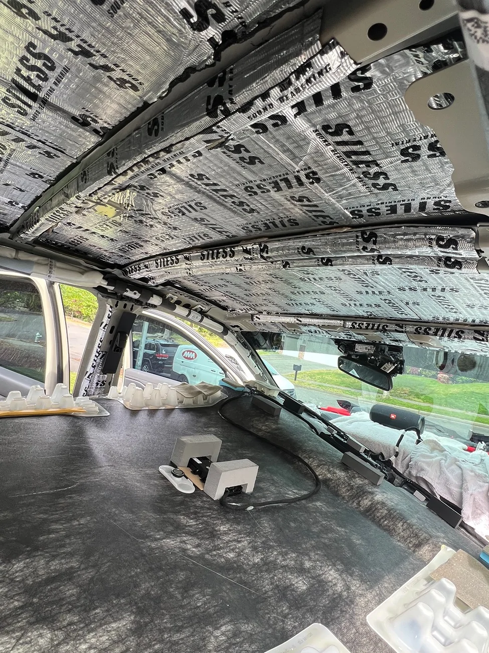

But yesterday I went after the headliner. Wasn’t nearly as bad as I thought it was going to be. Just had to be methodical and logical and it came down and went up w/o losing or breaking anything. Figured I’d only drop the h/l once so I’d go big and ended up doing 3 layers with 2 layers of the hybrid, but this hybrid was the 2in1 - much softer & more pliable for the odd contours of the roof. I did have to shave all the foam blocks in the h/l down a heavy 1/4” to accommodate the added thickness of the deadener.
WOW the stereo awakens another level with the roof being done as well, and man did it quiet down the interior even more. If you can do the doors then you should consider the roof. It’ll be worth it! Then you’ll be climbing up on your running boards rapping a knuckle off your roof….yeah she caught me doing that to…….

Man either you know what you are doing or some serious balls to take apart the headliner on a 60k truck
