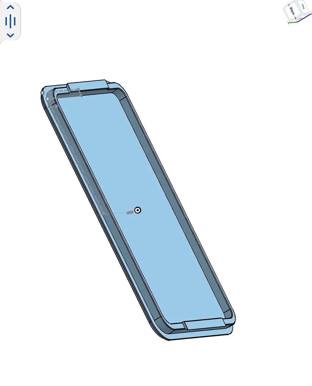

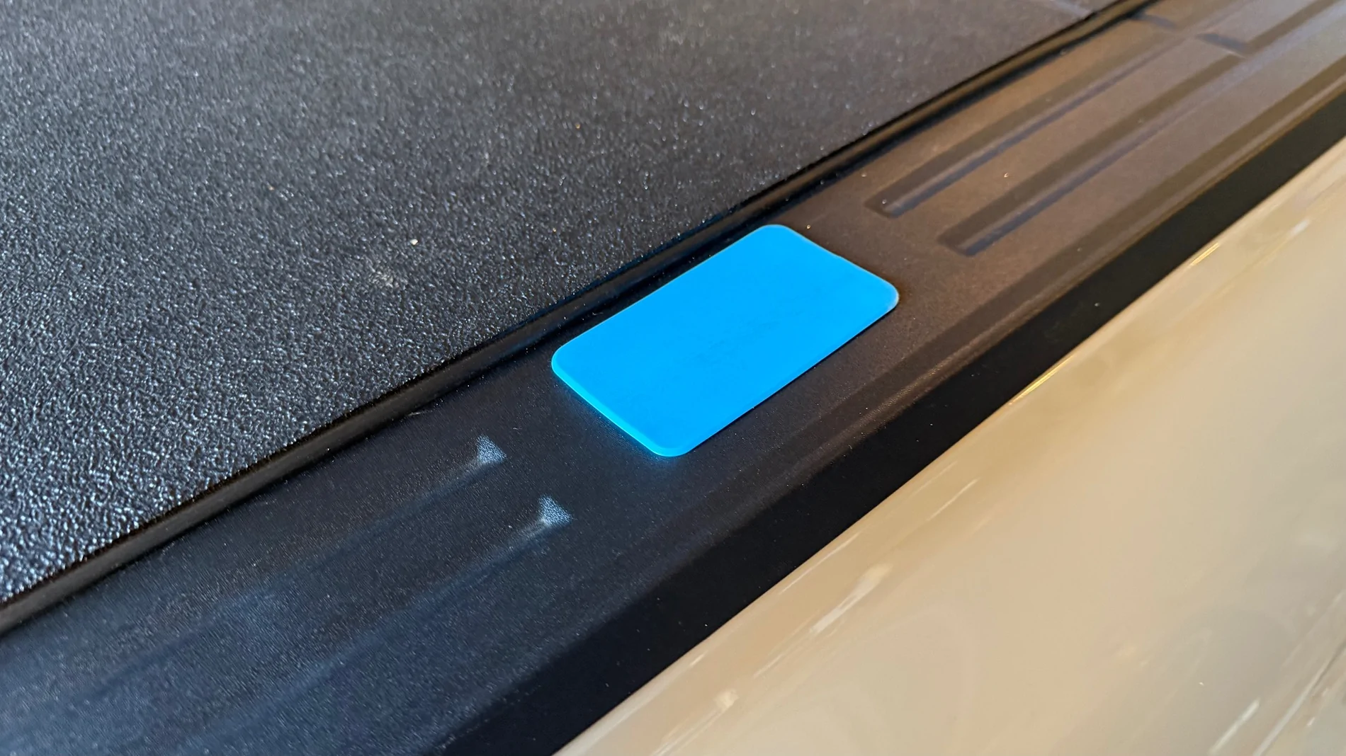

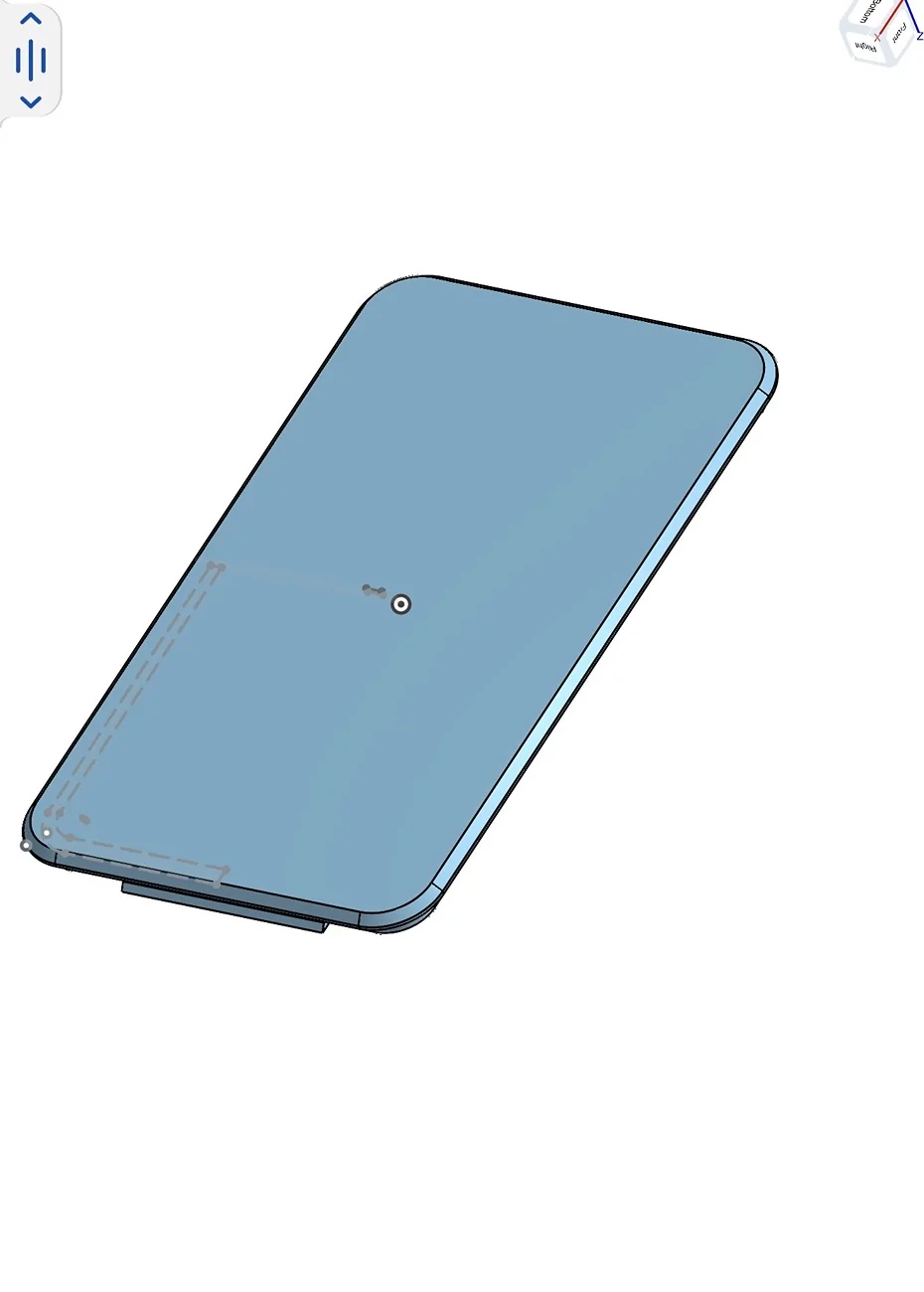

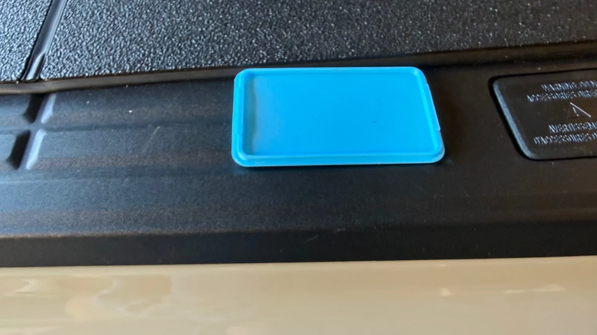

My truck sat outside Ipin the rain the other day and when I looked inside, I notice, hmm yes, those stake pockets are the primary source of leaks.
I also noticed that the plastic doohickeys that go into the stake pockets have quite a bit of room around them.
so I thought, maybe if I crammed something into that gap, just maybe, it won’t leak.
so I am going to give this a try
pardon the blue, that’s what I was 3d printing with when I thought of this Idea.

Could you make the inner part (the four walls that slide into the stake pocket) have an indentation so an o-ring could be set into it? Ideally right underneath the top part.
yeah, I wasn't clear, the part is the oring. it is printed out of flexible tpu.
it will in theory, act as a gasket between the rail plastic and the plastic part that inserts into that spot, added bonus it covers the whole seam between the two
I guess you could make something more rigid that would clamp down on the rail plastic that had an o ring. maybe it could be a two part bolt together part
I will see how this works first.

Purdyd - Did your 3D printed TPU stake pocket cover effectively seal out water? If so, are you making them available for purchase?
Last time it rained I still had some leaks and not sure if it was one of the stake pockets or the gap between the tonneau rail and then plastic.
I also have a little bulging going on in the middle pockets and not sure if these parts caused it,
I still haven’t had them in really warm weather but will be testing that out next month. I think a better solution might be a clamping cover.

Any further progress on this?
I've been thinking on this, and I think I have an idea for a solution, though absolutely no skillset to design it.
We keep making plugs that go in from the top, however the leaks are coming up from the bottom. How about designing a plug that comes in from the bottom and seals the leak there, at the metal as opposed to the plastic on top? Has anyone tried that? Make it out of TPU?
they survived 110 degrees at 80 mph. I think the worry for me is that plastic creeps over time and the parts will become loose. I still have leaks but need to double check where they are. It’s not a priority for me as California in the summer has virtually no rain.
i think the problem with plugging the holes is water would sit on the rail and just roll off
there’s another thread on this but I think the best way is to clamp the rail top between two parts with a gasket.
