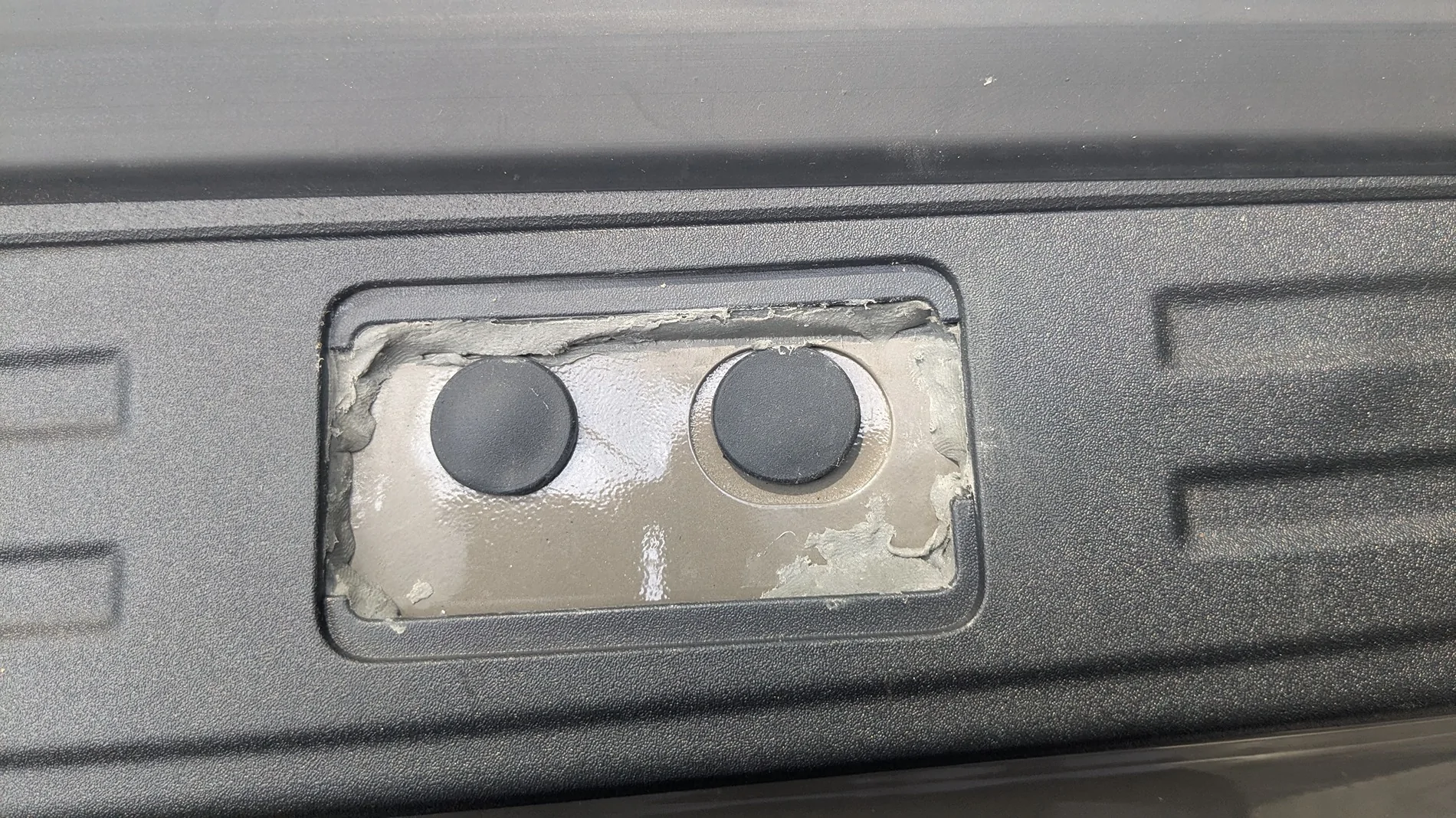

As of now, my current plan is this:
I have similar plugs to the OP and am going to plug all 12 of the exposed holes below the covers. From there, I'm going to use Duct Seal to seal the edges around each pocket, below the cover. Duct Seal is that dark grey, forever pliable play-do like stuff used to seal foundation holes for electrical, ducts, etc. Similar to rope caulk but designed to last indefinitely without drying out.
Will it be as good as others fixes here? Definitely not. But I don't need waterproof. I just don't want a bucket of water in my bed each rain 😅 My tonneau already leaks so just want to eliminate as much as I can.

Update: tried the stake pocket duct seal and unfortunately it wasn't good enough. Still had some leaks, though it did improve a bit. I'm assuming there is just too much little gaps and flex for it to work correctly.
I just can't believe nobody has made a viable product here. You think it'd be a no brainer. I'd pay 100 bucks for a set of 6!!
I'm thinking of just doing what some others have done and using black silicone caulk to seal the pocket cover in place. Not the prettiest but not sure what else to do here.

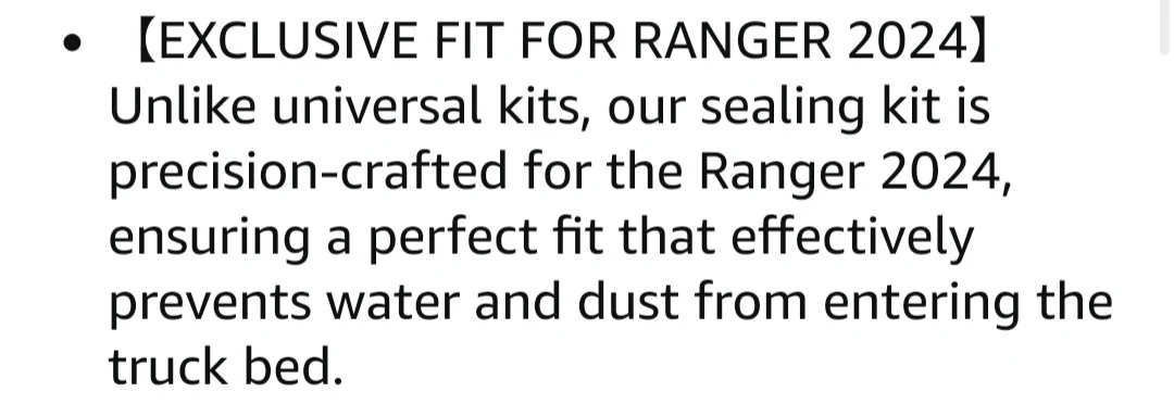

FergyA
Jul 2, 2025
183
152
LA County, CA
'24 Ranger XLT FX4
Mech. Engineer
It's a pretty well known fact that the 24-25 and 26 are different rails.
I don't think they're reengineering them, it's a product from Europe that was successful there that they seem to have decided isn't worth continuing here. (That's hyperbole though, the rep said they haven't decided yet if they will restock them, so there's still a chance). I'd recommend anyone who actually bought one for a 24 or 25 leave a positive review.
The item description says 24. Just sayin.

alrashid2
May 4, 2026
63
577
411
PA
Yes agreed, so Keko should not list it for 24+. I did let them know their information was incorrect
