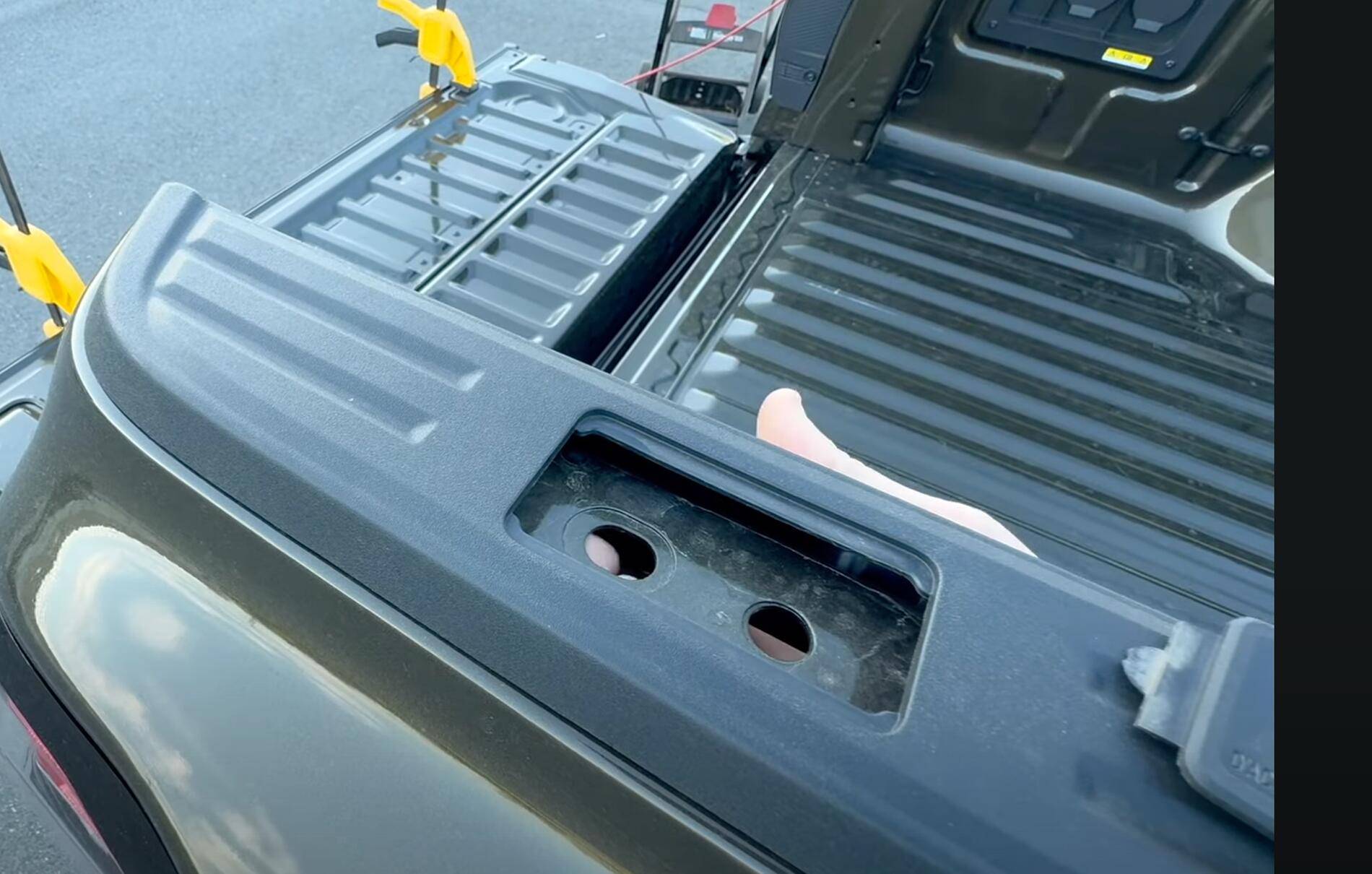

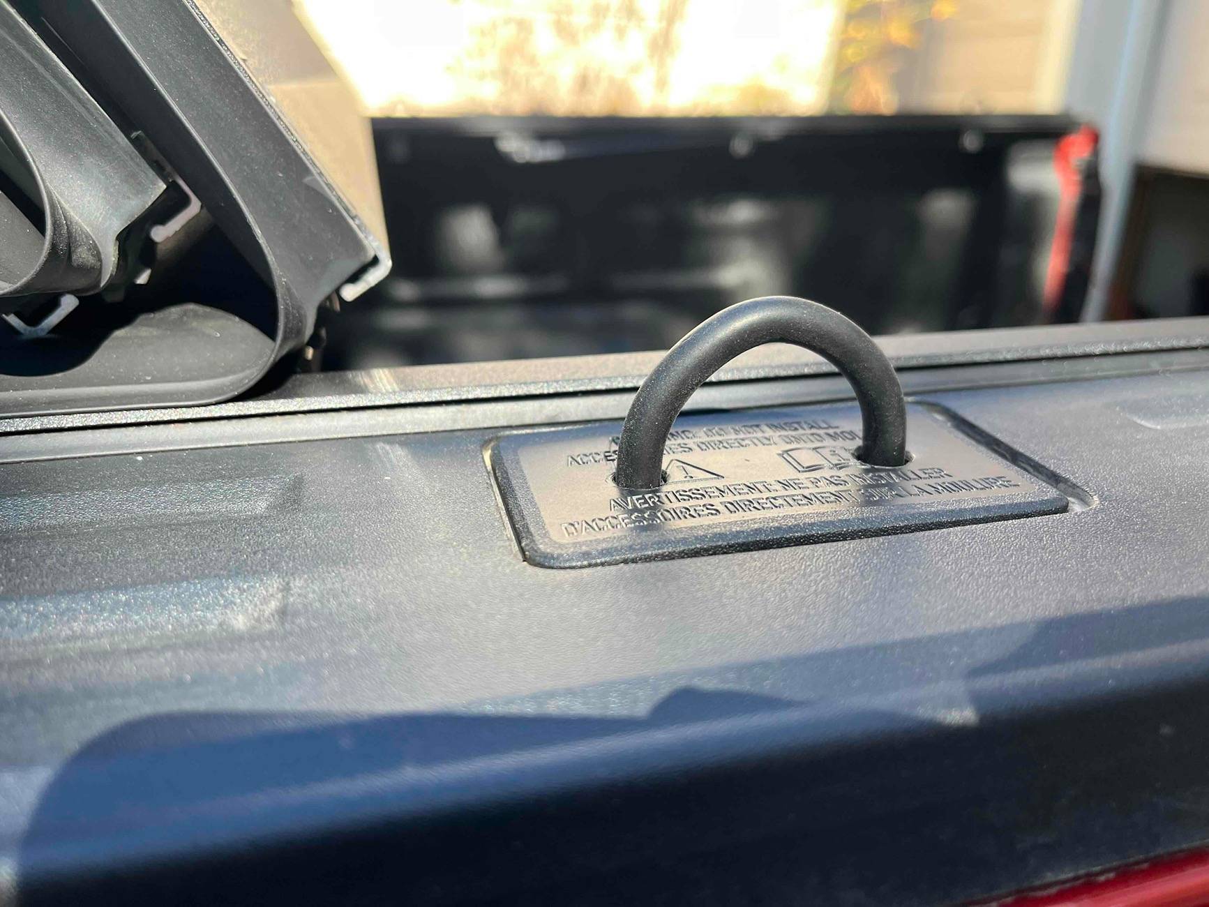

I'm looking for a solution to tie down a tent on top of my hard tonneau cover. Ideally it would be possible to run a couple of straps between stake pockets, but I can't find the right solution for the Ranger's stake pockets.
Ford makes something that looks perfect for the F-150: https://accessories.ford.com/retractable-flush-mount-black-stake-pocket-tie-downs-2pc-set-1
However the Ranger's stake pockets are different and have two holes in them (pic attached).
Has anyone found a solution cleaner than some eye bolts from the hardware store?

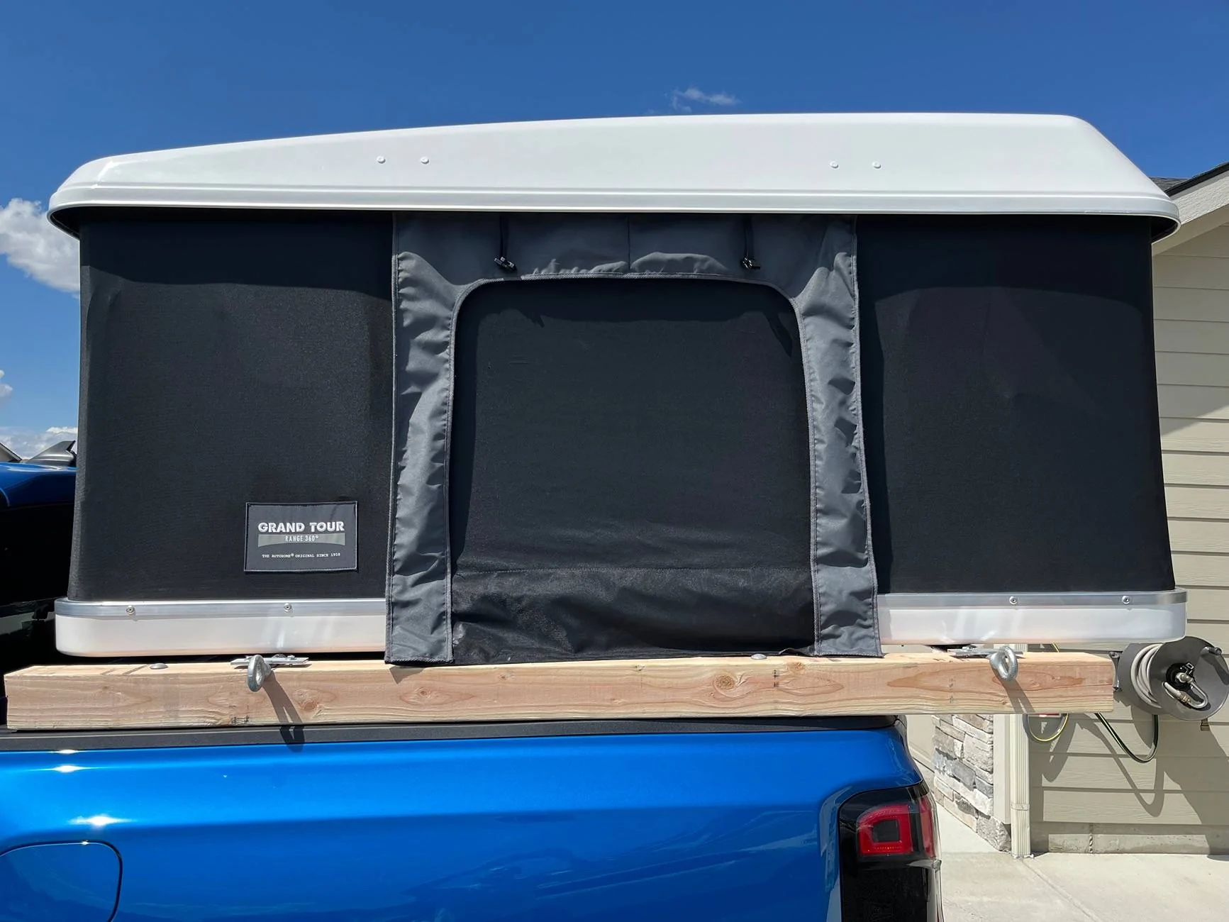

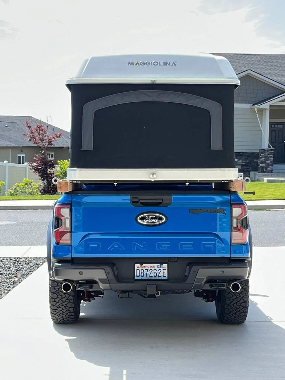

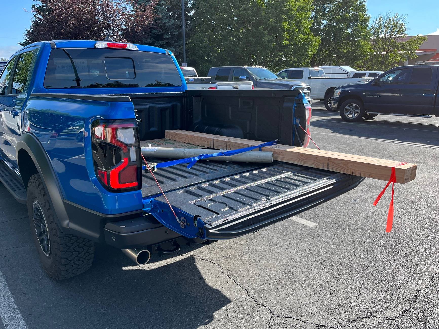

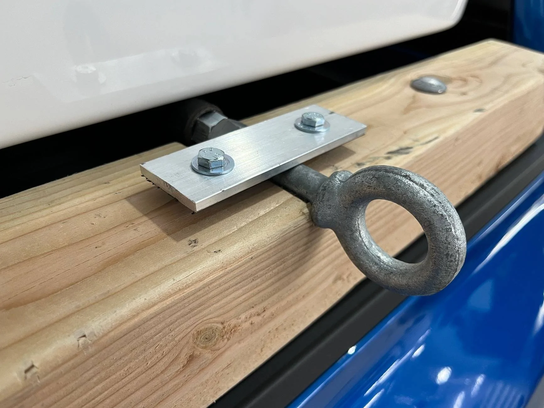

I installed a couple of temporary 4x4 wood posts on top of my bed rails. I needed a way to transport my rooftop tent which is for sale. I just drilled through the wood at each stake pocket cavity, using the front holes which are round (a couple of the pocket rear holes are oval). The wood was not perfectly flat, so I added 1/8” hard rubber pads at each bolt. I used 1/2”x6” galvanized carriage bolts and large area washers underneath the rail.
Ford Ranger Making use of the stake pockets IMG_6957
It looks amazingly dorky, but I worked well, and now I can transport the tent to a buyer’s home if needed. I sold the Land Cruiser 200 that it was last mounted on, in order to pay for the Raptor.

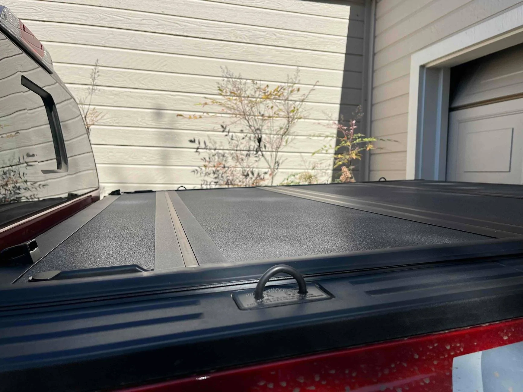

I reached out to BullRing and they do not have any Ranger stake tie downs in the works, but they did kindly offer to borrow my truck for two weeks for R&D ?.

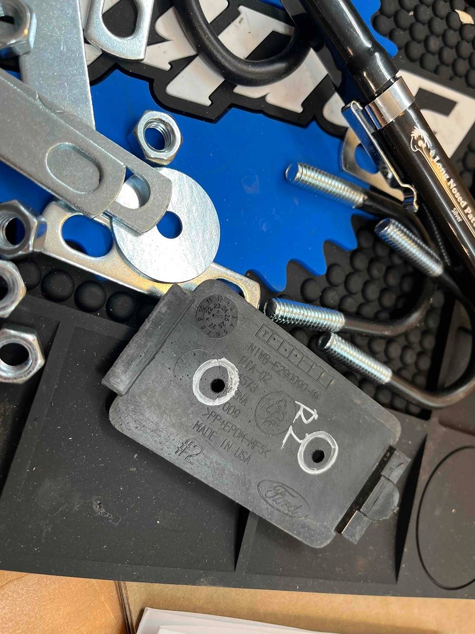

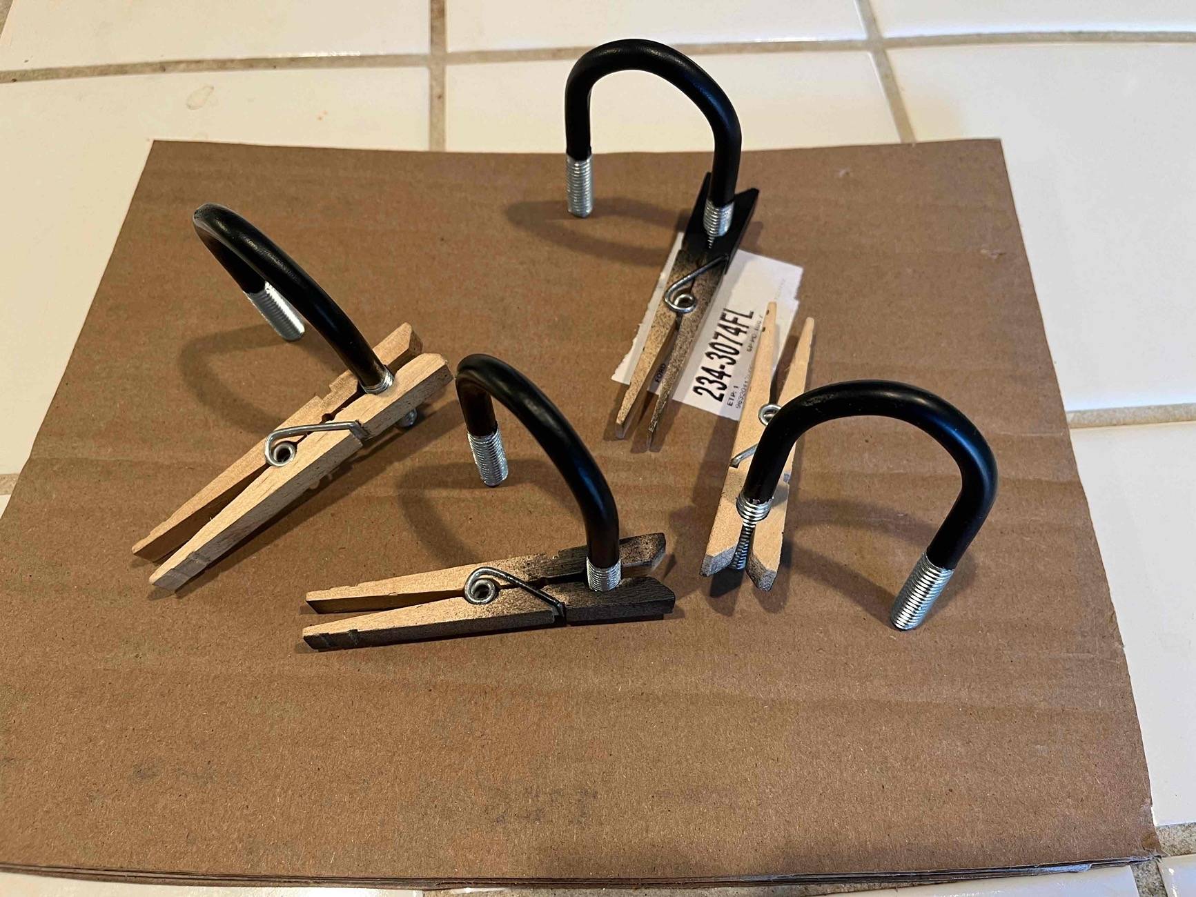

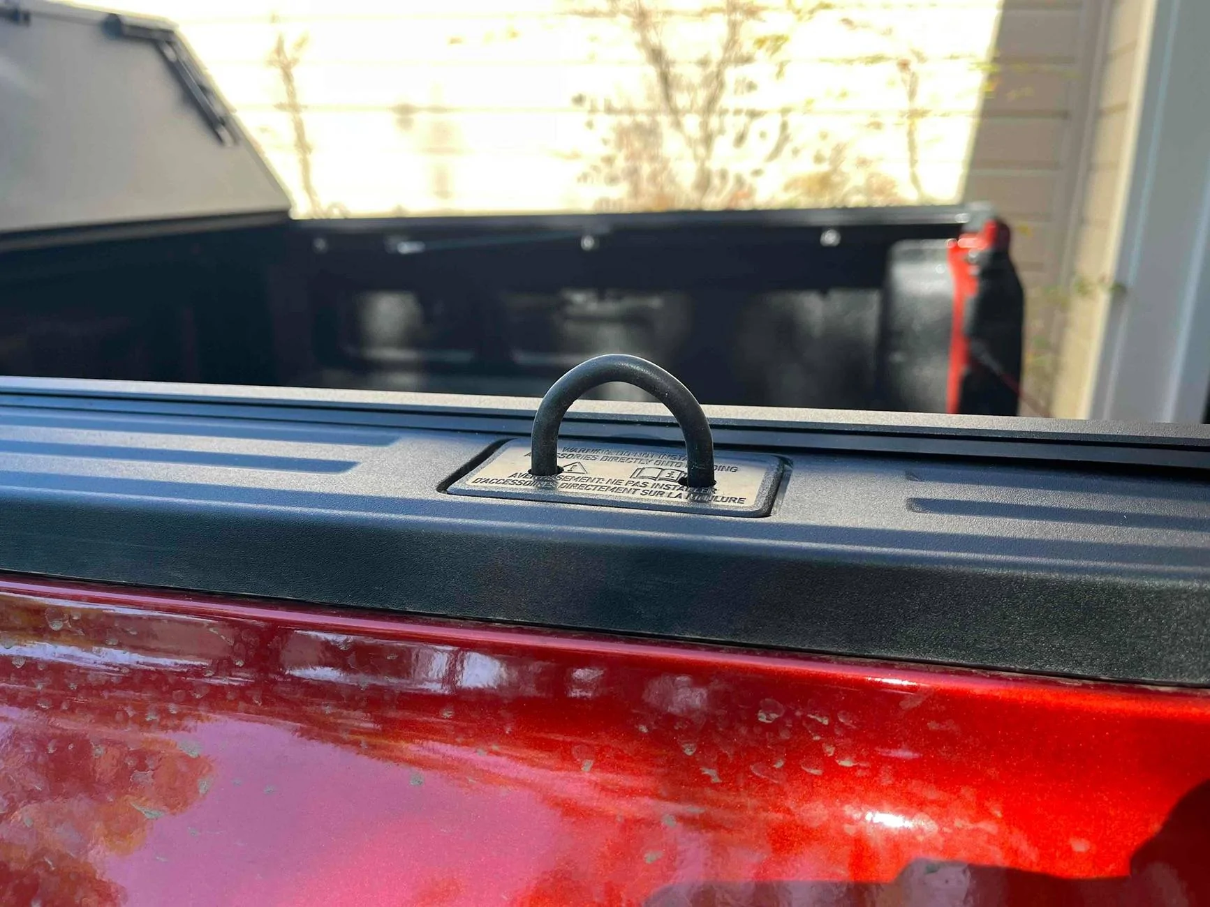

I ended up solving my problem with about $8 in hardware.

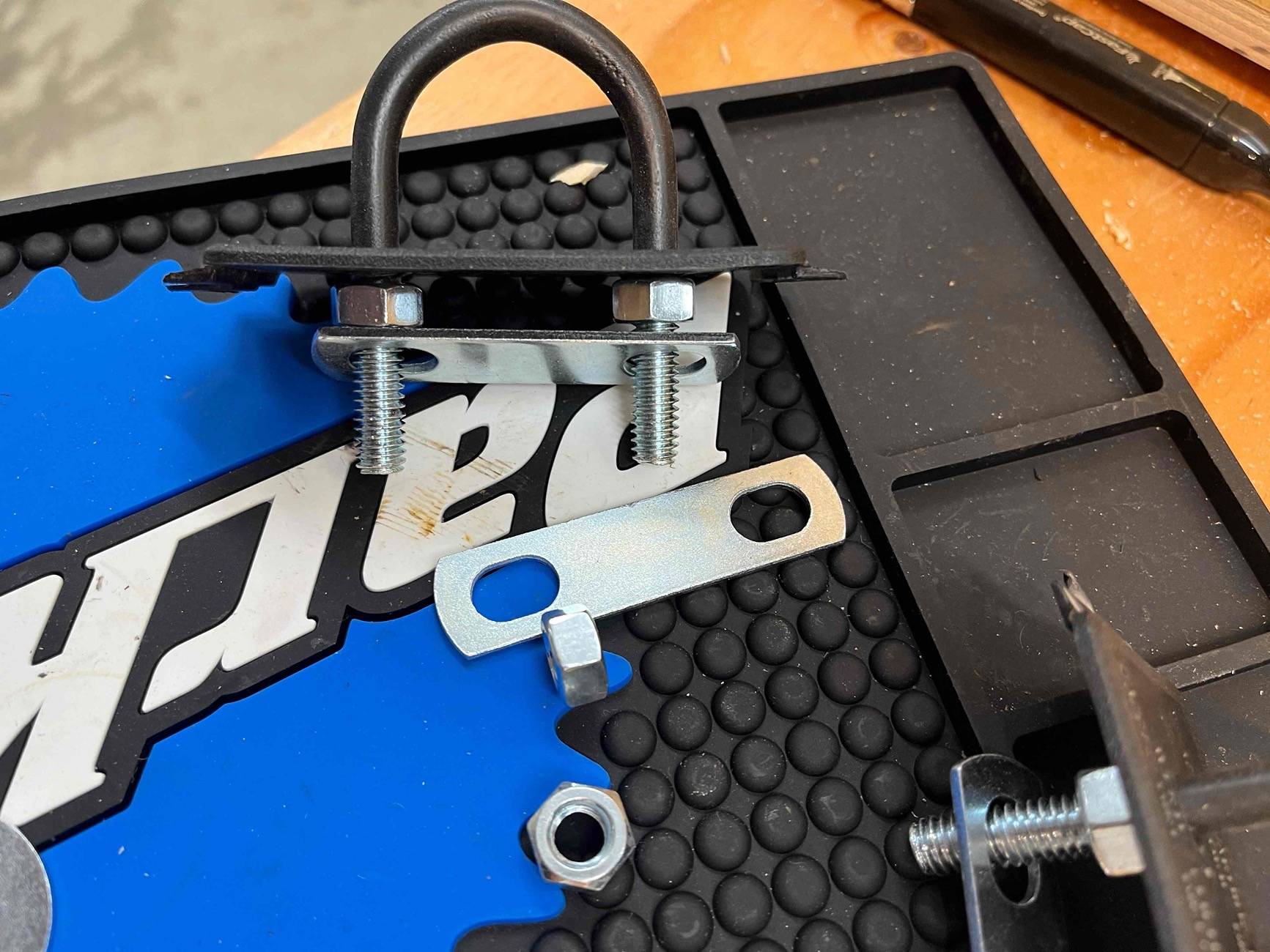

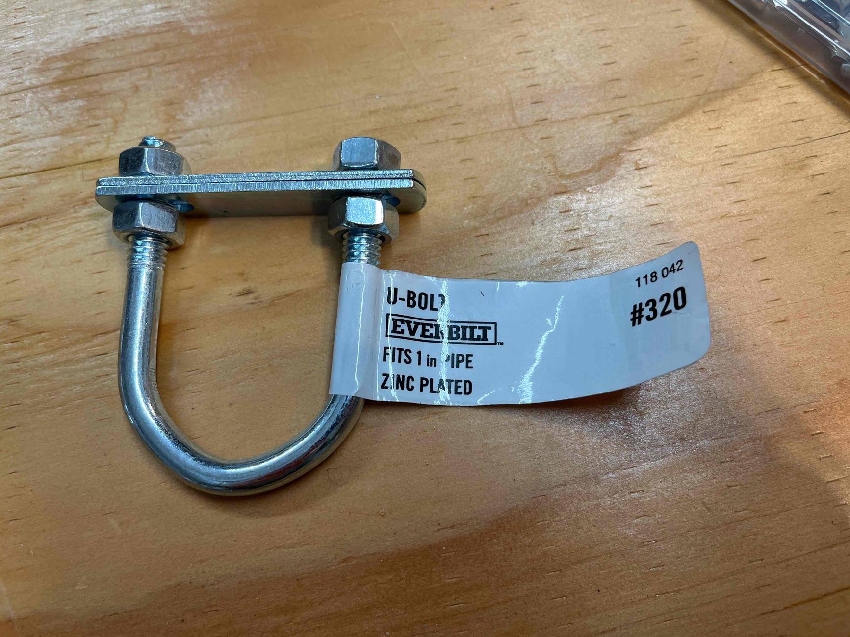

Pics for reference:
U-bolts
Ford Ranger Making use of the stake pockets IMG_4901
Painted u-bolts
Ford Ranger Making use of the stake pockets IMG_4904

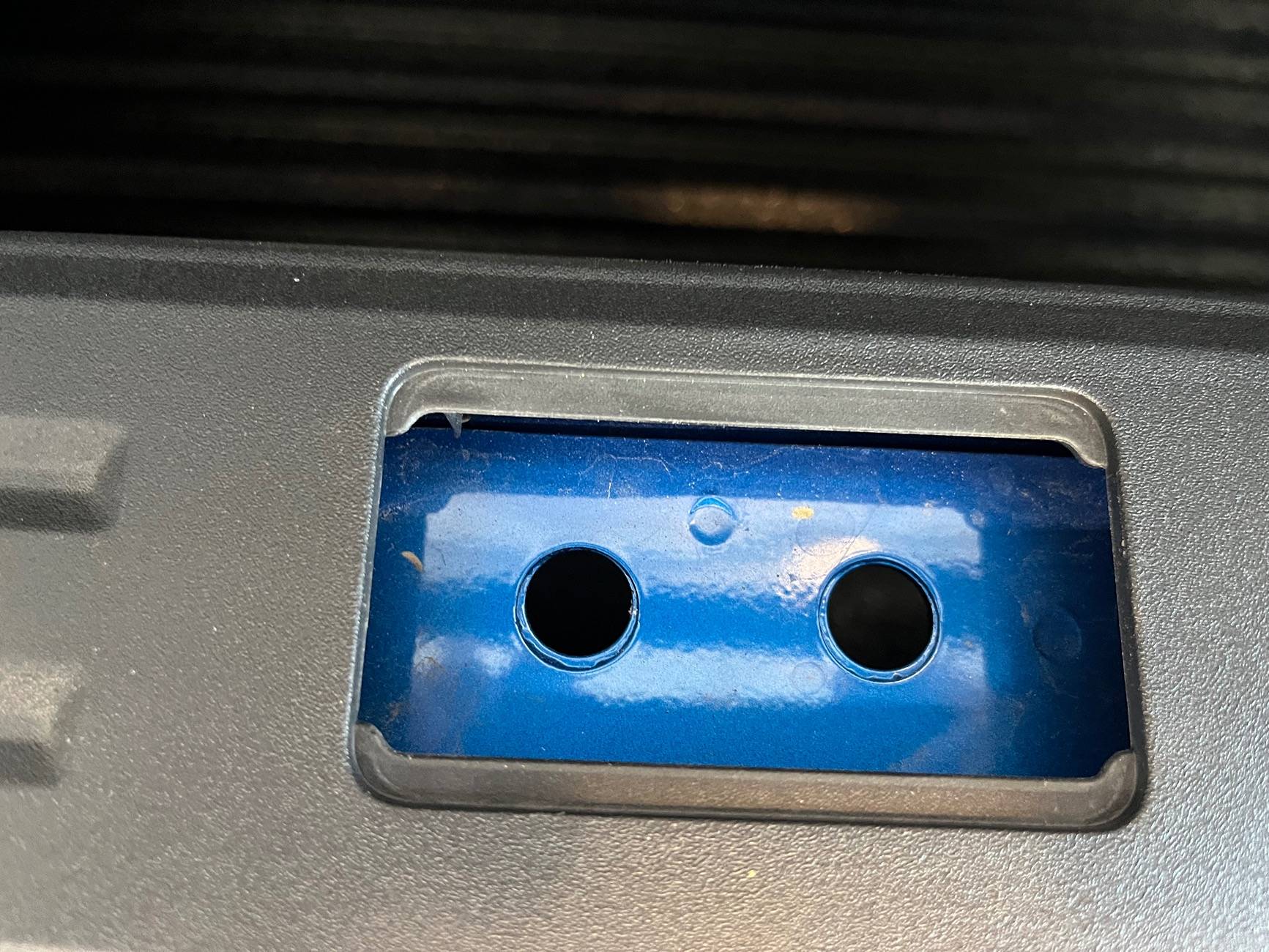

Made holes in the stake pocket covers
Ford Ranger Making use of the stake pockets IMG_4905
Hardware
Ford Ranger Making use of the stake pockets IMG_4907
Installed
Ford Ranger Making use of the stake pockets IMG_4908
Ford Ranger Making use of the stake pockets IMG_4909
Ford Ranger Making use of the stake pockets IMG_4910
Pics for reference:
U-bolts
Painted u-bolts
Hardware
Installed
Bet the Bullring would have cost you 10 times as much. :)
