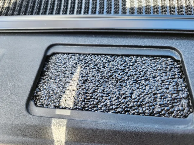

I have a roll up hard cover and carry lots of fishing gear in the box, which I don't want covered with dust or wet. I used hot water pipe insulation (assume pole noodle material would work also) to seal my stake boxes as the attached pic illustrates, then put the caps back on. Cut it a little larger than the hole and you can force it down inside. I did the same at the front corners of the box. However, not as seal tight as the stake boxes. Sealed the tail gate with the attached Keko seal kit (site attached). I still get some water in under the box rail if when washing I hit it directly. So, when washing I'll aim the spray downward in that area. Not perfect but is considerably better.

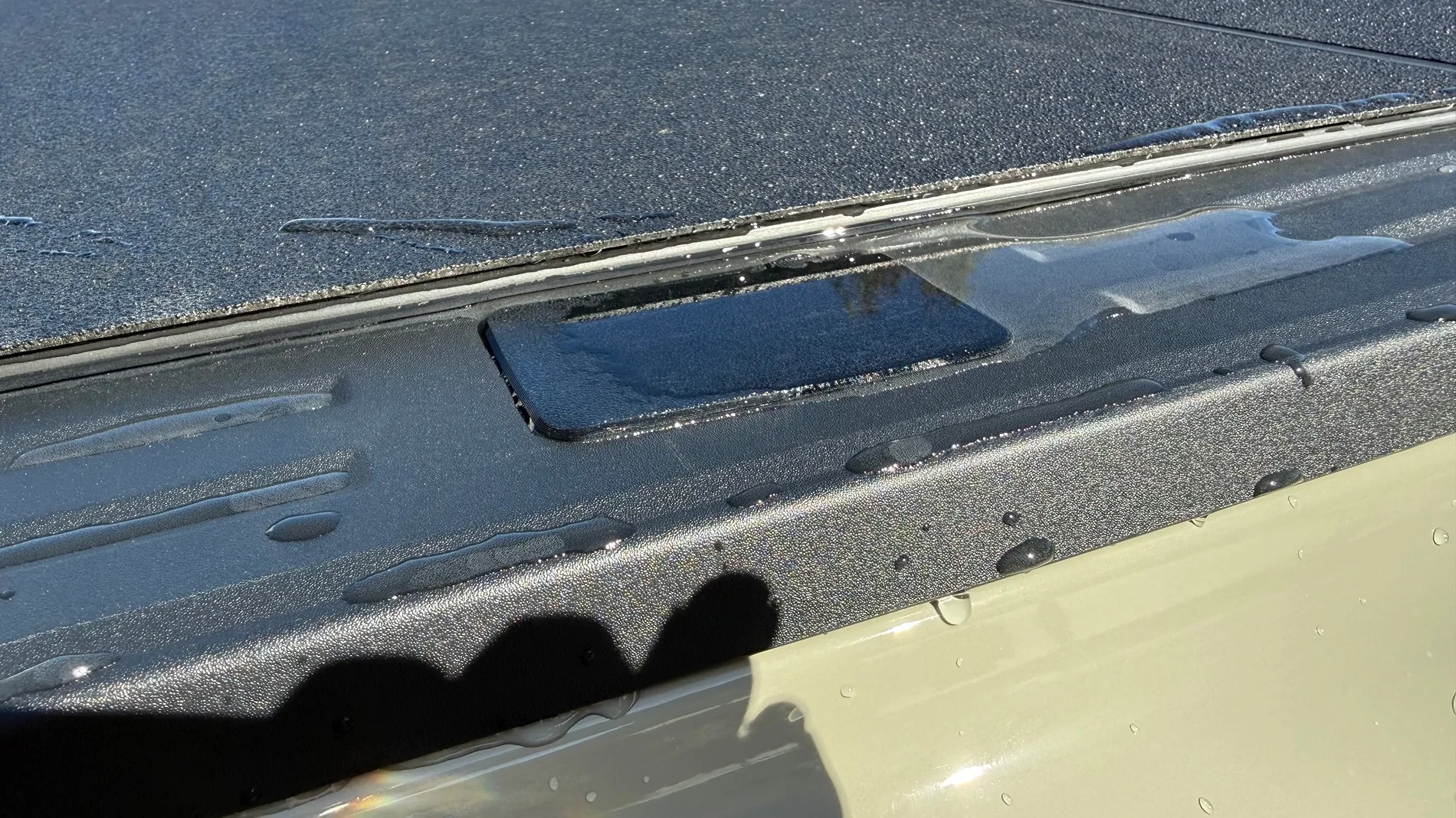

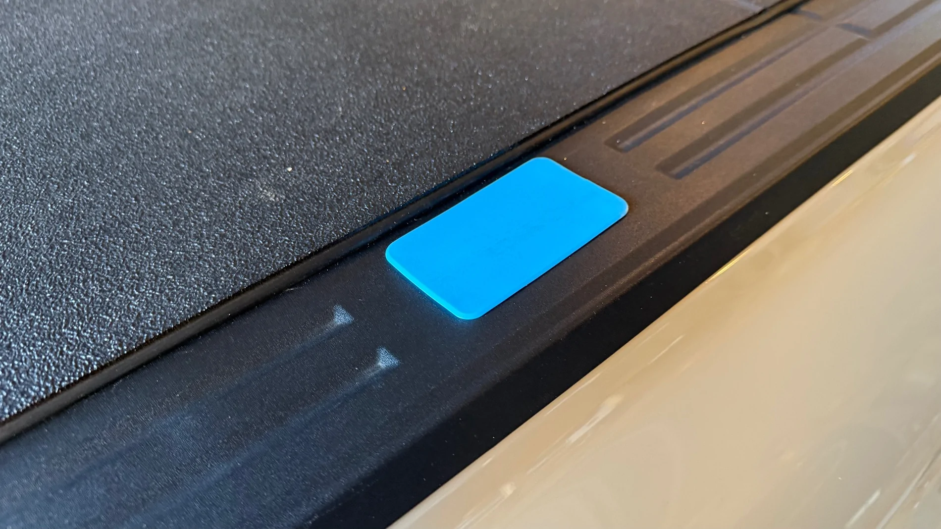

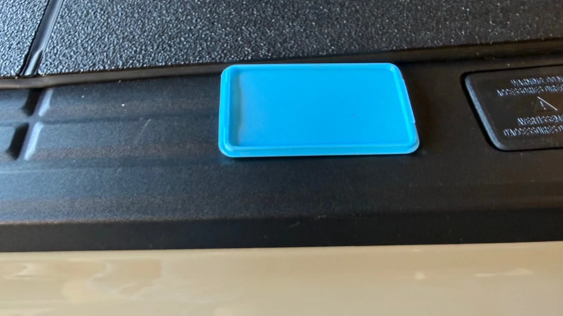

This worked and I was amazed at how easily water comes in the stock stake pockets without this cover.
the tailgate gap is also an issue
I didn’t see any water intrusion from the side.

@purdyd are you selling your 3d printed covers?
