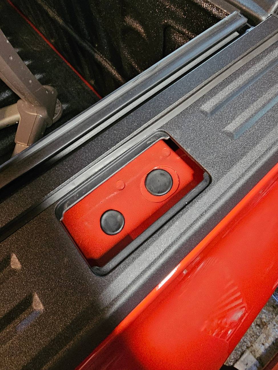

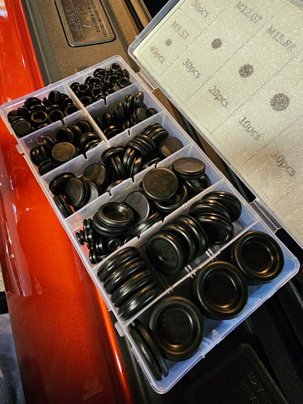

As of now, my current plan is this:
I have similar plugs to the OP and am going to plug all 12 of the exposed holes below the covers. From there, I'm going to use Duct Seal to seal the edges around each pocket, below the cover. Duct Seal is that dark grey, forever pliable play-do like stuff used to seal foundation holes for electrical, ducts, etc. Similar to rope caulk but designed to last indefinitely without drying out.
Will it be as good as others fixes here? Definitely not. But I don't need waterproof. I just don't want a bucket of water in my bed each rain 😅 My tonneau already leaks so just want to eliminate as much as I can.

Update: tried the stake pocket duct seal and unfortunately it wasn't good enough. Still had some leaks, though it did improve a bit. I'm assuming there is just too much little gaps and flex for it to work correctly.
I just can't believe nobody has made a viable product here. You think it'd be a no brainer. I'd pay 100 bucks for a set of 6!!
I'm thinking of just doing what some others have done and using black silicone caulk to seal the pocket cover in place. Not the prettiest but not sure what else to do here.

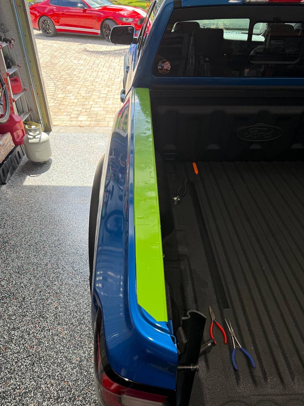

I was always thinking of using waterproof tape over the pockets. I've use this tape to repair car covers and they stayed fade free, and waterproof outside for over a year.
Here's a mock up not trimmed exactly nor attached since I don't have a tonneau cover yet.
Ford Ranger Stake Pocket Plugs pocket

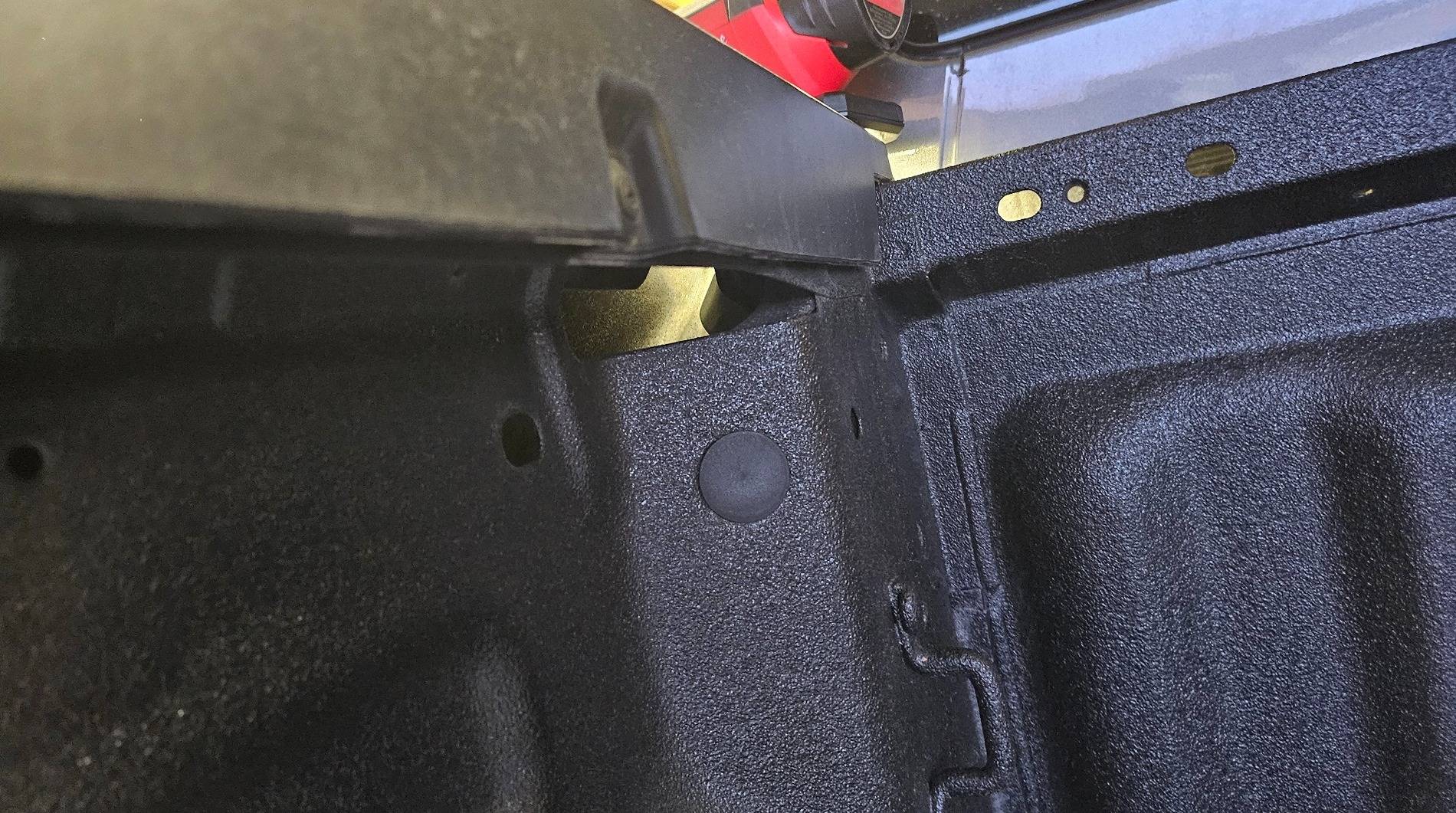

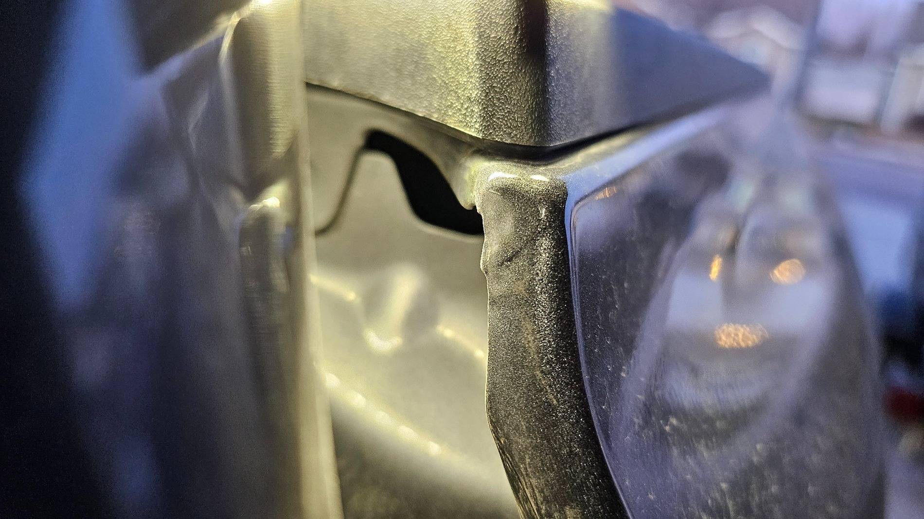

There are a number of problem areas contributing to the leaks. Stake pockets are major but won't make near enough difference alone. The 33 holes in each rail under the rail caps need sealed as well as all the other holes thru the bed, but are less important. The big holes in the front corner are a huge leak while driving, plus water blows in the open front end of the rail caps. One of the biggest leak solvers was running a rope caulk the length of the rail under the rail cap, to prevent any water that does get in from simply running over the edge into the bed. It took all these to seal it up so that in heavy rain or a car wash I rarely see a few drops inside.
There's a number of threads with pics (including mine) that detail the scope of the problem. Good job Ford....
