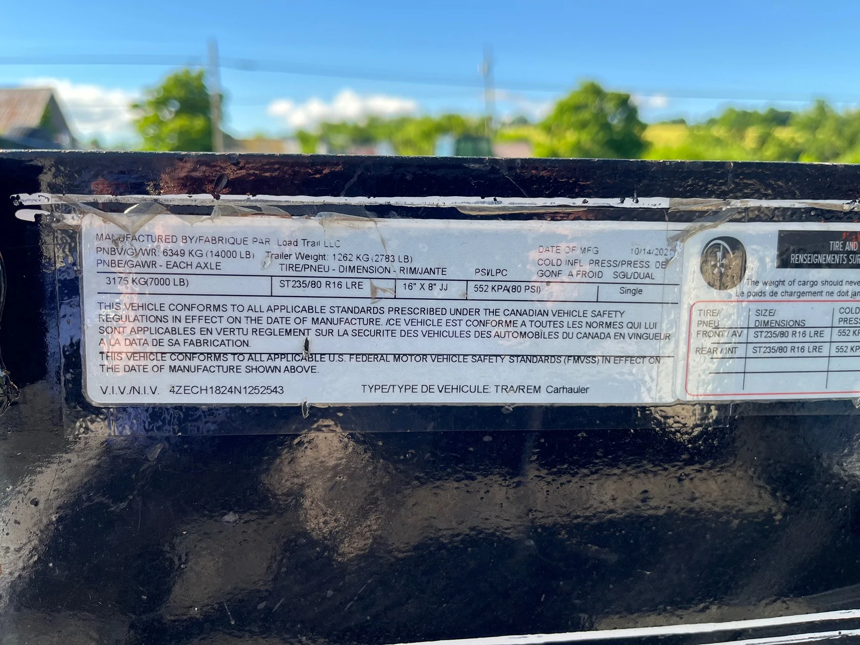

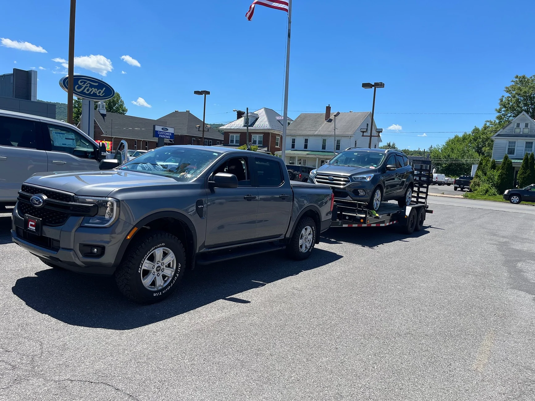

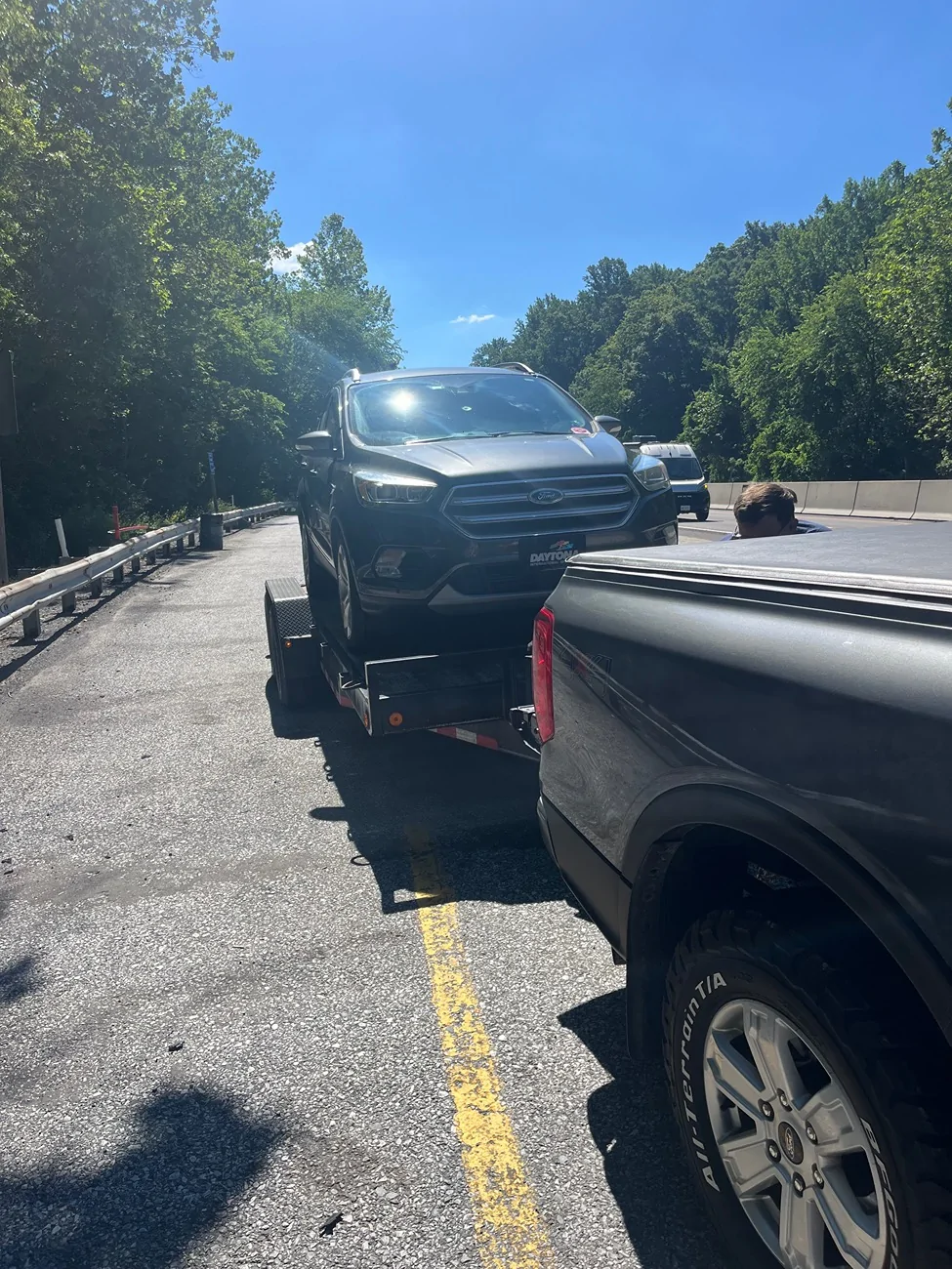

On Friday, my wife’s 2017 broke down on the Pa Turnpike. We rented a car, and drove the 120 miles home. The next morning, I rented a trailer, and took the trusty Ranger to retrieve the disabled scapē. When we headed out, I remember thinking to myself, that the trailer felt heavy. Well, when we arrived and loaded the car, I noticed that the weight of said trailer was close to 7000lbs. 🤦‍♂️
So, what do I do? I strapped down the scapē and away we went. Risky? Yes. Reckless? No. Much to my surprise, the Ranger Danger towed said overweight trailer 120 miles in 95 degrees with ease. She even made 12.9 mpg running 94.
Not the way I planned it, but I passed a trooper, and he didn’t even blink.

I seriously doubt that empty 2 axle car hauler weighs 7,000 lbs. Were you looking at the GVWR sticker? Most 2 axle car haulers weigh between 1,500 and 3,000, which would put the GVW with a Ford Escape loaded on at less than 7,000.
3,500 lb axles are common so 2 X 3,500 = 7,000 GVWR which means the weight of the trailer and the load together cannot exceed 7,000 lbs.

You guys are correct. I stopped and looked at the sticker on the trailer. 2700 lbs

What you noticed was it's GVWR load limit of 7,000 lbs, which includes whatever is loaded on top of it. That's not the trailer weight.
The trailer most likely weighs between 1500 and 2000 lb.
