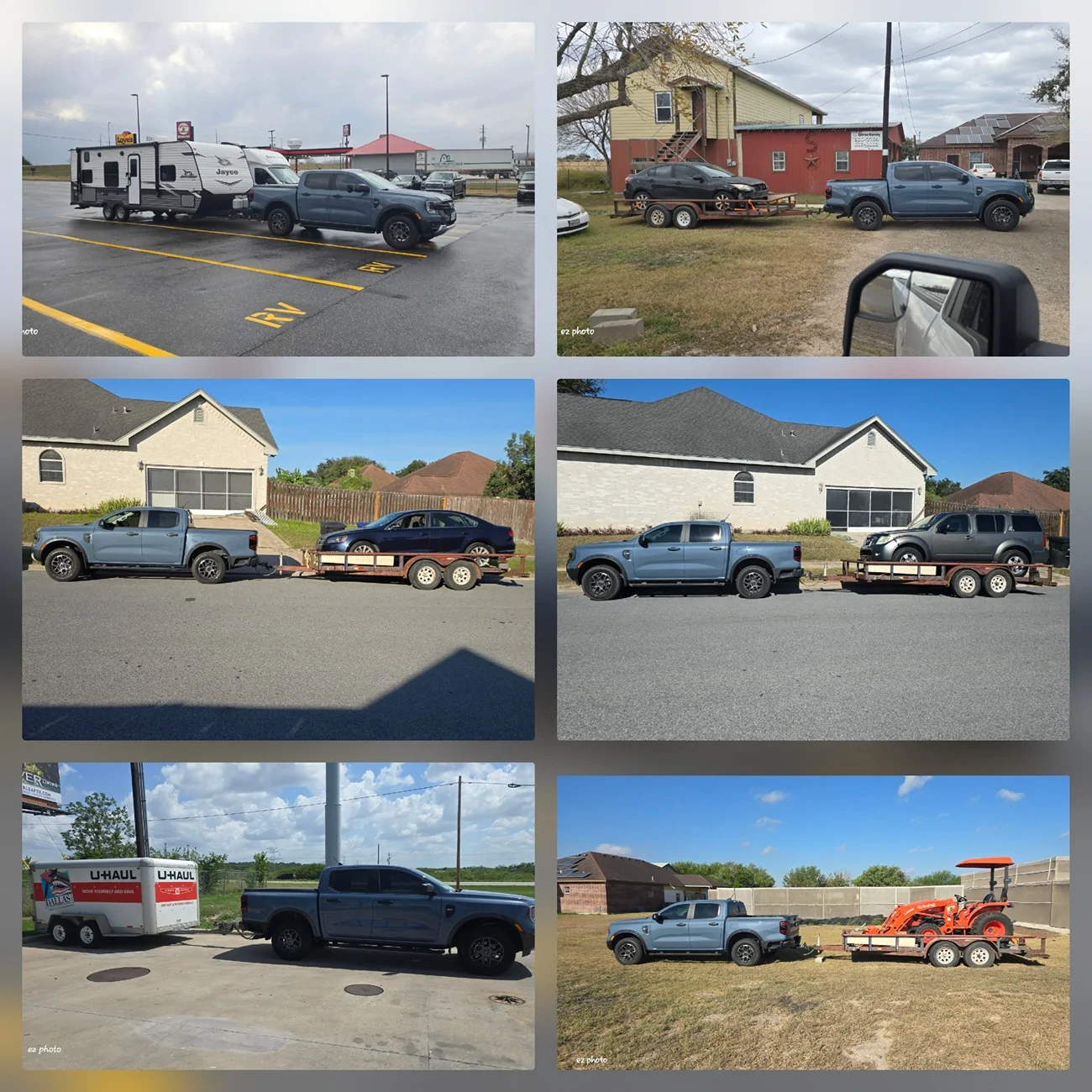

You can tow like this all day long. Good set of trailer brakes. You were well within your limits. I do a lot of towing and here is my setup.
Road active suspension
GEN-Y GLYDER HITCH
And i always use 91 or higher octane.
The road active helps a lot with squat.
The GEN-Y HITCH, Game Changer!!! You will never tow smoother. Lets the trailer and the ranger stay seperated not moving each other around.
91 or 92? Octane recommended by the owners manual for towing. This ranger is a keeper so worth it for me.
Heaviest tow is the pathfinder. 2k trailer and a 4800lb pathfinder. Even the kubota was only 6k total weight. I use a make shift scale on the ranger too. I get a lot of s$&@ for it, but it makes for a really good on the spot scale.
Tow safe, and
Keep the rubber side down.
