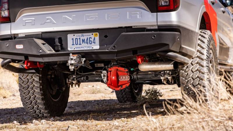

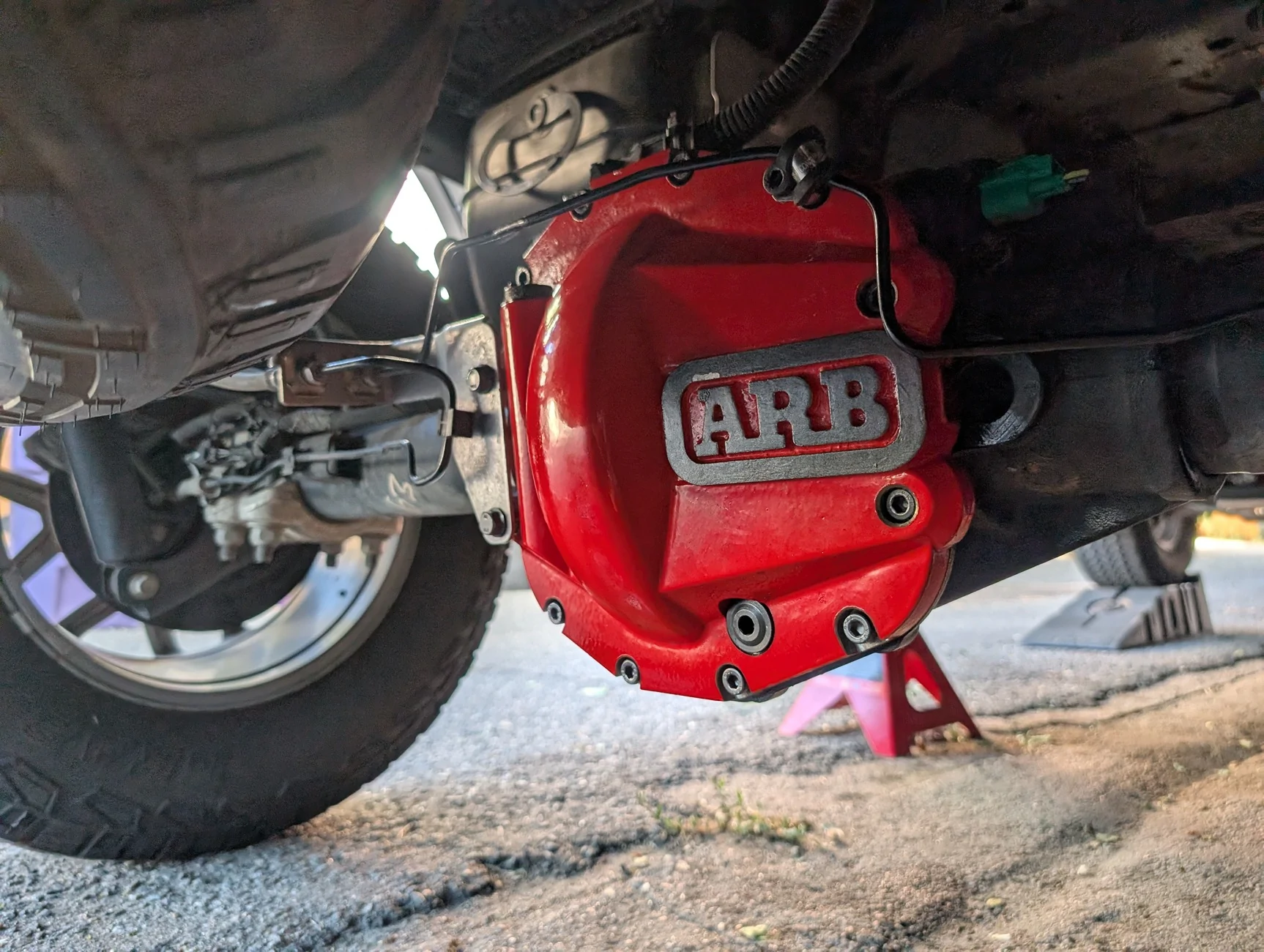

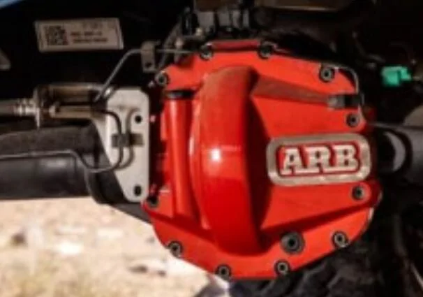

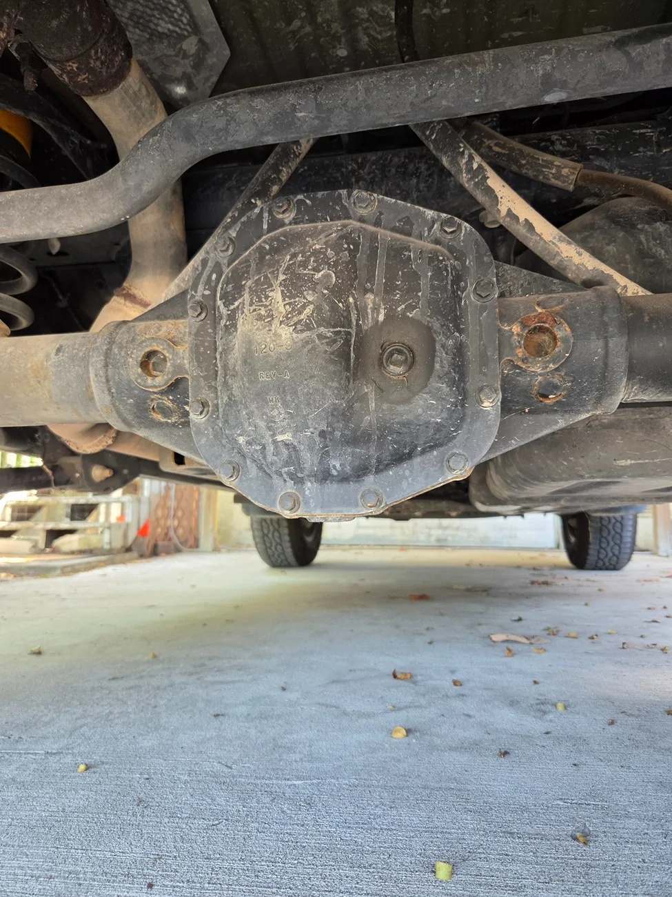

I'll have to do a separate write-up on this later but ARB covers fit with a little modification.
I reused the stock gasket but basically replaced all the hardware. Probably not worth the hassle if you're buying new but this was a Marketplace steal from a while back.
Also change your rear diff fluid. I've never seen rear diff fluid as black as mine came out after 10K miles.
Ford Ranger Aftermarket rear diff cover Non raptor PXL_20260607_004006018

The wife wants the arb for her wrangler, which has the same rear as my ranger. I may just do the arb also.

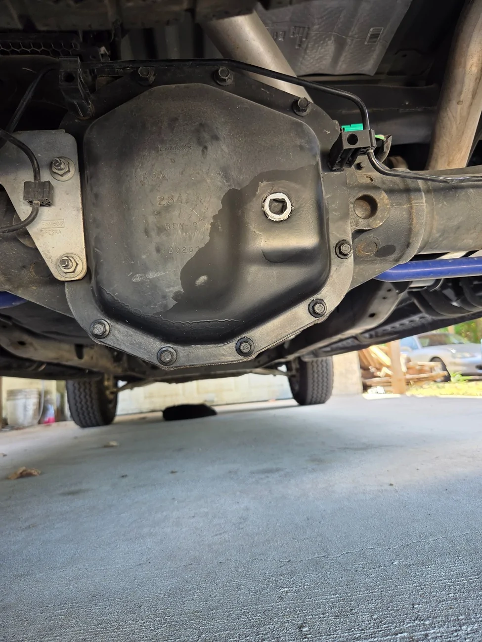

2019 wrangler m220

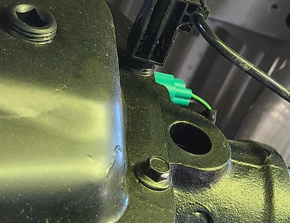

Ford Ranger Aftermarket rear diff cover Non raptor 20260813_143144
2024 ranger m220
Ford Ranger Aftermarket rear diff cover Non raptor 20260813_143129
