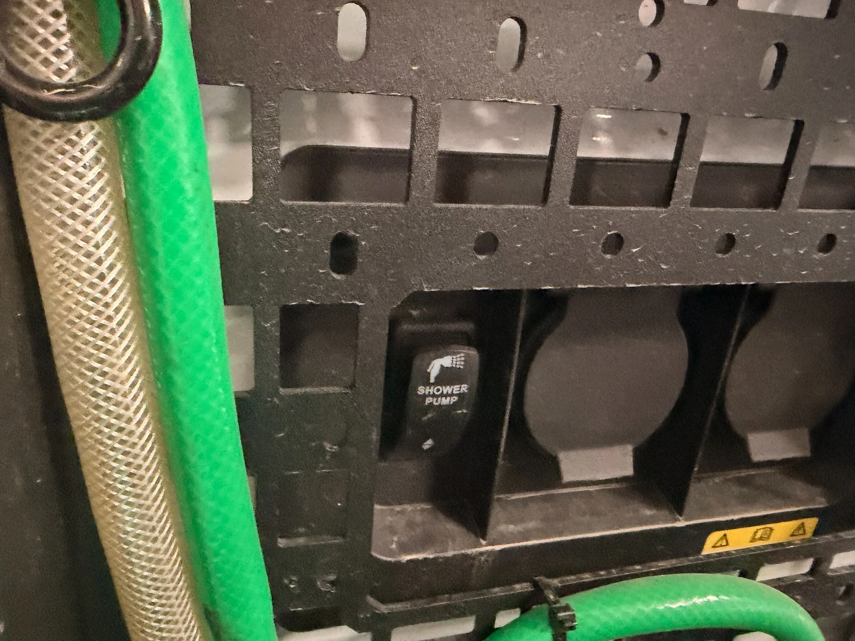

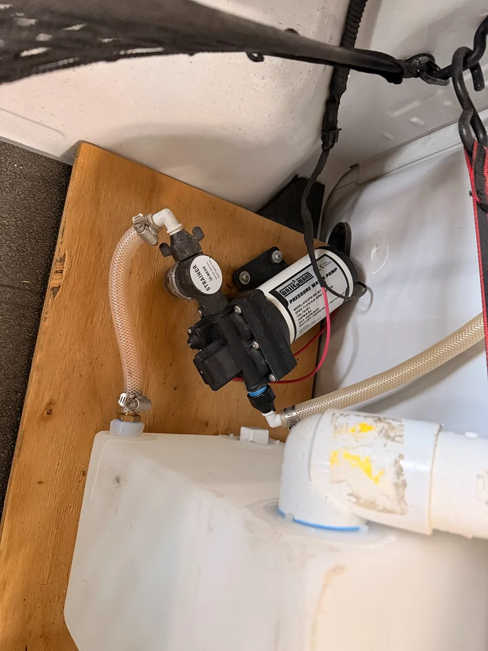

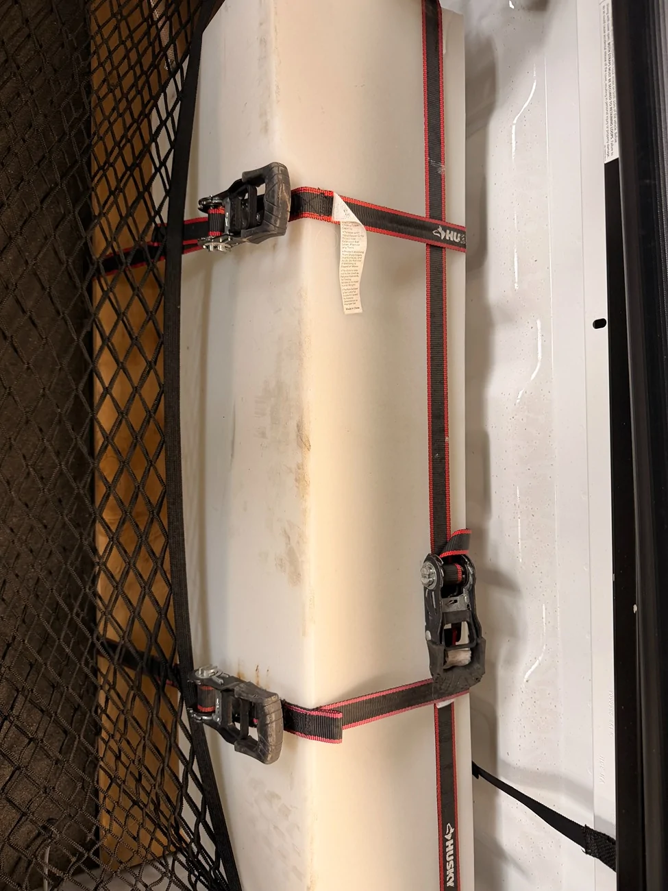

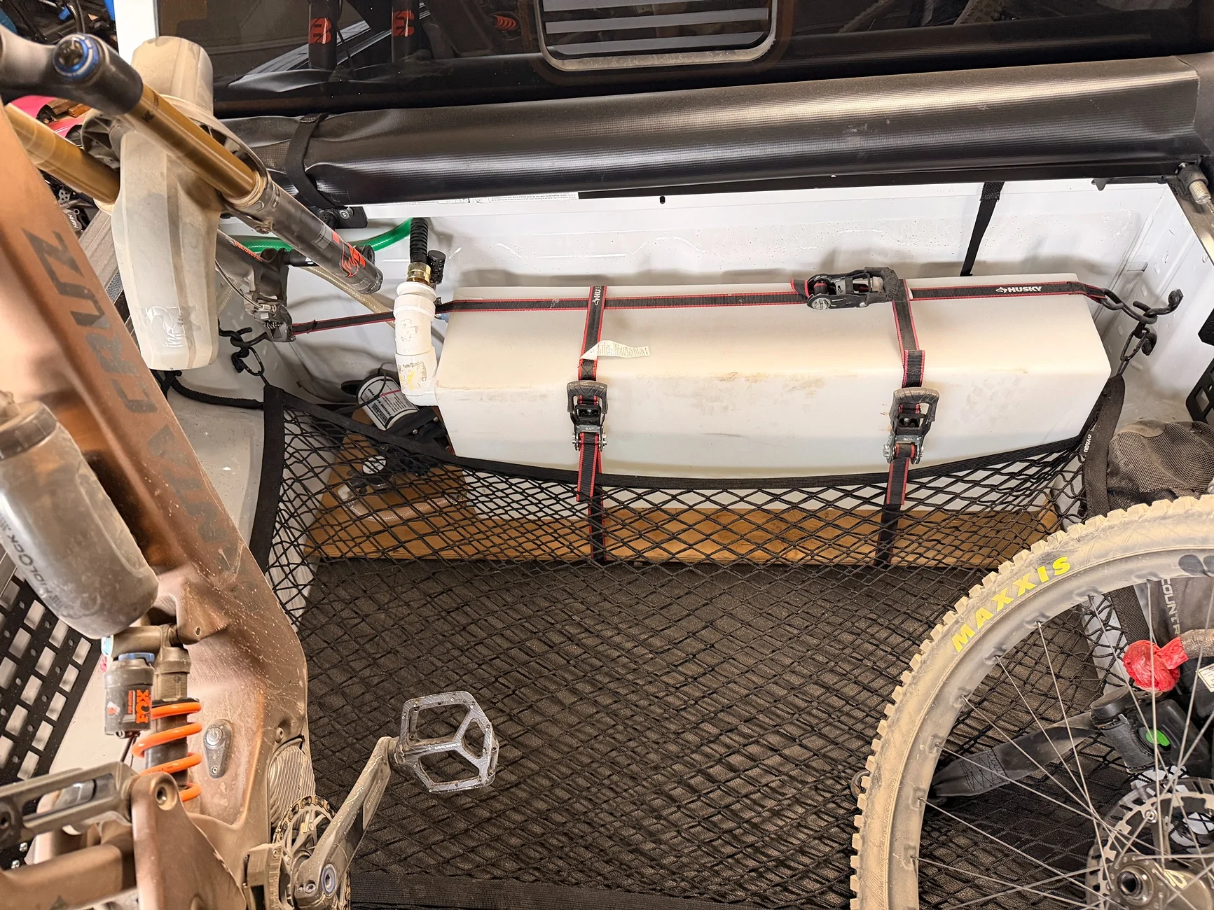

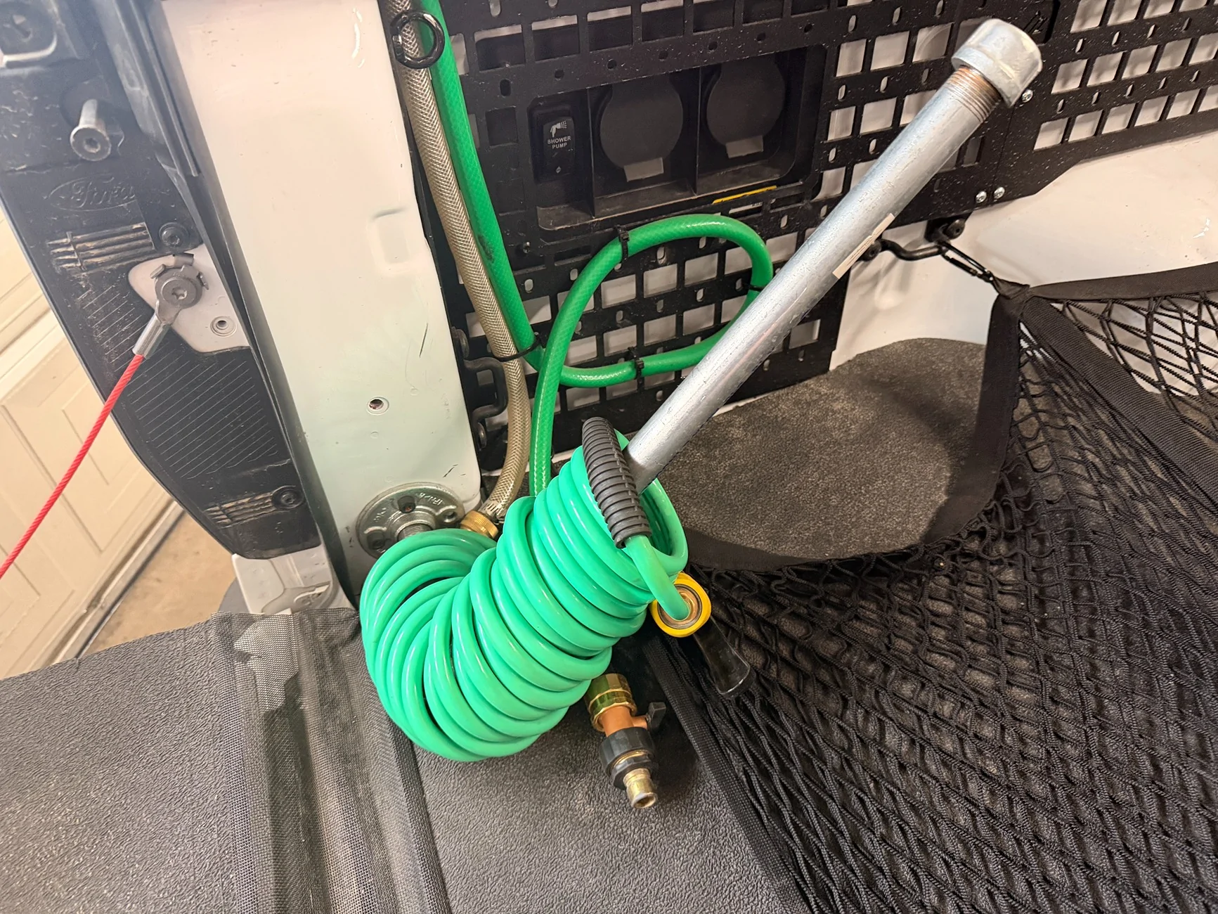

I built a portable 15 gallon shower in the front of the bed to hose off my dogs every time I take them to the lake or anywhere else muddy.

I bought the tank, pump, hoses, etc. Then I ran the power from Aux 2 (I think if I remember correctly) from the aux wire near the hitch. Wired to a switch in the bed to turn on and off from there.
