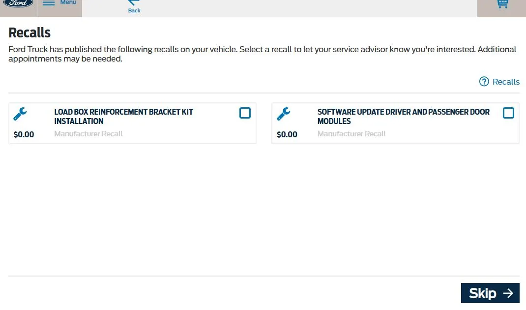

Want to see something trippy? This is going to stir the pot lol.
Ford Ranger Bed Reinforcement Question Screenshot 2024-09-17 125722
So when I was getting warranty work done on the AC, I mentioned I'd ordered the brackets and inquired having them install and asked for a quote. I was supposed to bring back when I got my brackets and Service told me they would see if I could get them installed at no cost but they weren't sure since bulletin does have the Ford brand topper provision as a requirement. As we can all see, there is a CSP and it's provisioned, but as with any warranty work, it's up to the dealership how or if it's done.
I believe that's the only reason it shows as a recall on the Service website. If I type in my VIN on the recall check site or look at my Ford account, there is no recall for the load box kit.

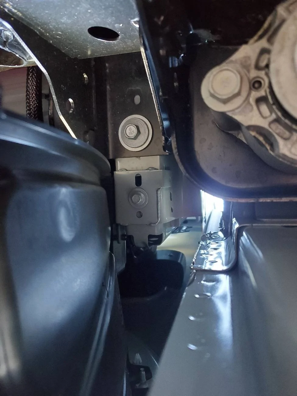

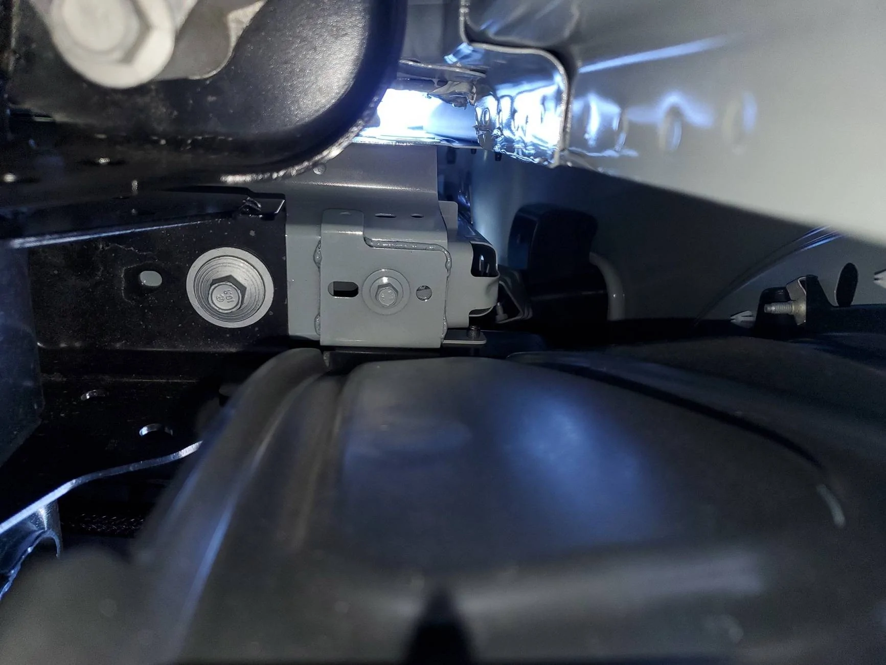

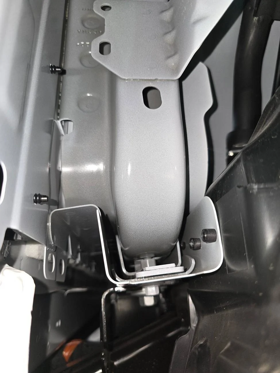

I have a job 2 build. Pics from underneath. Not exactly sure what I'm looking at, but I do not think I see the 50/50 Ford L bracket reinforcement.
Any feedback? Any from those who have theirs installed?

That’s what mine looks like as well. I’m not going to buy the J brackets; I think Ford has already addressed the issue on my truck

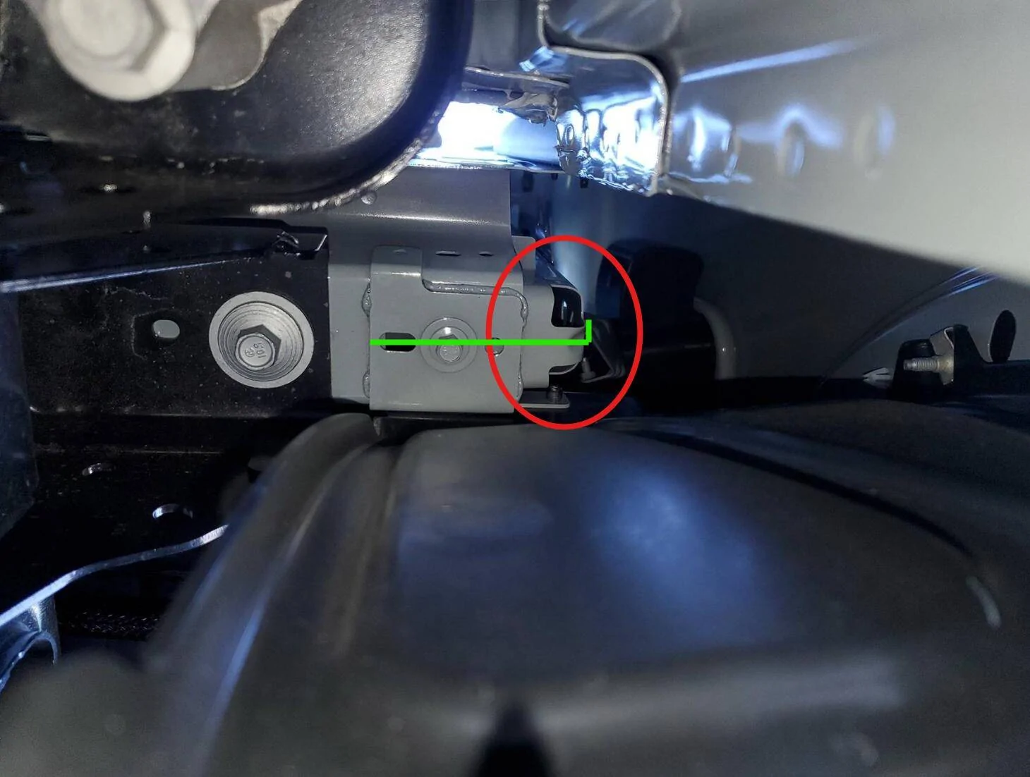

Disclaimer, I have not installed the J brace...
This looks the same to me as the Job 1 beds.
The J brace stiffens the corner circled in red.
It follows along the green line, then continues up (hard to show in 2D).

I'm not so sure it has been addressed. When I look at the J Brace and then the above pictures, the new brace covers both bolts. I'm going the better not to be sorry and intall a J brace. Have topper to be installed next week.

there is no difference in job 2 trucks with the j-brace issue. has already been discussed in a different thread

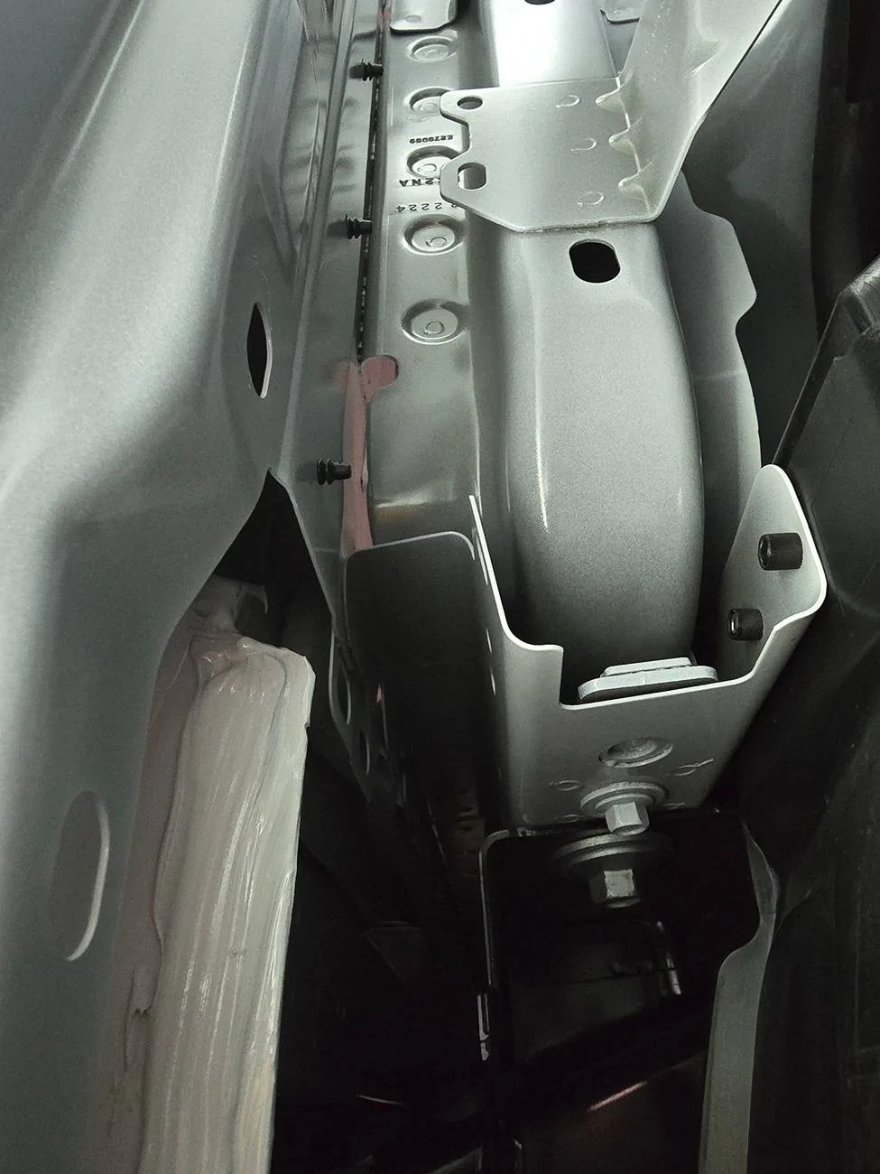

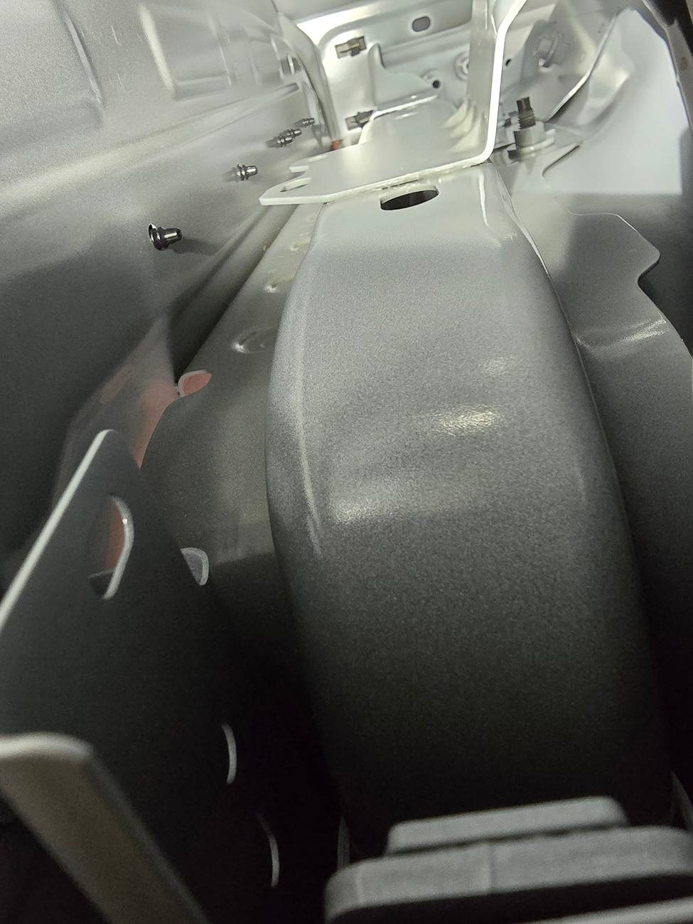

Just received my Ranger Lariat and was planning on ordering the J Brace. This area appears very different on my truck, to the point the existing Ford J Brace wouldn't fit? I've asked Ford and my dealer for information but so far, nothing.. Sorry for the poor photos..
