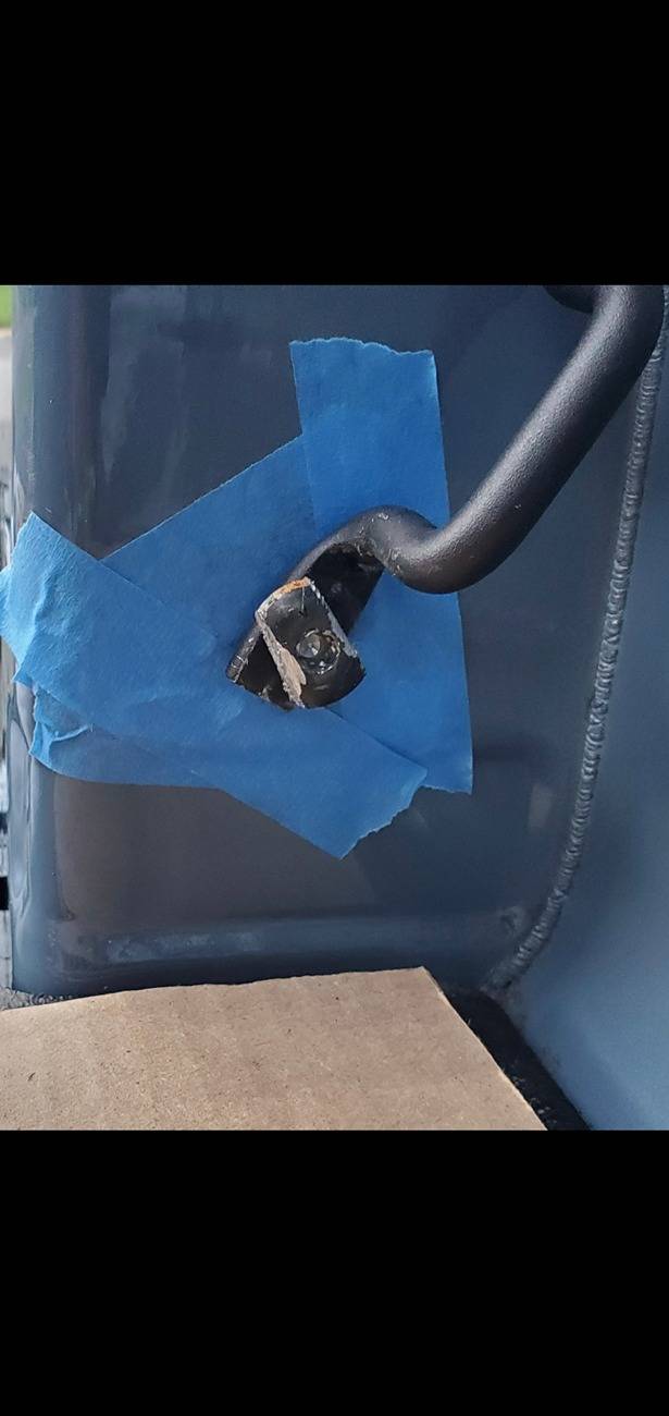

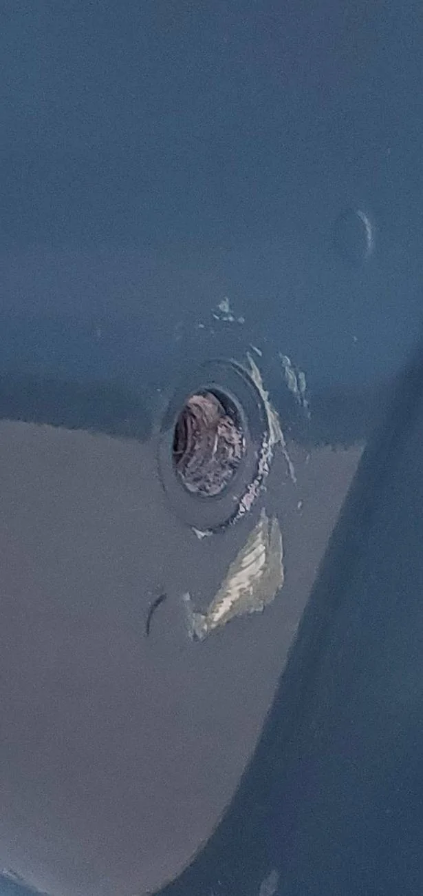

Any chance you could dumb that down for me lol. I’m not sure what you mean by “rectangular head”. I appreciate it!
Ranger/Hobb is correct. This is what I did. Also, look at all the red loctite in the threads. Crazy ?
Ford Ranger Bed Tie Down Hook Bolts! Screenshot_20240907-194454_Gallery
Ford Ranger Bed Tie Down Hook Bolts! Screenshot_20240907-194616_Gallery

So, I was trying to remove the tie down hook bolts and bolt head snapped off. Looks like they used blue lock tight. Feels like red lock tight.
Consider drilling it out and installing a stainless riv nut.
