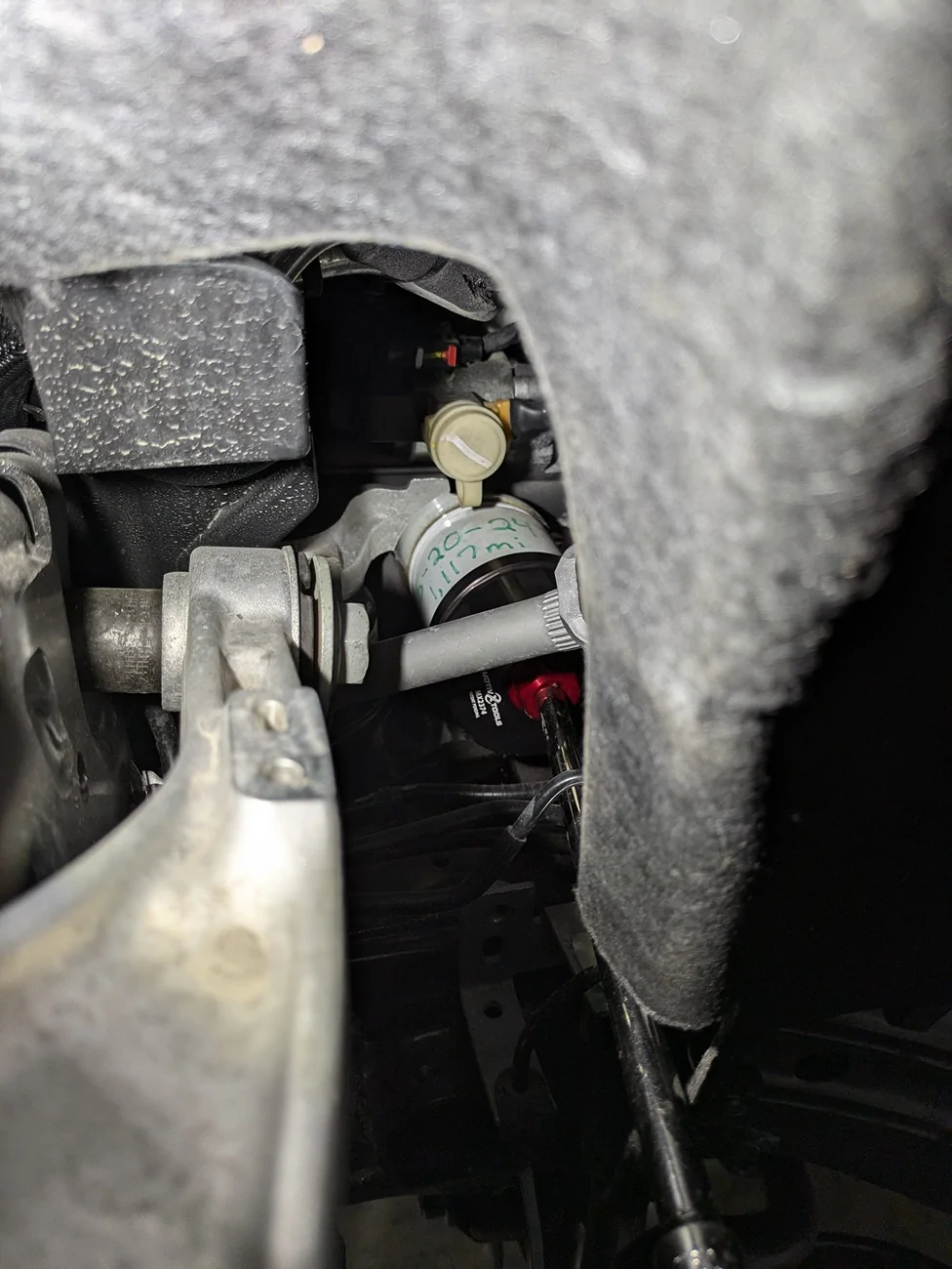

So the filter looks to be in the same spot as the original 2.3 from the 24 ranger. That means it can also be done with no issue from the bottom. Thats good to know

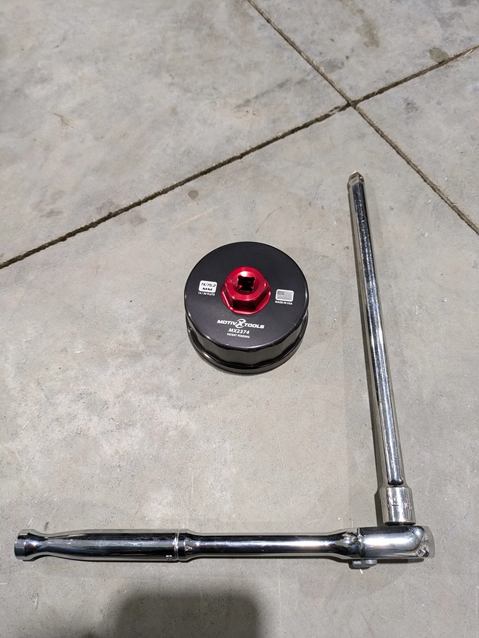

I maybe wrong but i think the taller filter may cause problems when taking it off.
I would use a 1/2" Craftsman thick ratchet it could be a problem.
I would say thinner tools to remove.
I also think it would be harder to take filter of from the bottom.
Just use a step when going from top.

The FL500s taller by like an inch. If you think that’s a big deal then that’s on you cause it’s not. The manual says 5.5qts. That’s what i add or a splash more and I’m always at the top of the hash marks. And there is not a problem taking it off. Plenty of room for filter wrenches or a ratcheting wrench if you have that style.

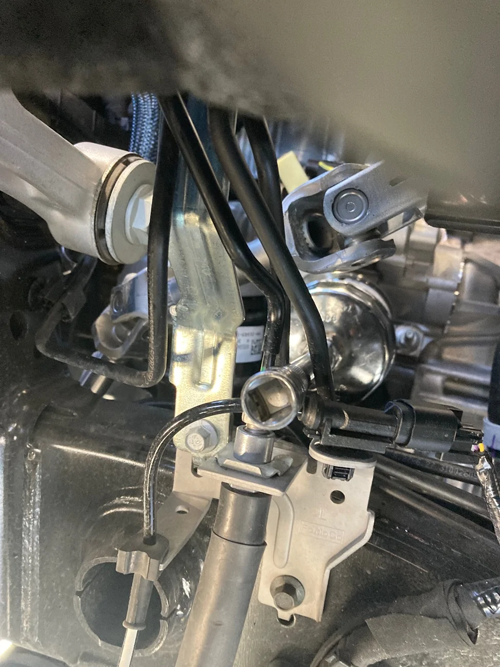

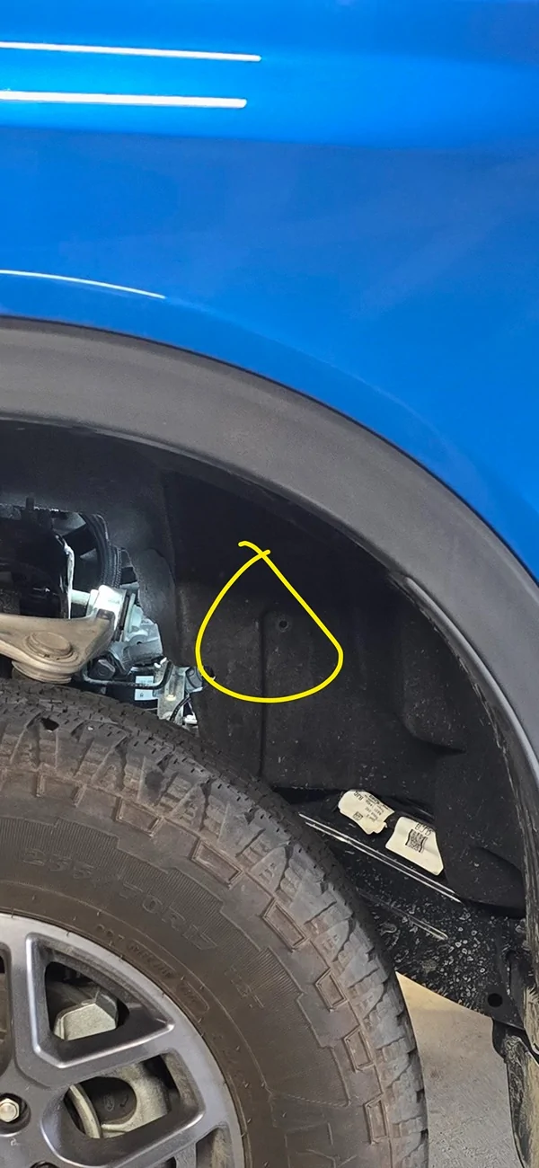

I remove the inner wheel liner.

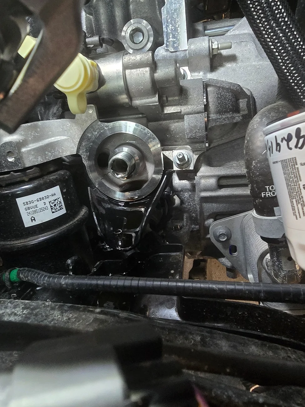

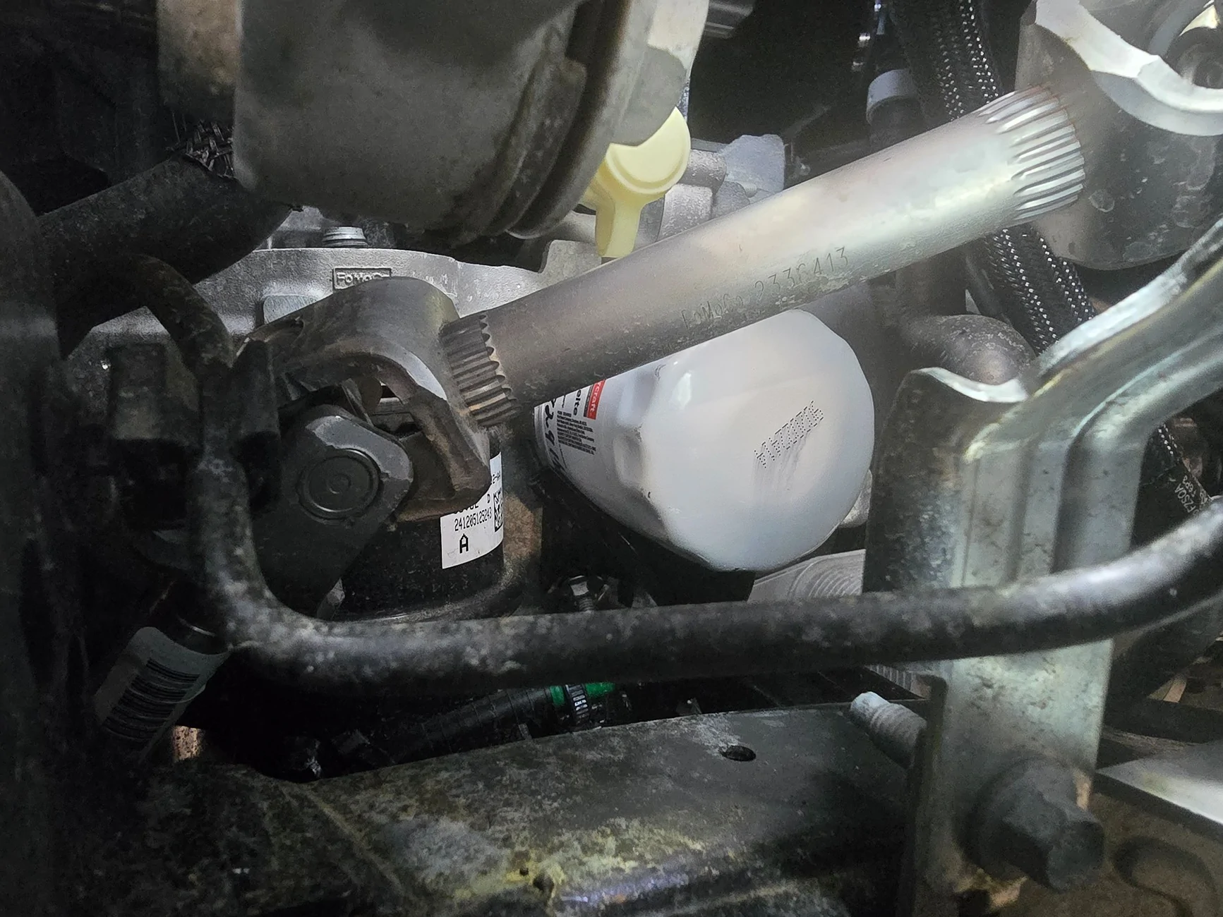

I found it easiest to change the 2025 2.3 filter from the top and it wasn't even close. Just get a stool, reeeeeeach down in there, and twist it off. Ain't nobody got time to be removing fender liners when it's so simple from the top down

When I first got my 25 2.3 and was doing my first oil change months ago, I looked at the fender liner method and immediately said, "nope, not doing that." Was a lot quicker and more convenient to just get a foot stool and reach down in there and get it out from the top of the engine bay. Super easy.

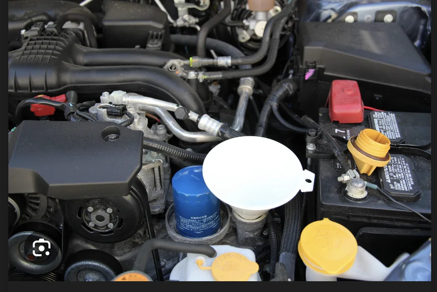

Note to first-timers: make sure you put a catch pan under Ford’s filter-oil drain path. First vehicle I’ve ever seen that does this. I also loosened the filter and let as much as possible drain out before removing it. Finally, don’t forget to clean up the drain path when you’re done. Kind of a PITA!
Subaru is the king of friendly oil changes. Ford could learn a thing or two from them.
