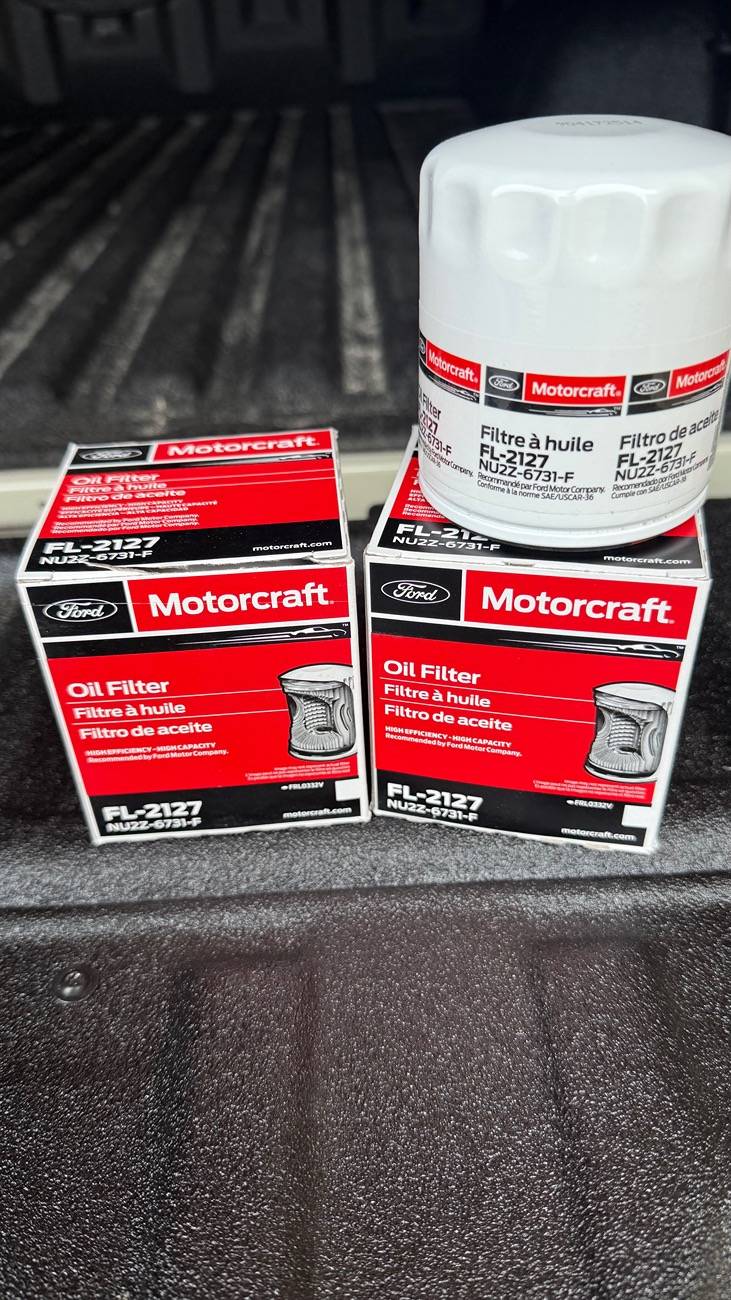

Agree with the FL2127 and 6 Qt of 5w-30 oil for the '25 2.3L engine, as I just finished the first oil change.
DO NOT TRUST most online auto parts places as they are still referencing the old engine filter. I know, as my Purolator Boss PBL10241 doesn't come close to fitting, yet that's what AAP shows as the correct filter.

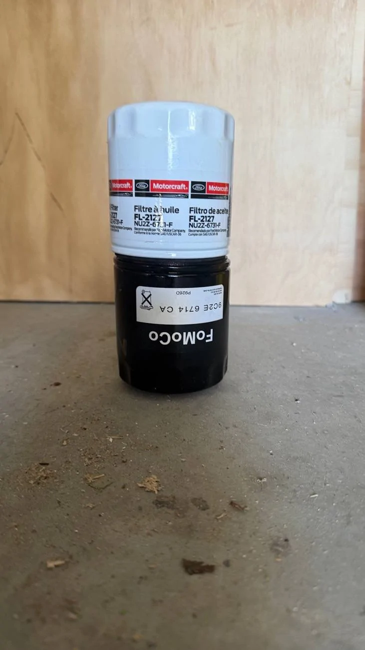

I took the factory filter down to local Ford dealer and we verified 2127 is a cross reference match to factory black filter, the 2025 Ranger parts guide, and also to the 2024 Mustang 2.3L filter. Worked like a charm.
Also, I found the filter easiest access from the top, leaning over fender. There is a plastic drain guide under the filter to catch oil as you unscrew it so make sure your drain pan is set correctly. Note: do what is easiest for you.

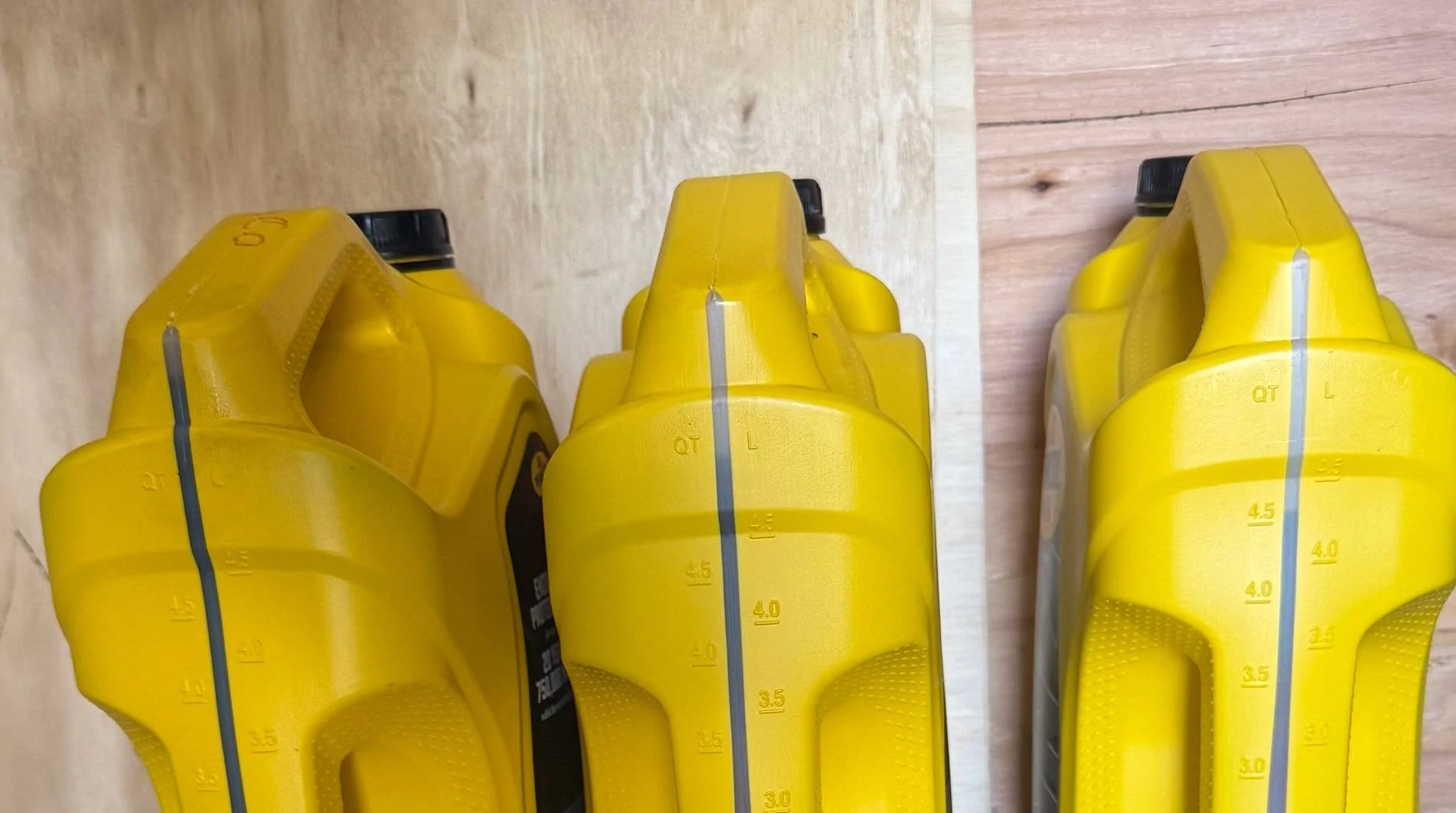

I just finished the first oil change and about 5..5 quarts came out so im going with the 5.6 thats in the manual as the correct amount
https://www.ranger6g.com/forum/threads/2025-2-3l-fx4-oil-change.20682/
look at this picture below in poured the oil back into the container on the left.
the middle container is new in opened and the one on the right has the extra 0.5 qts missing
i figure it is easy to add 1/2 a quart if I am wrong

now that the filter is white it will be a lot easier to see and change.
and the factory fomoco filter is the same size as motorcraft fl-2127 so you can use the same filter wrench

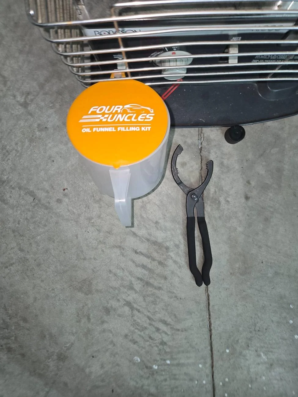

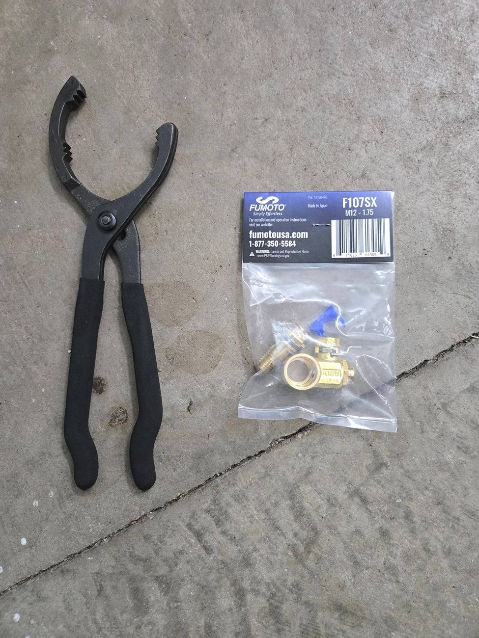

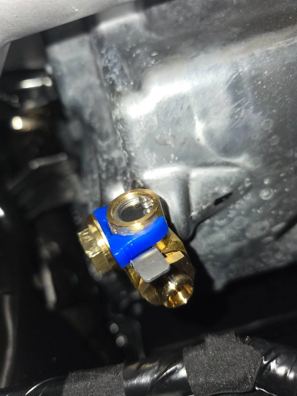

Engine Oil+Filter change done yesterday @ 1K miles, 5.7 qts, Penzoil ultra platinum, full synthetic, confirmed 22MM oil filter threads, removed from underneath as planned, easy removal with tool and by hand once is loose. Installed Fumoto drain valve. Planning for 5K miles interval going forward. 4 uncles funnel is awesome, comes with all automotive brand adapters. Hood struts is a must upgrade. Also noticed that the valve cover is not plastic, should last longer.

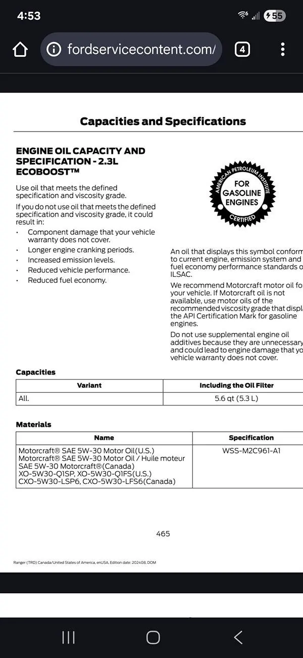

Not that it matters too much but the pdf version of the 2025 model at least shows 5.6 qts. But the html online version shows 6 qts. I'm probably a little overfilled so I think I'll back it down to 5.6 for the next one. Gotta love the clarity lol

I had it in the garage, made sure it was leveled, poured 5 qts and ran the engine for a few minutes, let it sit overnight, took my time adding tye next day and it took the .7 without being overfilled, as a matter of fact was below by smidget from the full mark. I think that it also depends on how long to wait for it to drain completely, I kept closing the valve and every time I opened it again, oil will come out. I checked various sites and they all call for 5.7 qts, as long as the level is within the range of the cross marks on the dipstick, it's all good and safe to operate.
