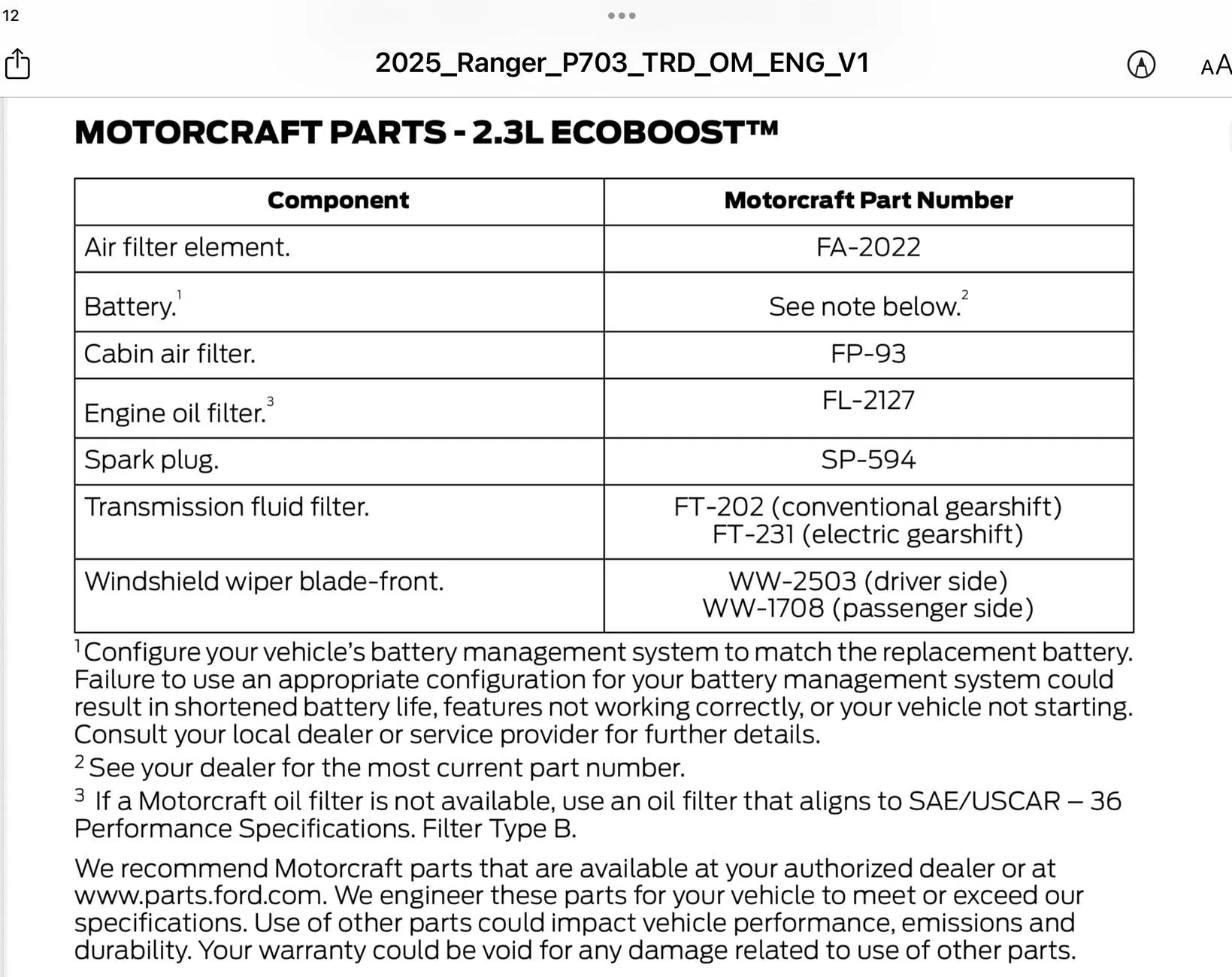

the fl-2127 is I believe a 74mm 14 flute filter but I thought I read that the black factory filter is a different diameter?
or is that incorrect?
And it appears the manual is correct in the version I just downloaded.
well then they finally updated it as it wasn’t last month. Regardless it’s a M22-1.5 thread.
the filters that come factory are usually a different size for some odd reason at least on most of my fords. The one that came off seemed same diameter as the McGard Plus I had to put on as it was all i could get in a pinch having purchased the wrong filter initially with the incorrect manual PN. But i think the mcGard one was a tad taller. And im glad they updated the manual. Should limit future confusion
