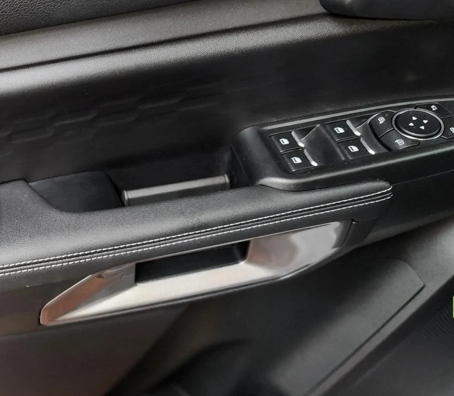

Hey guys. I had read before of the previous 5 Gen that some companies made a very easy to install window module kit that allowed you to auto open/close all 4 windows from the driver's seat, and also allowed you to automatically open and close the windows using the key fob.
Does anyone know if this exists for our 6Gs? Would absolutely love this!
Here's an example of one of the Australian 5G kits: https://tracelectronics.com.au/shop/auto-window-module-suits-ford-ranger-px2-px3/
I could swear all 4 windows on my 2025 XLT are one touch but I'll check tomorrow. In this pic the switches all look the same. I tried the key fob trick a while back and couldn't get it to work, I might have to change a setting in the touchscreen menu or Forscan? I know on my TDI I was able to enable it with OBDeleven. Funny thing though once I enabled it I never used it.

There are no door modules for the rear like the fronts. So there's no one touch on the rear. Depending on the model you may or may not have global windows that allow 4 window control with the key fob. There are no one touch modules that work with this configuration as the previous generation had no door modules at all and could be made to with with the aftermarket modules.
