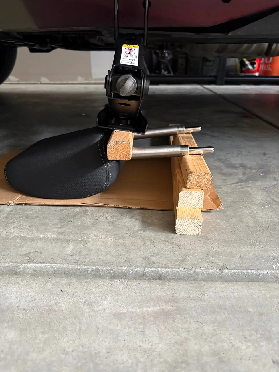

Using the vehicle jack, a couple of 1/2” x 6” pipe nipples and some scrap wood works also.

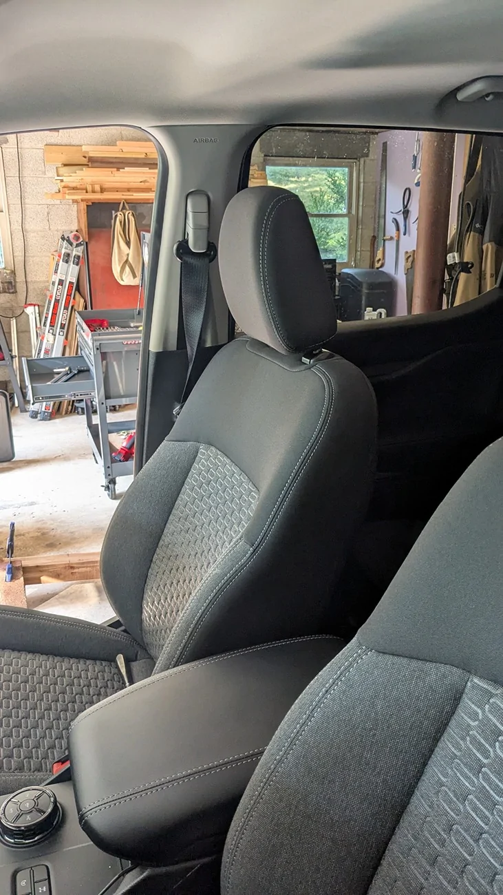

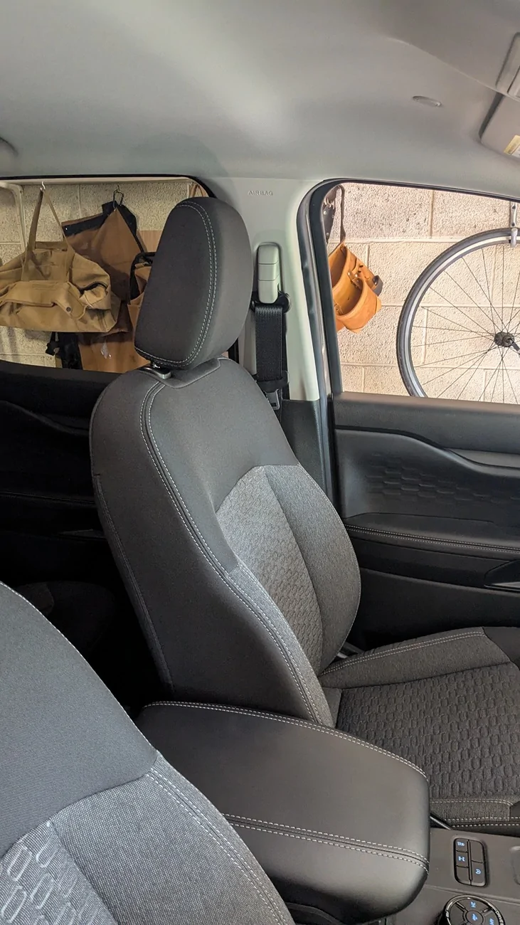

Might not look super different but the 10 degree difference feels so much better.

Do you have some before and after pictures?

Forgot to take befores, sorry... but if you compare my after photo to your truck you will see the difference! The angle visually looked crazy before even

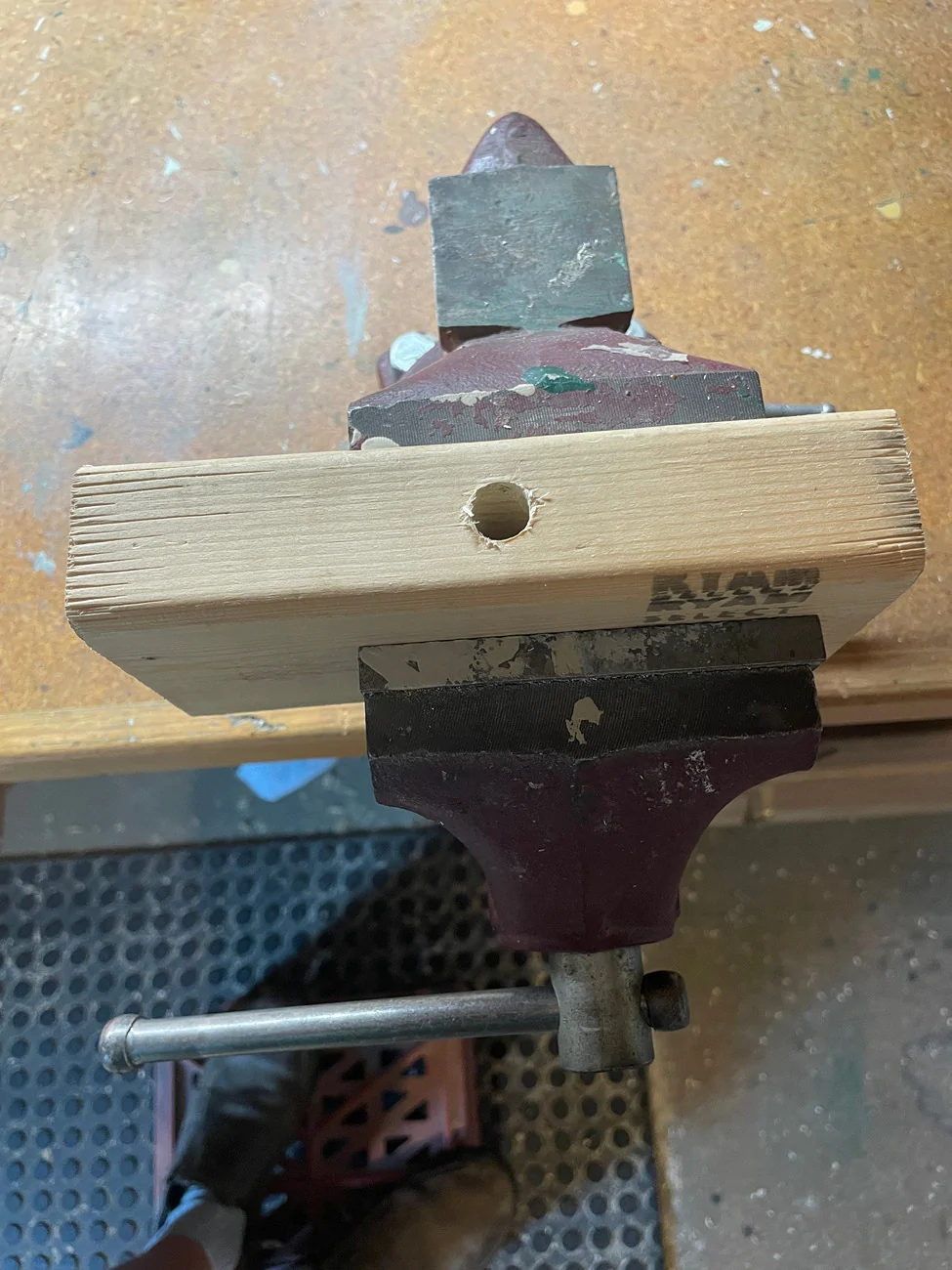

Made a simple jig for the vice (1/2" hole in the 2x4). My headrests are prefect angle now.
Dude, freaking genius! Thanks for sharing!
