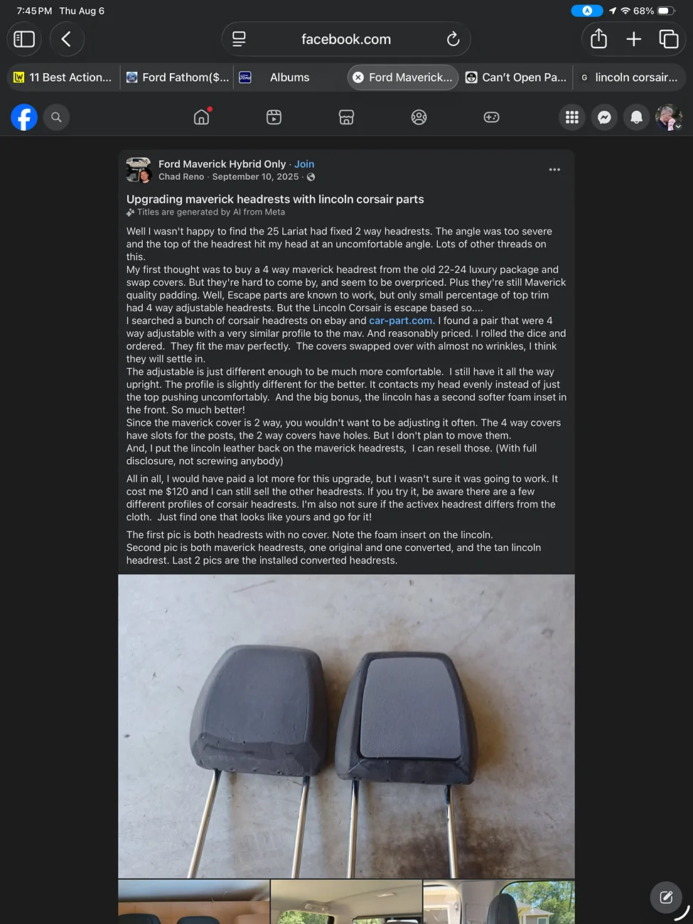

The headrests were fixed and didn't tilt on my '23 Maverick XLT.
so it is my understanding that certain trims of the maverick will tilt.
also i saw this post. where a Lincoln headrest was used on a maverick.
Ford Ranger Maverick Headrests to Solve The Ranger's "Tilt Too Far Forward" Problem IMG_0666

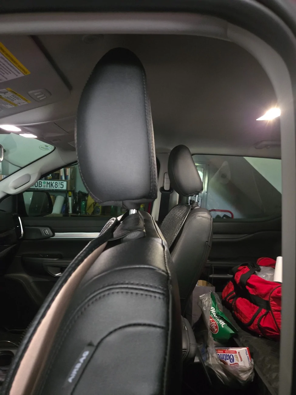

I'd love to see pictures after @MK8.5 Golf R bends the posts of his Ranger's headrests. I was fairly certain I would screw that up.

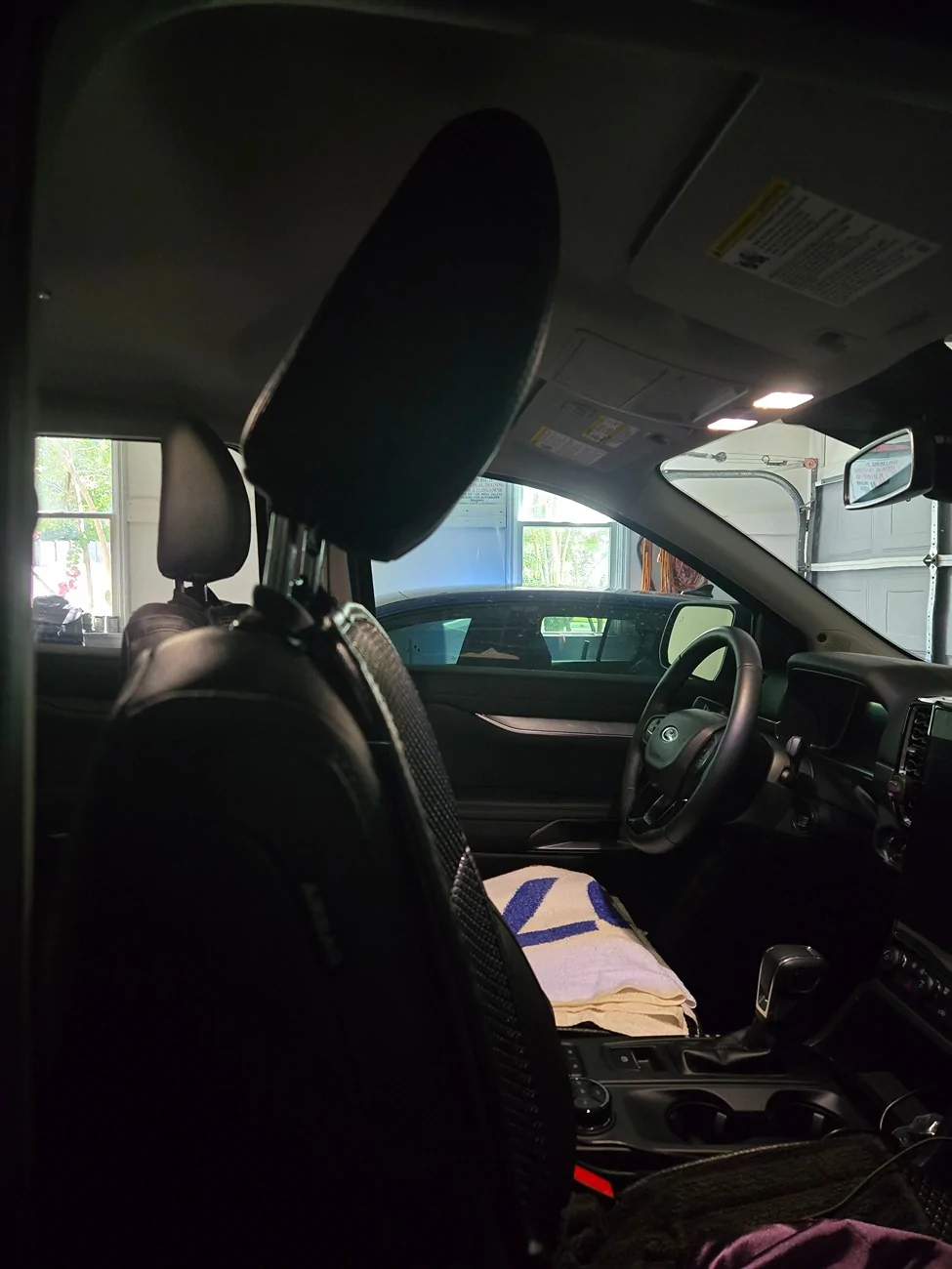

I applied the bending maneuver to the driver side and did not mess with the passenger, here are a couple of pics.
Ford Ranger Maverick Headrests to Solve The Ranger's "Tilt Too Far Forward" Problem 20260807_112155
Ford Ranger Maverick Headrests to Solve The Ranger's "Tilt Too Far Forward" Problem 20260807_111924

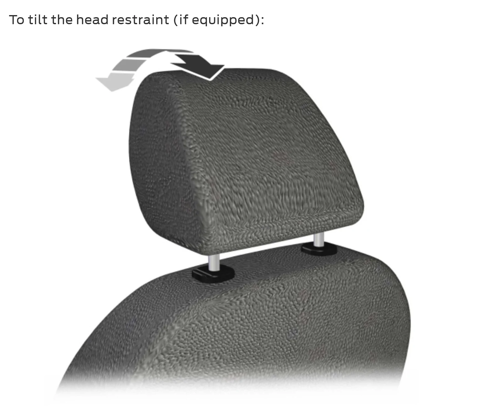

My 2023 Lariat Maverick headrests tilt....they are not fixed.
I wasn’t suggesting that all Maverick headrests are fixed, only those I purchased.
I see in the Maverick owner's manual that some trim level (Lariat I assume) offer tilting headrests. I assume those are the "leatherette" material, which wouldn't have worked for me.
Ford Ranger Maverick Headrests to Solve The Ranger's "Tilt Too Far Forward" Problem 1786192569334-w6
