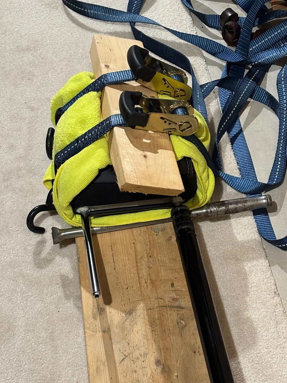

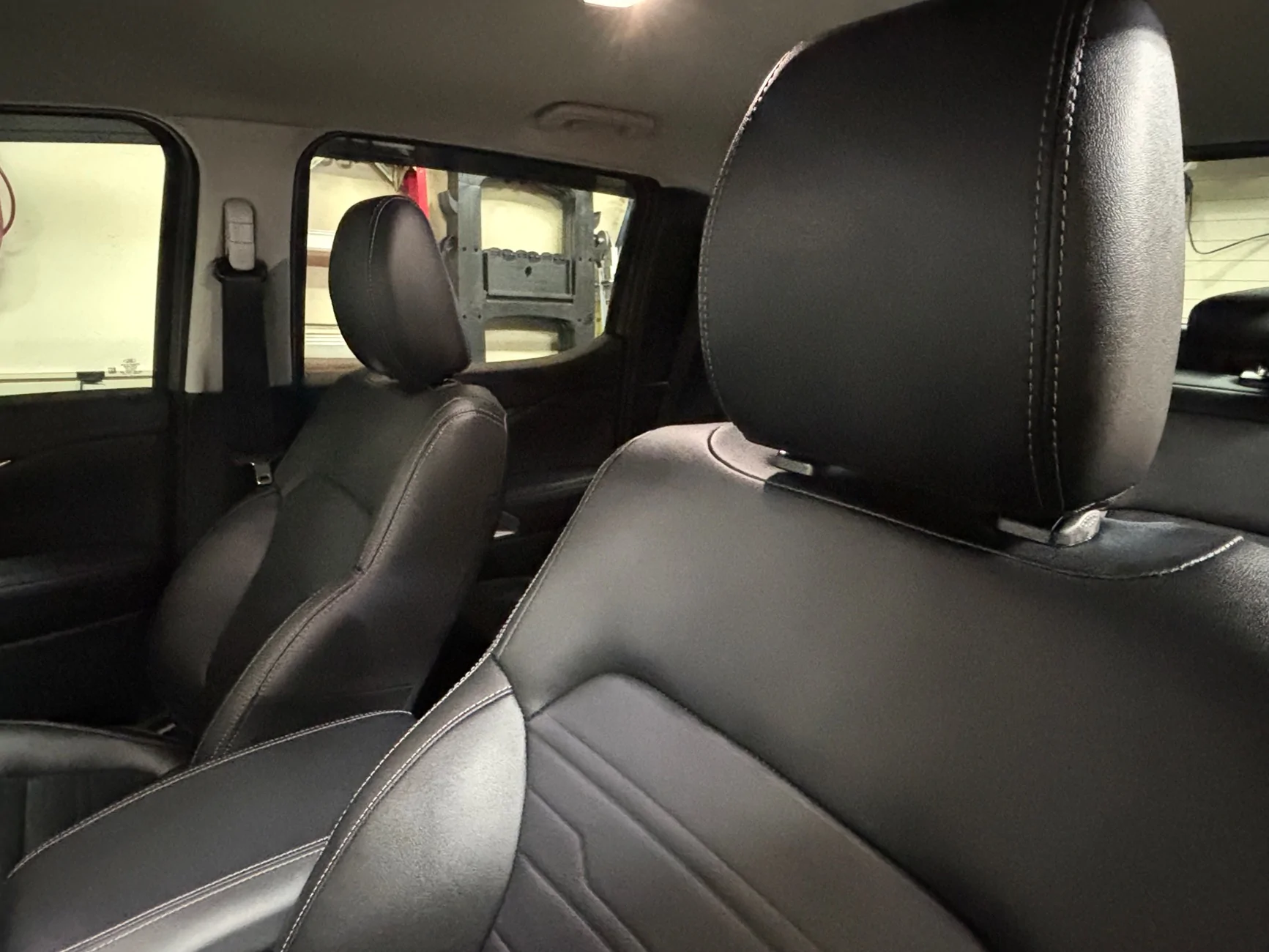

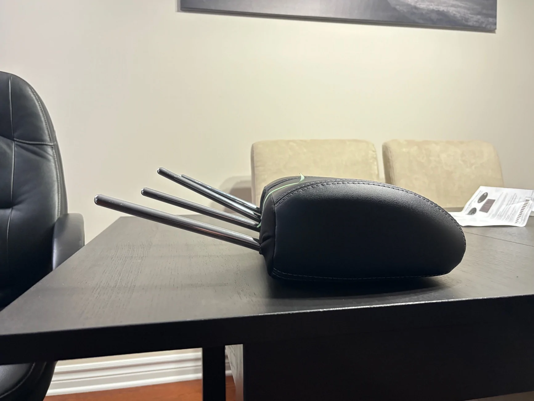

I did mine, strapped to a 2x6 with floor jack handle. Now my 5’11’ frame can sit like I have always sat for 38 yrs with proper anti whiplash gap.
