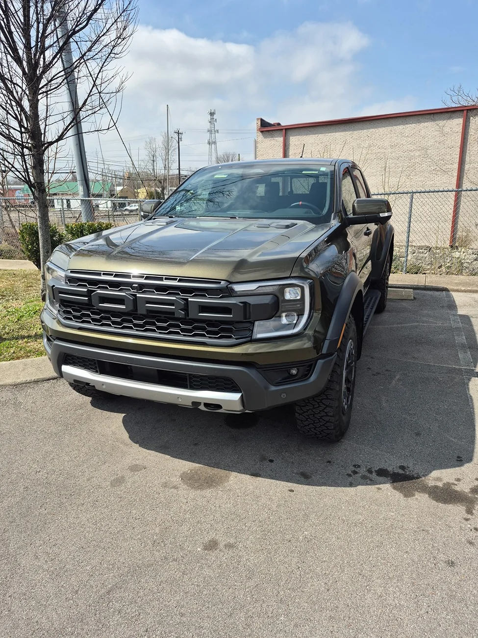

2024 RR with FP Pro Cal since about 5k miles, currently at 13,650 miles on the truck (bought it in March of this year). My long-term average is 16.8 mpg, best I got was about 19 mpg all highway at lower speeds (60~65, no headwind, mostly flat in warmish weather).
I've seen no change in fuel economy before or after the pro-cal, about the same (long term average has stayed at 16.8 after I reset it and let it accumulate again). Driving habbits / trips are fairly routine with it and while I'm not on the throttle constantly, I have no issue putting it to the floor when it's appropriate or just because :sunglasses:
I've read that some pick up 1/2 to 1 mpg by using a tonneau cover because the tail gate is a giant air brake, so that may be where some of the differences come from, but lots of other factors like driving habits, terrain, altitude, humidity, fuel quality, tire pressure and cargo. Fuel economy is fickle, you have it, or you don't, even with a 73 hp Prius C lol.
Seriously though, 455 HP / 536 lb-ft of torque on a 5400 lb truck running soft compound 33" AT Baja style tires....that's NOT bad considering the drag / rolling resistance / power output that's available.
Note that there's a common misconception that Ecoboost engines are going to use less fuel when making full power, that's NOT how it works. The 5.0L and the 3.5L and 3.0L all use around the same fuel and have similar output when under power (towing, WOT or heavy throttle). The fuel savings comes at light load conditions, where the engine is operating more or less NA and the turbos are in bypass. The smaller displacement engines can save around 10~15% on fuel, which isn't huge, but definitely something. Obviously, the broad torque band makes for a broad power band, which is ideal for off-road (Baja, crawling etc.) and towing conditions.

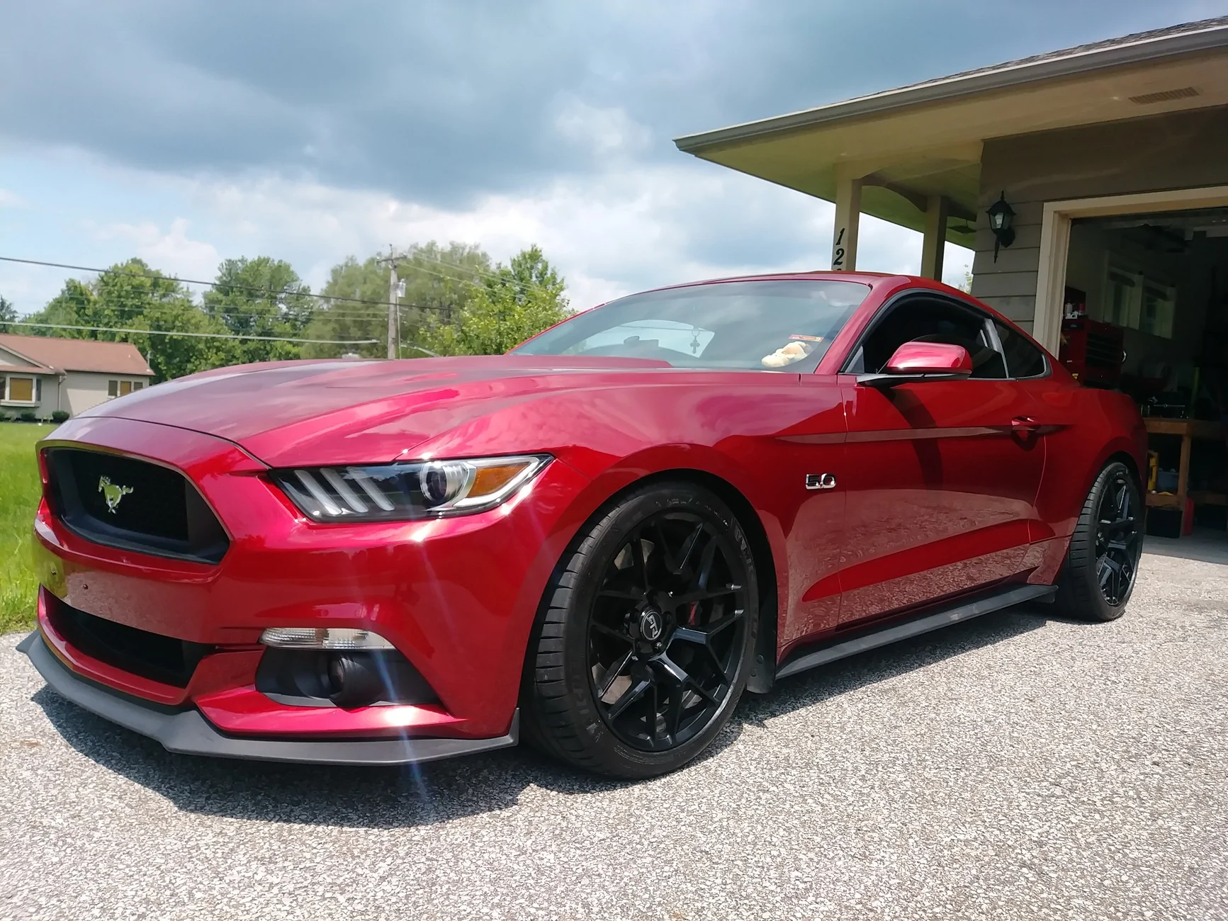

Not exactly apples to apples, but my 2016 Mustang GT with the gen 2 5.0L V8 weighed only 3751 lbs, had a FP Stage 2 Power Pack (456 HP / 424 lb-ft, similar power to the 3.0L with FP Pro Cal but way less torque) and also required 91+ with the Power Pack. I could on rare occasion manage mid 20's, but my long term average on that car was only 17.3 MPG and it weighed nearly 1,700lbs less than the RR, had about ZERO utility and couldn't tow squat, plus a tiny payload capacity…it was FUN to drive fast, sounded super bad a** with a Corsa cat back, looked beautiful and could pull over 1G on a corner, but aside from that...no Beuno!
So personally, I think 16-18 MPG is GOOD considering the capability of the RR, especially with the Pro Cal power output, even if your averaging closer to 16. I might suggest the following:
1. Make sure tire pressure is 39 PSI
2. Use Top Tier fuels to keep the injectors clean over the life the vehicle
3. Drive within 7mph of the actual speed limit and try to keep constant speed as much as possible (keep to lanes with less traffic).
Do all that on a known route, see what you average on a single trip just for that trip.
The Former:
Ford Ranger Gas Mileage - not even getting 16mpg Highway 20190629_121800
The Present:
Ford Ranger Gas Mileage - not even getting 16mpg Highway 20250314_120447

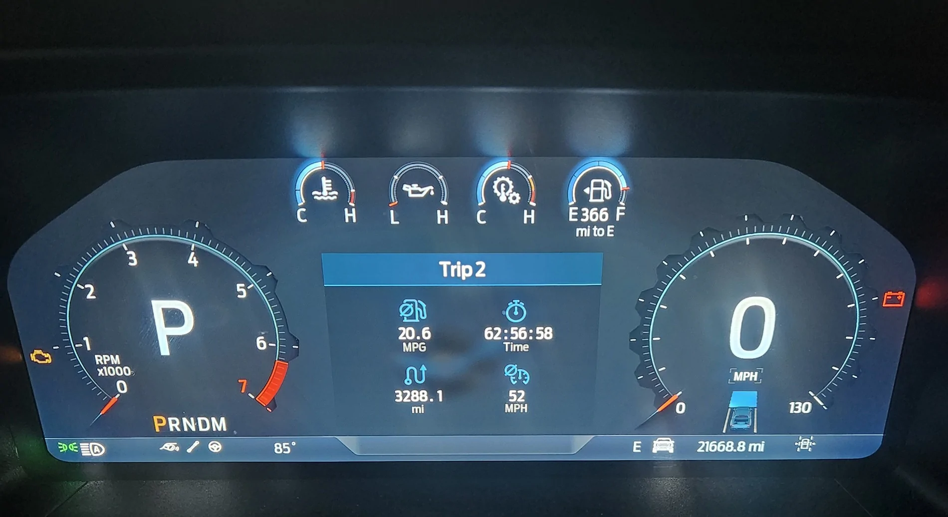

I did a round trip NW Austin TX to Burke, VA to hang with the grandkids. The mileage included as an Uber for the kiddos for over a week NoVa including DC.
We typically just drive on the slow lanes at or below the speed limits.
MPG calculated based on miles traveled and fill up was off with the readout and slightly lower.
Picture was as I parked the RR at the house.
Ford Ranger Gas Mileage - not even getting 16mpg Highway 20250820_200733
