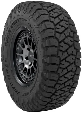

On the Jeep 4-door JL the noise and on road comfort have been fine. The Jeep does have Synergy progressive springs and Elka shocks though. 99MPH versus 112MPH speed rating is the only downside I see for running Toyo Open Country R/T Trails vs KO3s on the Ranger Raptor.
