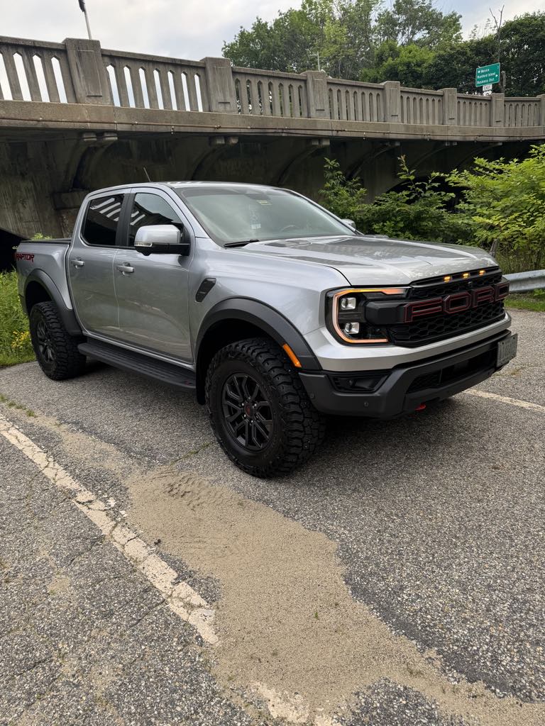

I changed out my BL wheels for Roush, K03's are fine for me.
