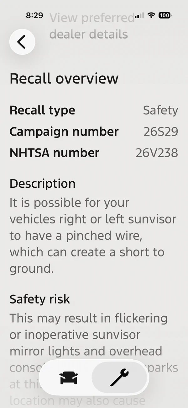

Ford Ranger Going in this morning for pinched wire recall. IMG_0125

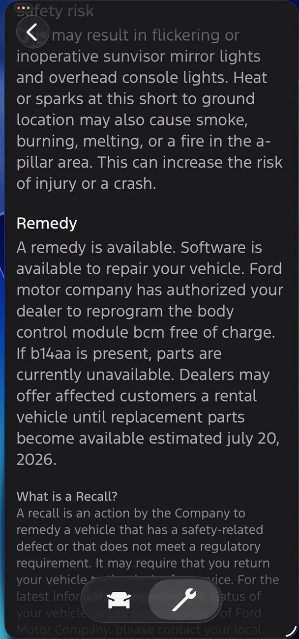

yes, but if you have the fault, parts aren’t available until July for the fix. I believe the original word from ford was no fix until August.
it was unclear to me if the BCM software fix was available yet. I thought it might be OTA but it makes sense that the fault condition has to be checked by a technician.

Ford Ranger Going in this morning for pinched wire recall. IMG_0377

Right - The tech must check first to see if you are currently triggering the DTC or if the DTC is in history. If it is not, then they proceed with the BCM update. If it is, then they will still update the BCM but will call you back in to replace the parts, which are not yet available--but at least the update will change the way the circuit handles the system to eliminate the risk.
