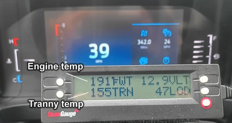

My typical combined '25 Ranger 2.3L city/highway temps @ 75 degrees when not towing:
Ford Ranger Highway operating temperatures 2.3L Tranny Tem

Mine shows the same. I checked the oil temp on the dipstick with a contact pyrometer to see what it reads when the gauge is over half. Pyrometer was reading 180f. These factory gauges are buffered and rarely truly indicate actual temp or pressure. It is a bit odd though that it reads so high. Usually manufacturers have the gauge buffered to read "normal" until it gets really hot so customers don't complain. Bottom line, it's an "idiot" gauge. Ignore it unless it goes in the red.
