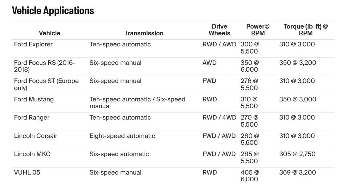

Has the 2.3L Engine been up graded since the 5G Ranger. Ford 2.3 EcoBoost Engine Specs, Problems, Reliability, oil, Mustang, Focus RS (motorreviewer.com)

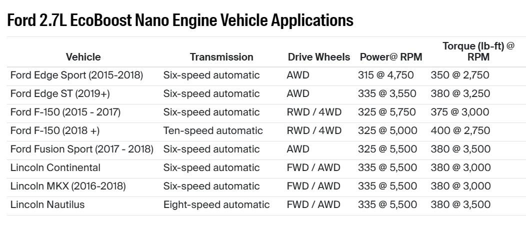

Has the 2.7L Engine been upgrade since 2018. Ford 2.7 EcoBoost Engine Specs, Problems, Reliability, oil, F-150, Bronco (motorreviewer.com)
Most likely both of them the emission systems have been improved.
Has the fuel economy improved.
What do you think about the engine Architecture.
How easy are the engines to service. ie Ranger 2.3L 5G oil filter is recommended to go in through the left fender and remove the mud guard.
2.7L has the Port and direct injection. Less possibility in the long term of having coking problems on the valves

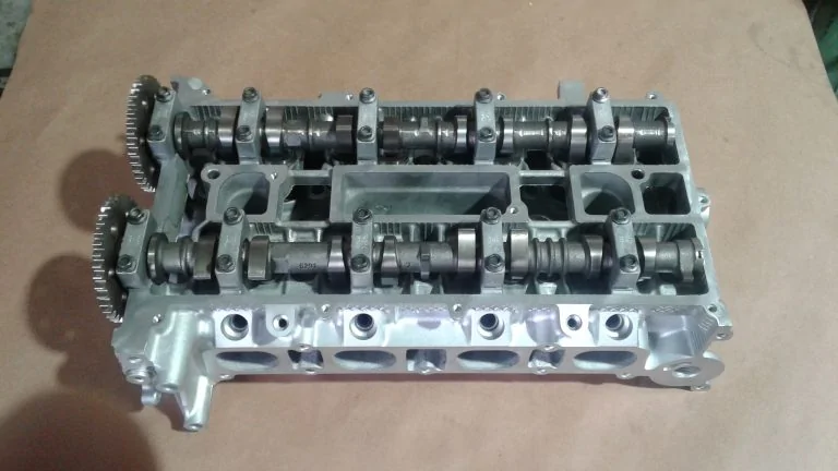

Its has the bucket over shim valve adjustment. Takes along time for the
measured gap from bucket to cam to get out of adjustment.
I wish i could find the video of a head with its cams off.
I did not know if it was real or they were just fooling around.
It was like red neck assembly.
He did not keep the buckets in order the way they came off.
The he takes one bucket and starts hammering it into the aluminum head with a rubber mallet.
I was horrified.

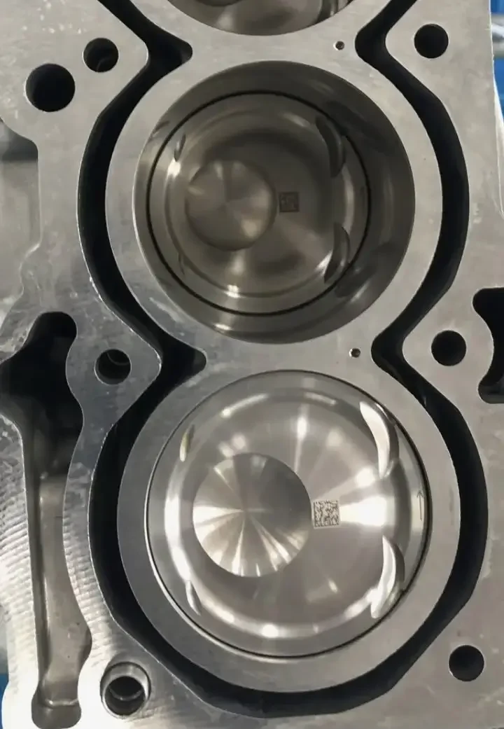

The way most auto companies make their Aluminum Blocks is through a high pressure injected mold. Makes the block's metallurgy better. Not forged but the crystal structures are stronger from the process.
I think i can verify that the 2.3L has forged rods not sure about the crank
Here's an article of the 2015 2.3L.
I would think some of the information still holds true of the way you would build a 2.3L MPC.
This info is from the 2015 2.3L Engine. The MPC motor must use some or most of this design.
The engine was built around a high-pressure die-cast open-deck aluminum cylinder block. While the bore size and deck height are the same as in the 2.0L EcoBoost, the 2.3L engine block has enlarged oil and cooling passages and a structural ladder frame (strengthening ribs molded around the cylinders) with integrated main bearing caps. The increased displacement was achieved by applying a new forged 4340 steel crankshaft with a 94 mm stroke (2L has an 83.1 mm stroke). The engine also uses forged steel connecting rods (they are shorter than 2.0L conrods) and lightweight high-strength pistons with steel piston ring carriers and fully floating pins. The new pistons have a low-friction skirt coating and fewer oil drainage holes for better lubrication and lower friction. The bottom side of the cylinders is cooled with oil constantly sprayed by special oil jets inside the engine block. The bottom of the engine includes a chain-driven oil pump, balance shaft, and a die-cast deep-sump aluminum oil pan with a baffling area that helps prevent oil slosh and maintain oil delivery during active driving.
