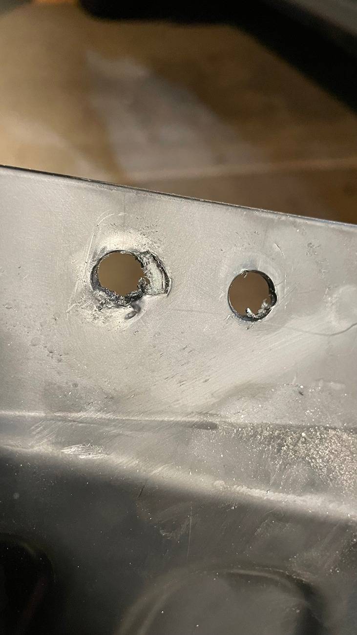

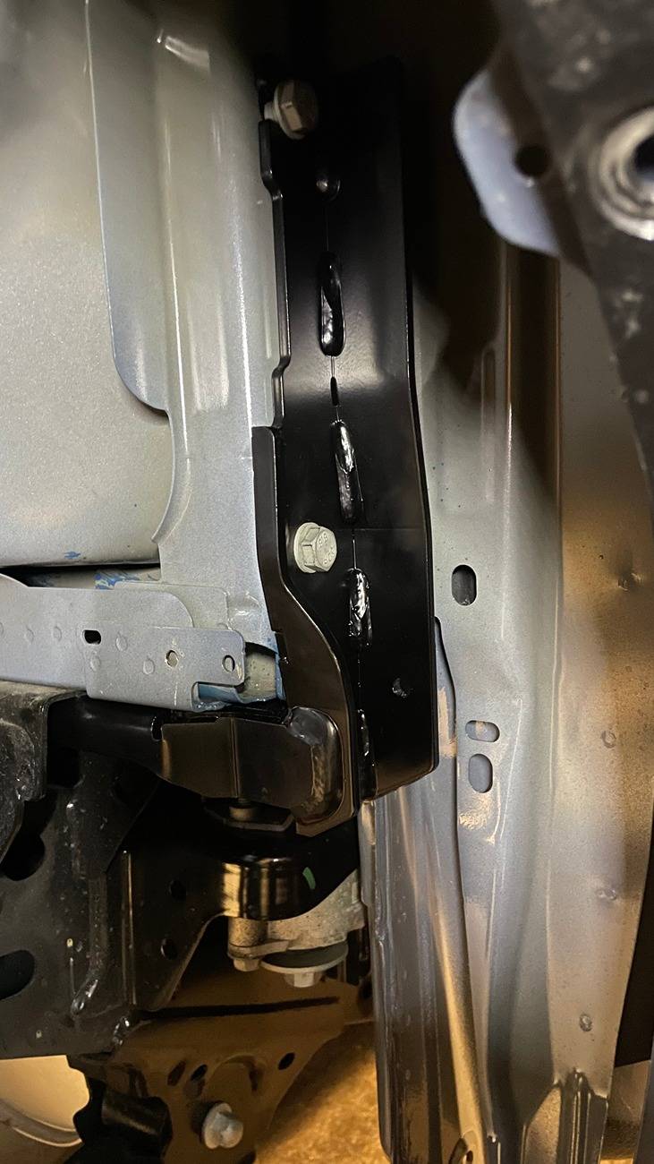

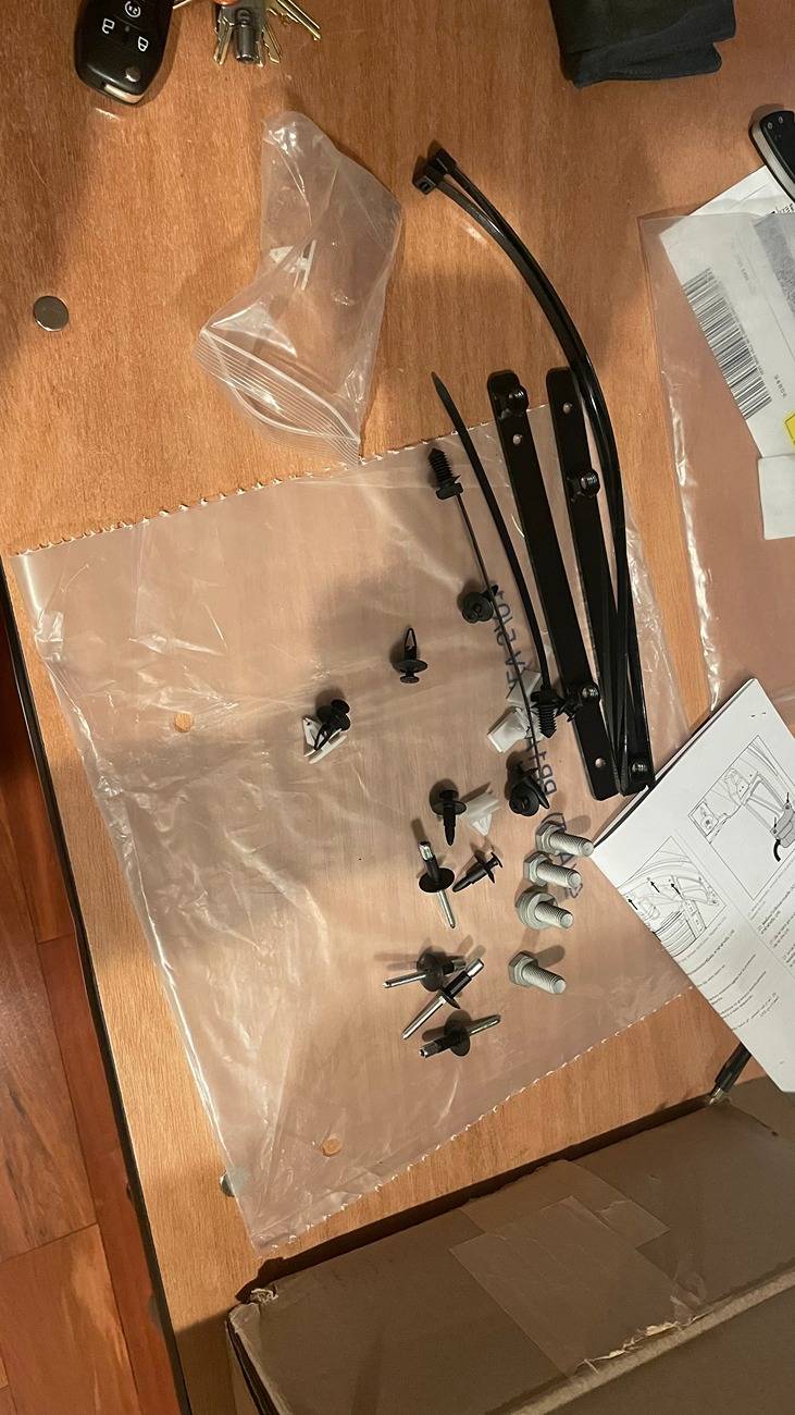

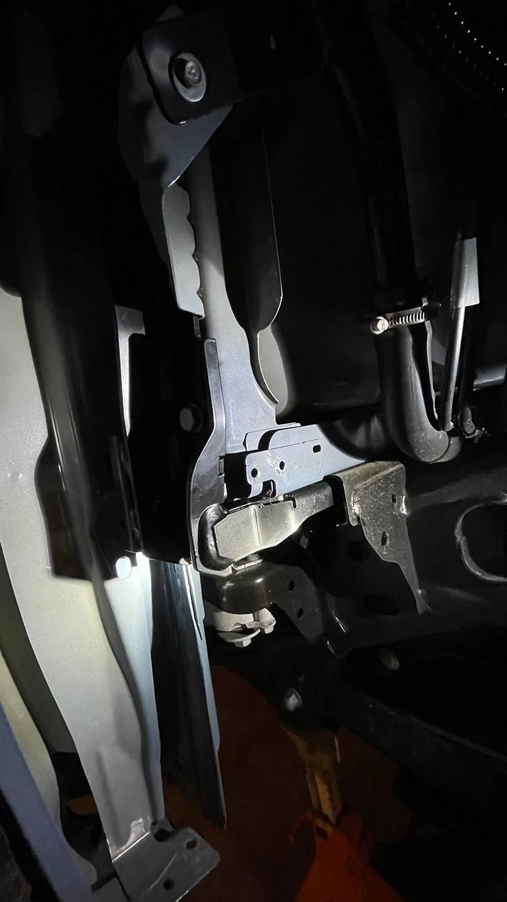

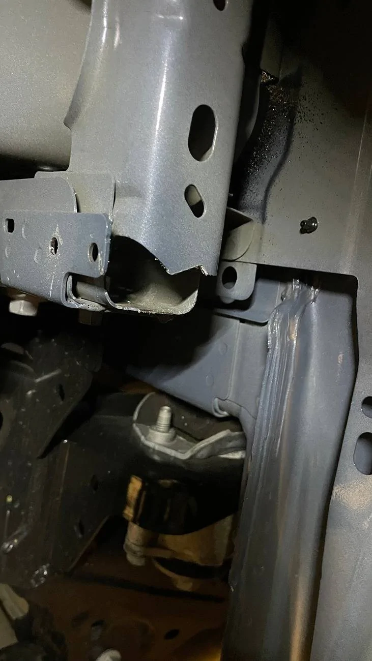

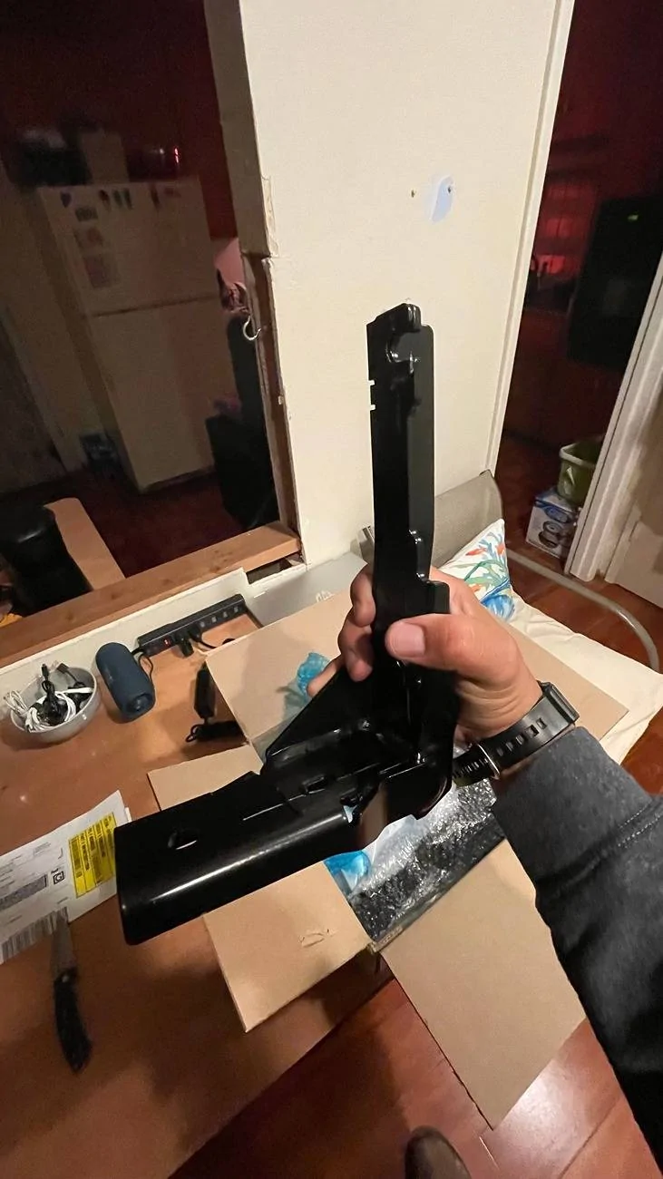

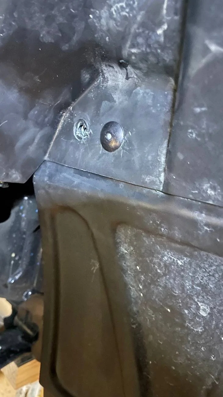

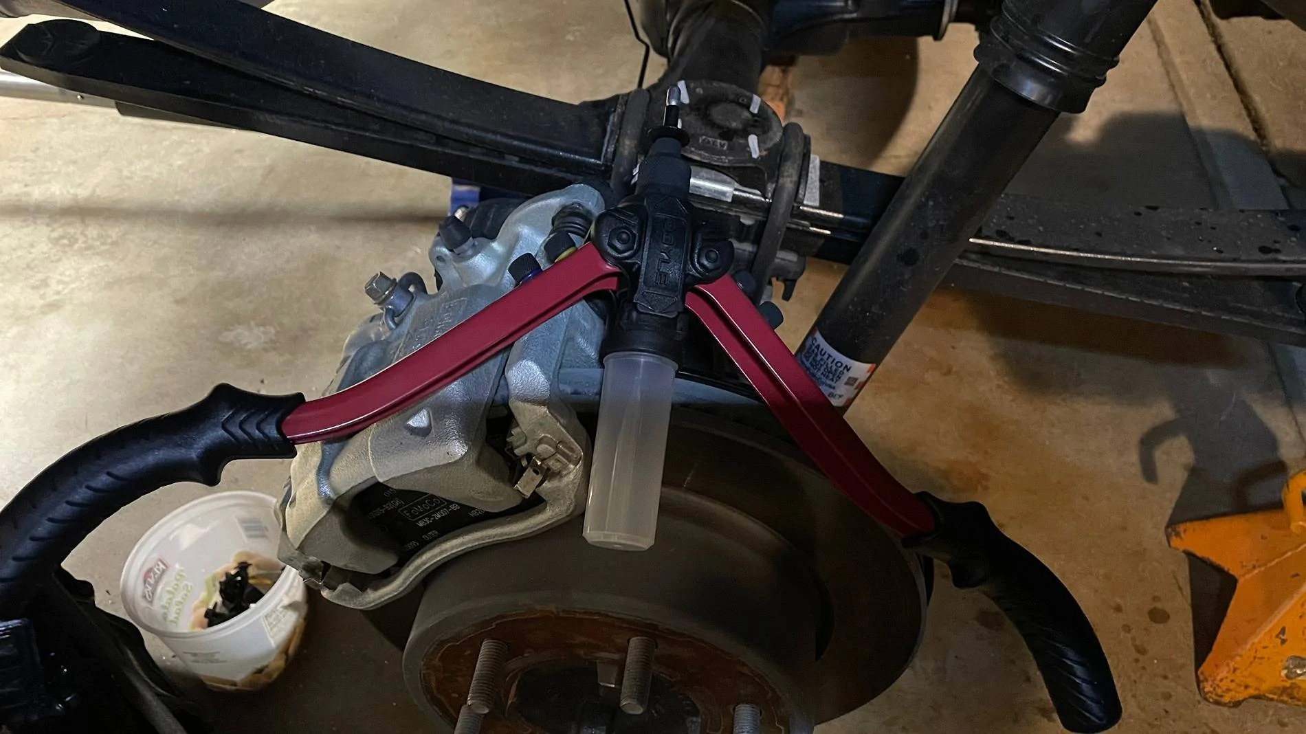

Installed them. I'm not new to ShadeTree 101. and i have some tools. I'll say this- If you can find a dealer to install then for $160, pay it and be happy. On the other hand~~ Take off the wheel. There's no way to Drill the Rivits out cleanly. I hit them with an angle grinder to flatten them out, because the steel center is rounded. I then center punched them, and higt them with a new cobalt bit, it was still all over the place. Had 2 other good drills, progressive. Used my dremmel, some vice grips to smash, got them out. Left a little carnage behind, gonna happen. Next issue is pealing the liner back, on the first one, on install I noticed I managed to pull it free of the 2 back Rivits. Not the tragedy you'd think, because i could get under the heads with the Dremmel. If you don't have a big rivit gun, Harbor Freight has a Doyle 13" ( don't know what he's doing in China ) that worked perfectly. BLUE locktite the 2 new side suppott bolts. There was nothing Hose or Harnes wise in the way. Mine was built 3/24, maybe they relized this was a problem by then, or they just changed the routing at that point. The 2nd side was the same carnage with the Rivits, However this time i was more careful of the liner. BTW, the Liner goes Between the lip mounding and the metal fender, I managed to get it jammed nicely with a bend above the metal. Took a fair amount of effort and the expidited use of the 95* trim tool to get it right. Sheered 2 clips off of the 2nd side lip moulding. Still solid.. All in all a, major PITA, But got it done. The metal in there was just 2 gauges above tinfoil. I cut it with an angle grinder in about 2 secs. the Braces are Massive. Massive like your truck gets hit by an RPG, the braces will still be where they were before hand, and ok. Good Luck C.
No no no no !!! J/K. : )
Ford Ranger J braces back in stock IMG_2604
Ford Ranger J braces back in stock IMG_2607
Ford Ranger J braces back in stock IMG_2605
Ford Ranger J braces back in stock IMG_2601
Ford Ranger J braces back in stock IMG_2603
Ford Ranger J braces back in stock IMG_2606
~ a thing of Beauty!

I've had mine sitting on the bench a while now waiting for time and cooler weather to install. After seeing that install post, yeah... someone else can install these. I hate dealing with rivets.
