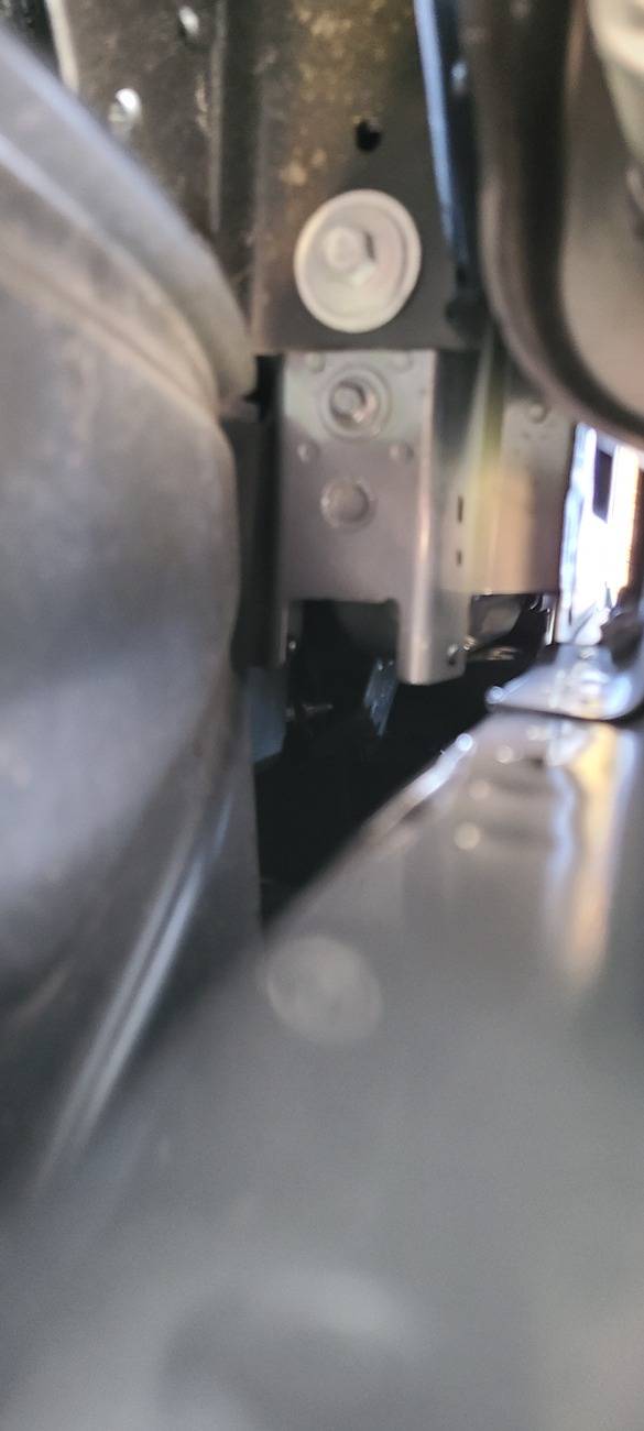

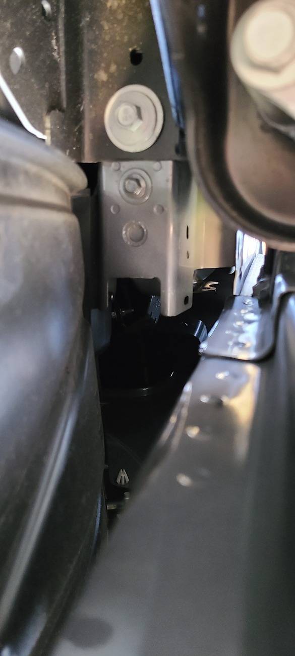

Where do i look to see if i need these? My truck says 9/24 on the door sticker but i dont know what day. I can easily look, i just need to know where to look because i looked in the rear wheel area really quickly and only saw the wheel liner.
mpcraven
Jun 13, 2024
58
Atlanta GA
2008 9-5 Aero, 2014 Evora, 2024 XLT
See page 1 of the thread "J - Braces CONFIRMED NOT needed for Raptors after 9/12" for side by side comparison photos. You can see the rounded elbow looking up from the pavement, but just barely.
4,065
3,932
Well, my truck doesnt have them. That sucks.
