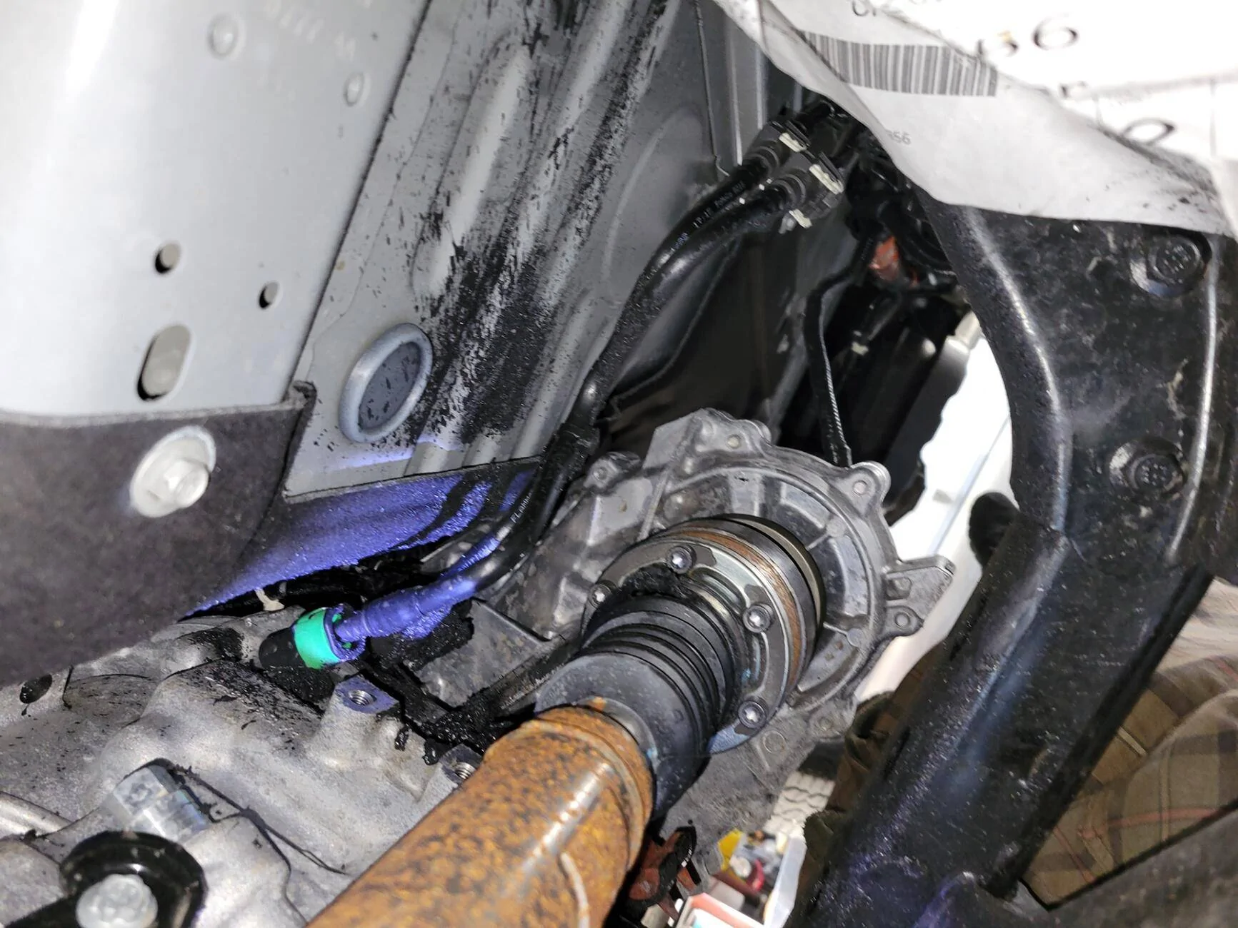

Just saw this topic and had to check mine. Picked up Fri with 57 miles, currently Easter Sunday with 63 miles (drove it home, and took the grandsons for a ride around the block yesterday).

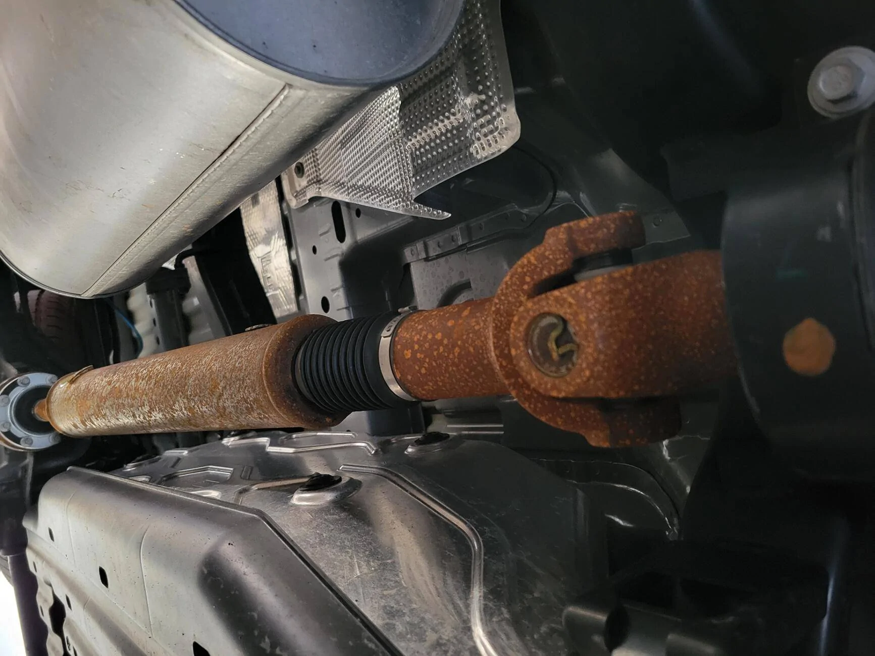

I was surprised with the rusty drive shaft and a couple bolts in the rear brake back plates. But 2 other things upset me:

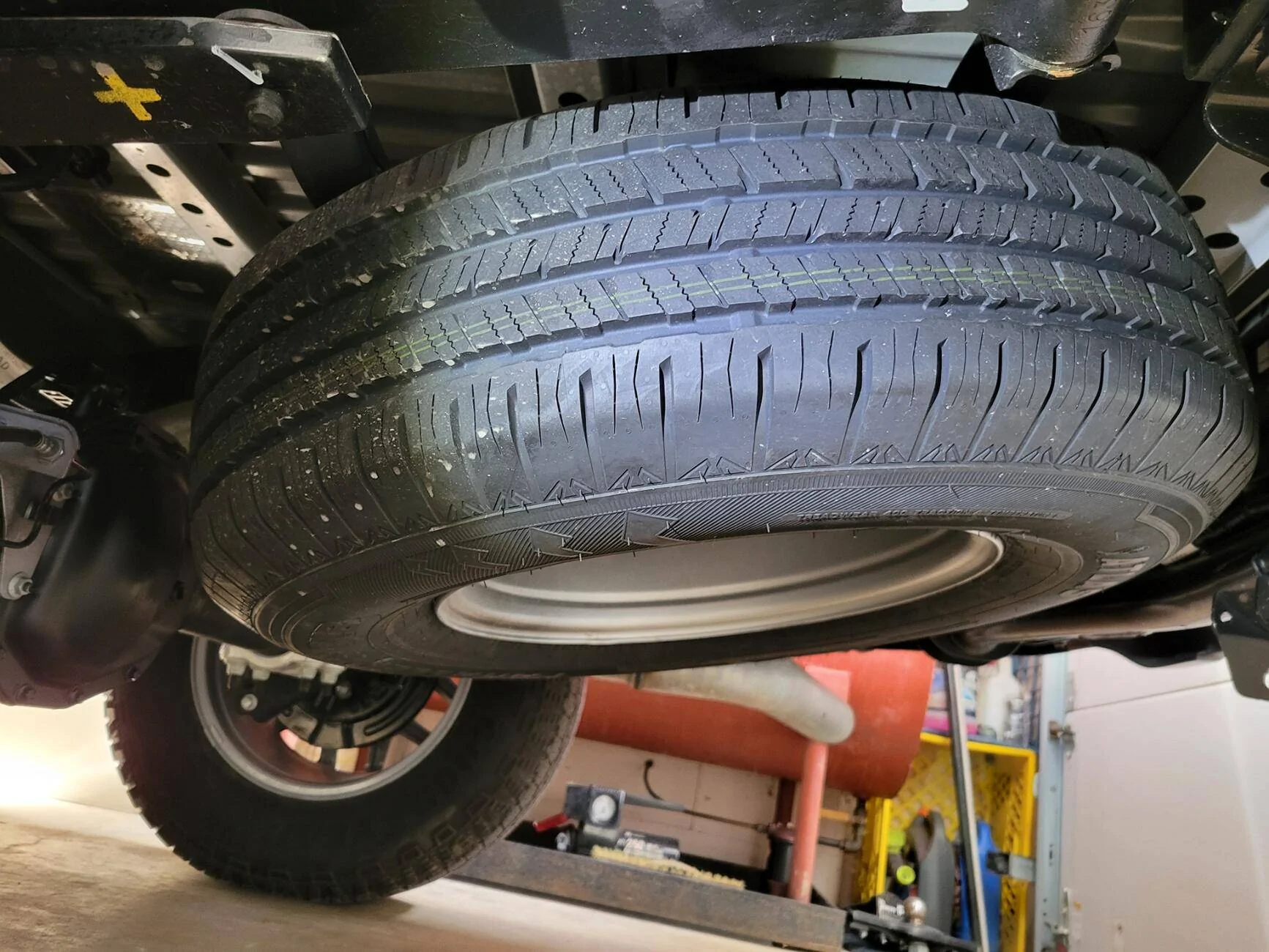

First the spare is a 16" WTF?? It's a PARALLER H/TNB ATLAS , 235/80R16 109T street tread, wear rate 400 made in Thailand. The stock tires are Goodyear Wrangler M & S 255/70R17 112T wear rate 580 made in Mexico. Can this be kosher? Granted it's not a donut, but can't rotate them!

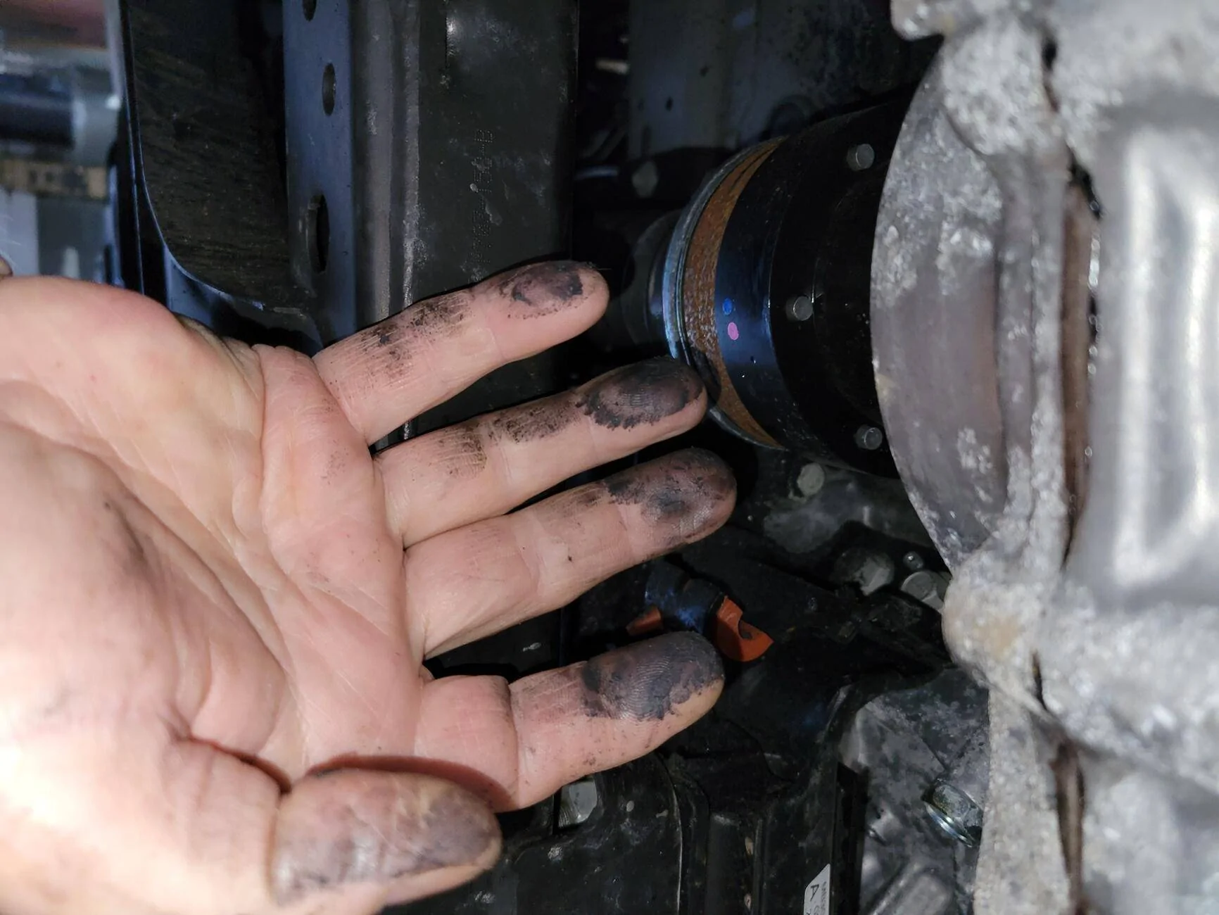

Second and most concerning, bc above is an easy fix: there is a ton of grease/oil splattered over the undercarriage at the trans - transfer case joint. I didn't notice it until I grabbed the hydroformed steel crossmember and my hand came up black! I think a trip to the dealer is in order or maybe call Ford first? I never had this happen before, on any of my many new vehicles (all Fords)! You might be able to see a piece of paper under there which was splattered with grease or oil. I got it out and it was sort of like a routing paper masking taped to the frame and still hanging on for dear life...This made it thru QC checks?

Looks like its leaking grease from that black shaft boot. Is that the front shaft going to the front differential or the rear shaft going back to the rear axle?

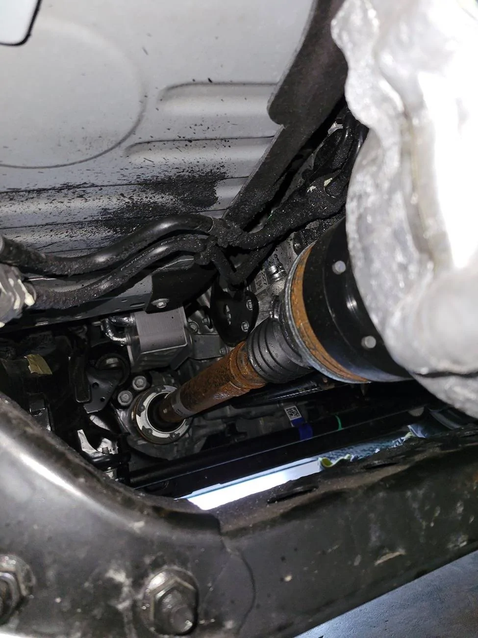

@tbalt Tom, its the front shaft coming out of the transfer case, here's a shot looking forward. You may be correct, it's not oil, but sure made a mess! Does that shaft even turn normally? I've not had it in 4wd yet??

My thought is there's no telling where else salt has gotten stuck if the undercarriage looks anything but brand new. I don't wanna assume they fix it and my fenders start rotting out after i own it for a year.
It's just hard to fathom that there is that much rust, even if sitting outside since January. Here in Ohio MOST people drive their cars through the winter - all winter - through the salt, slush and snow and are NOT washing them each time. The cars go 3-4 months during and after salt with no cleaning, each year, every year. My daily driver is 15 years old now and does not have that much rust on the bottom...
I have the same spare tire but no leak from the seal

My 22 Ranger had a cracked shaft boot when new and did the same.
I just ordered paint and rust converter for when my truck arrives. Ford should have painted the driveshaft. Probably trying to save a buck.

Someone correct me if I'm wrong, but it seems like the proper remedy to this issue is to remove the rust and paint/seal the components to prevent continuation of the problem. Most other vehicles have painted/ coated drive shafts.
None of this work should fall on the owner of a brand new vehicle. My hope is that if EVERY new Ranger owner brings this issue forward, that Ford will be forced to address it formally via service bulletin etc.

I saw a review of a new local F-150 Raptor just delivered and there was basically no rust underneath and the driveshaft was painted black.
I agree the rust is not welcome, but many might suggest we may be concerned too much. The drive shaft itself will never rust-out, and might behave like self-weathering steel light poles. The oxidation actually helps protect the steel underneath.

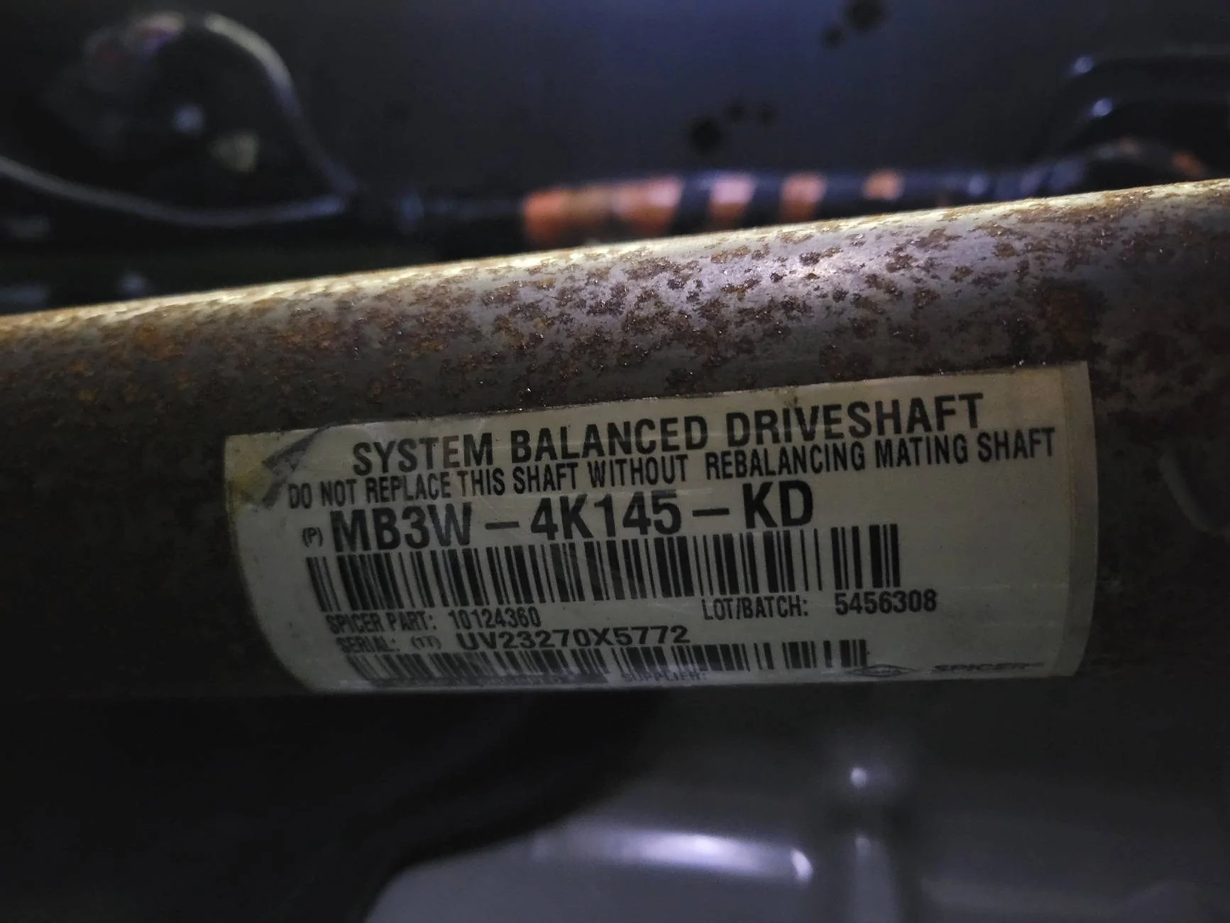

Anxiously awaiting any resolution, plus we have members from Ford that read the forum.
FYI weathering steel has a special chemistry containing copper to achieve a protective coating to discourage further rust, Cor-Ten is one trade name. I'm certain this is not the case with our driveshafts and nuts and bolts. My drives shaft is perfectly clean under a small decal they put there from inspection, but the other 99.9% is rusted. I attached a picture of the drive shaft tag...I do not want this to get worse and affect my brand new truck. Shame on Ford?
