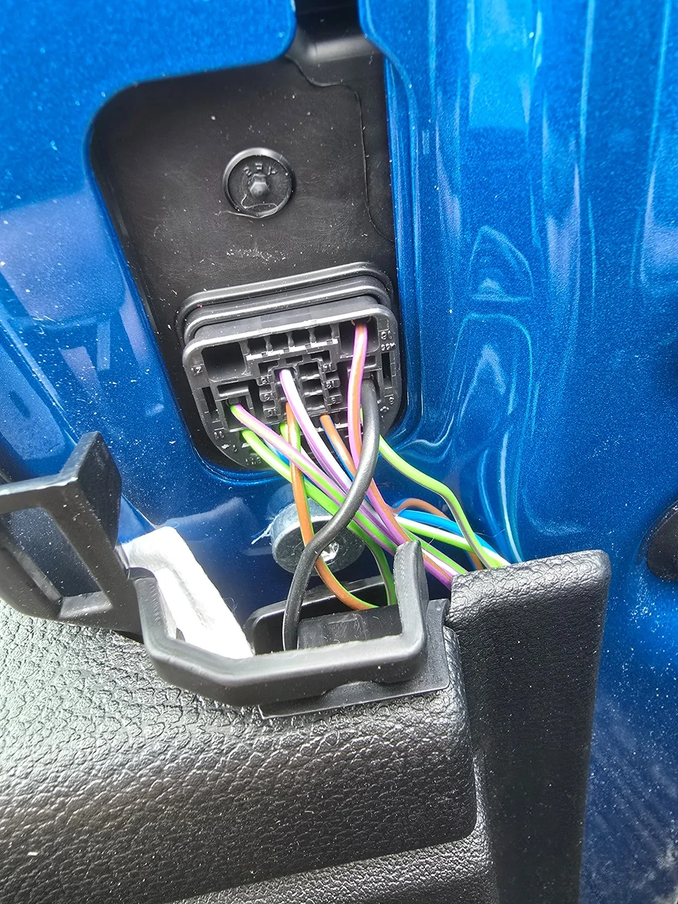

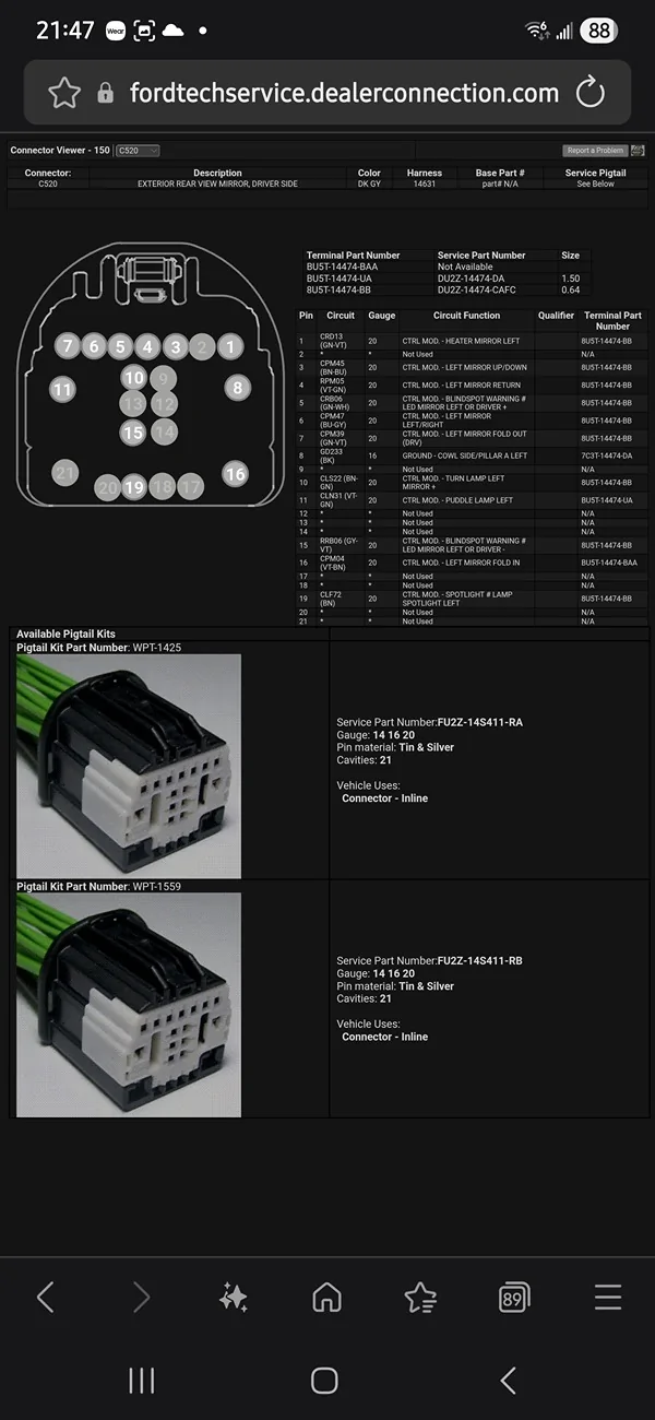

pop the small triangle shapped cover off the door inside behind the mirror. look at your truck side plug, then look in my thread and see if the wiring diagram matchs. my 25 xlt was prewired to the mirror plug on the truck for heat, turn, puddle. was already power fold and bliss. no camera. if I want the 301a package xlt mirrors(heat, turn, puddle, bliss, power fold no camera) its 1400 for one side, and 1600 for the other side. I ordered the heated glass, and ran my own wires to the glass, and added wires for turns and puddle.
unless you add after market turns like say 3/4" button lights, there is no way to add the orm turns, as the housings are different. but if truck is pre wired still you can add your own, then enable them in forscan in each door module. also gunna get a set of amazon puddle lights and cut the hole for them in the bottom. thats what I plan on doing untill I either find a set of junkyard xlt 301a mirrors or buy the clearview towing mirrors.

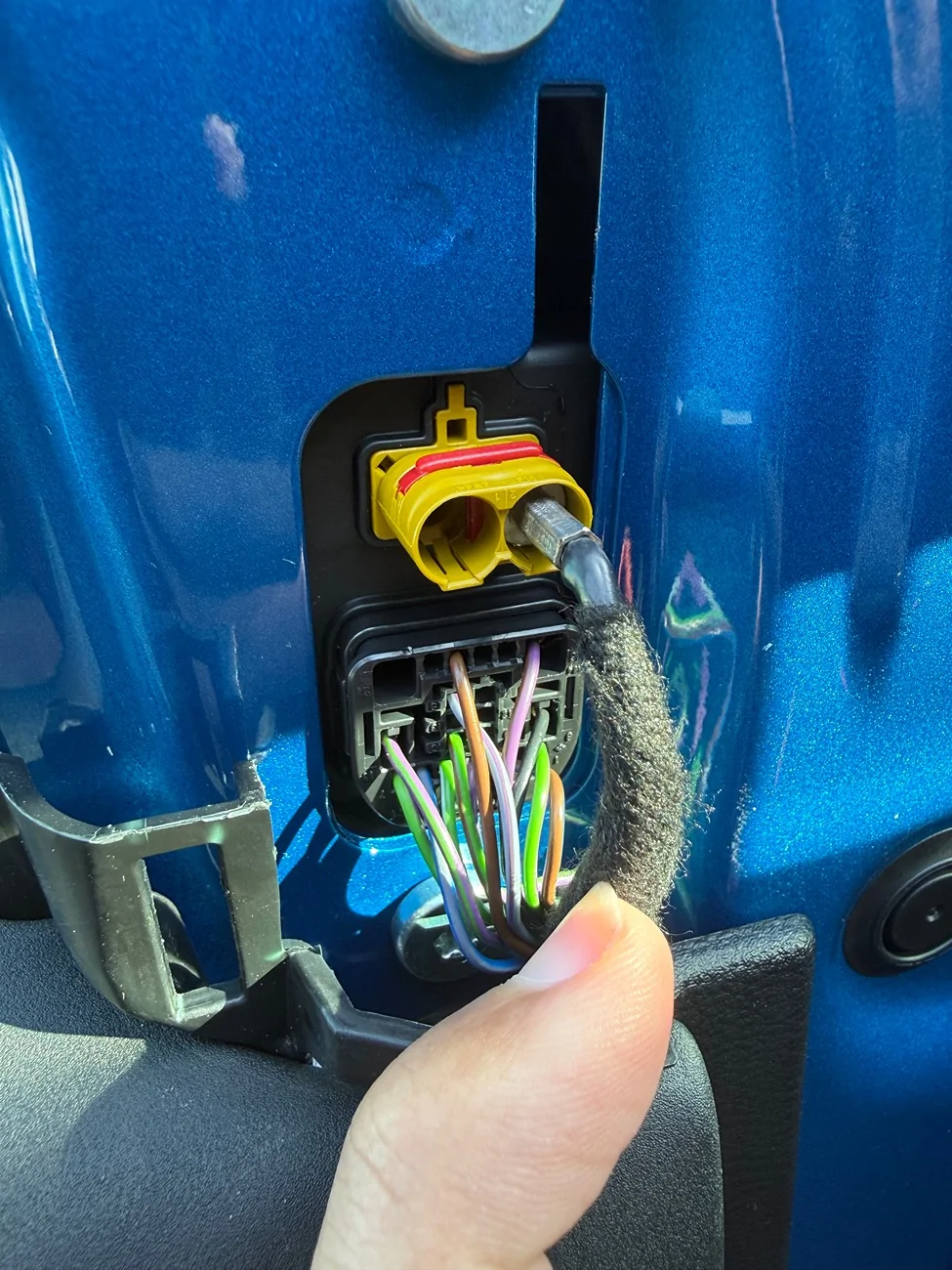

I finally got my hands on my new RR and pulled the mirror cap off. It seem the mirrors are Pre-wired for the turn signal (pin 10, stole your picture).
This makes me believe that all I would potentially require now is the lower exterior mirror cover, turn indicators, wiring in lower cover of indicator, light for indicator (assuming it’s not in the assembly). Then to Forescan to have the blinkers activate.

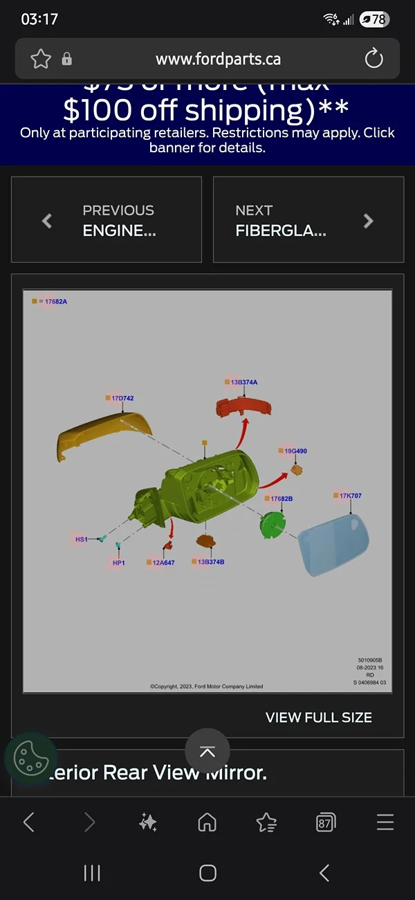

You have to get the whole assembly. The only parts sepperate are the ones here, not on the main assembly. but a set of 24/25 lariat/RR mirrors will bolt right on. then go in the driver and passenger door modules to enable the turns.
