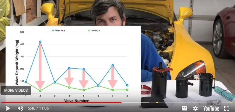

Engineering explained. Not sure if this one in particular has been posted. One thing he said that really piqued my attention was "any of these are better options than doing nothing at all."

Wonder why only half the valves saw reduced deposits...
He explains this in the video. The valves that got the most build up are the ones closest to the PCV inlet at the intake manifold (located between valves 4 and 5). The contaminants follow the path of least resistance and go to the nearest open valve for each cylinder. In this dual intake valve per cylinder example that means valves 2, 4, 5 and 7.
But I thought the catch can was supposed to "catch" the contaminates?
The chart clearly shows nearly zero difference at all on half the valves, so what's the point? It's good information though.
Using the guy in the video's logic, if it does anything at all it's worth doing... and that's just flawed logic.

You might want to try watching that part of the video again.
The deposits were acquired when the PCV was connected to the intake runner on a stock DI engine that did not have a catch can. The next part of the test was done with the PCV not routed into the intake runner at all.

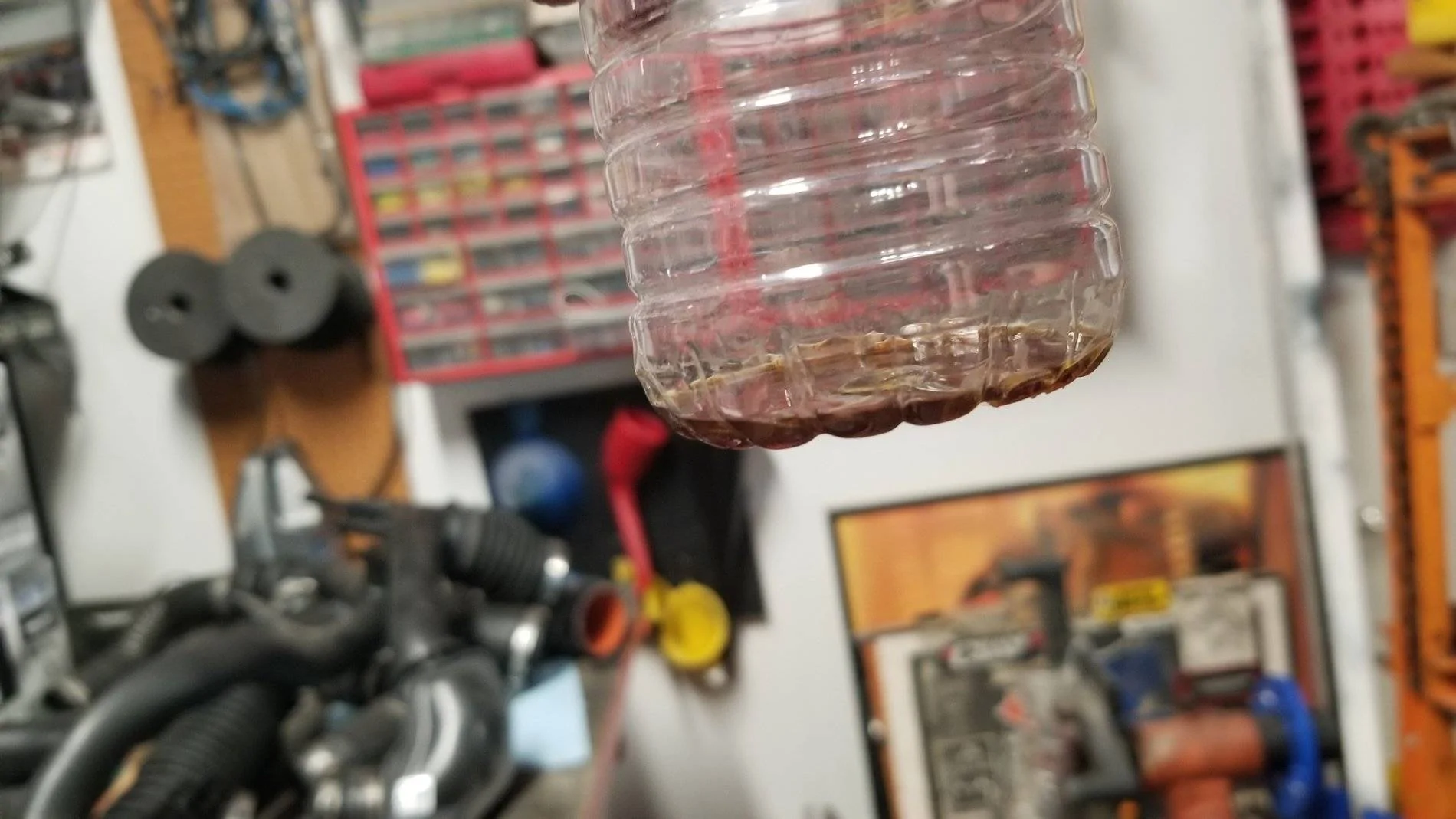

I've already posted a couple times with pictures of the junk I've collected over a time period.

The video that this chart was taken from... the test was not performed with a catch can. They just vented the crankcase vapors to some other place (atmosphere or condensed and collected? Didn't specifically say.)
And thanks. But from what I'm seeing, I'm not convinced that this small amount of "junk" in 1100 miles will be an issue. What oil are you running? Do you use 93 octane top tier fuel?
Ford Ranger Oil Catch Can. Yes or No? RCMUSTANG 1100 miles
RCMUSTANG
Ray
Jan 22, 2019
1,539
571
Los Angeles
1989 Mustang 2017 Fusion
1. Look to my second picture of how much I picked up. 2. Mobil 1 full synthetic. 3. There is not 93 or 92 around here. Also, fuel has nothing to do with the amount of oil being sucked back into the intake. You think that amount of oil is ok? Then don't get one. As I mentioned several times my intake is now bone dry since the catch can. It was coated before. That would include all the intake tract, turbo and intercooler.

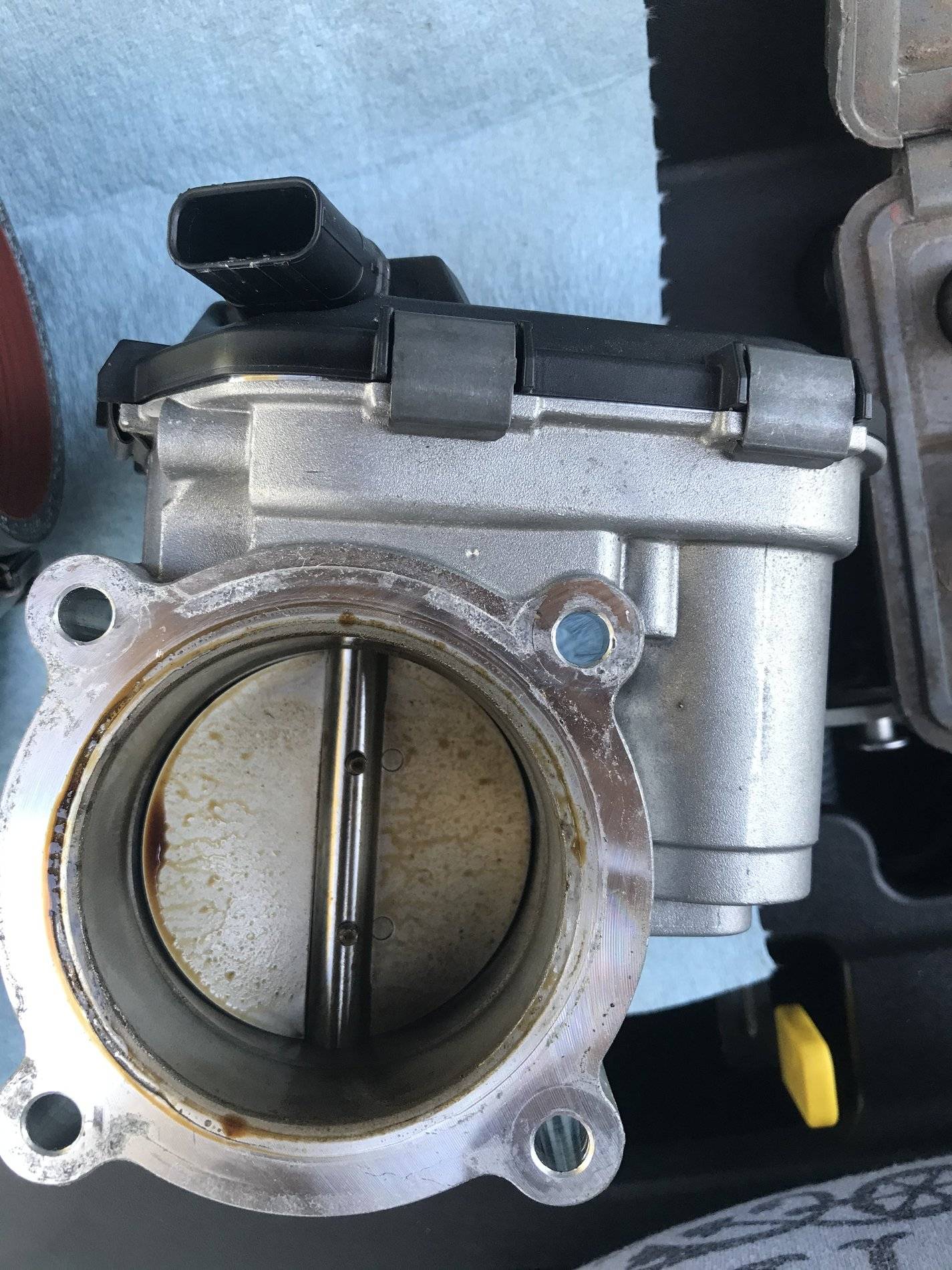

I decided to install the JLT when my truck was at 12k miles after pulling off the throttle body at around 10k miles and finding it completely coated in oil
Ford Ranger Oil Catch Can. Yes or No? 2A5E10F9-7791-4CDD-B82E-45FF95864134
The truck currently has 13,500 miles and I haven’t noticed any negative effects of having the catch can installed. The plan is to re-inspect throttle body at 20k but I may do it at 15k after the next dealer oil change. I’ve only checked the contents of the can once so far after about 500 miles and it picked up about an equal amount of oil as what I found on the back of the throttle body. Sorry I didn’t take an accurate measurement at the time but enough oil to cover 1/4 of a blue shop towel. Will try to find time this weekend to pull can and measure contents, will definitely post results
