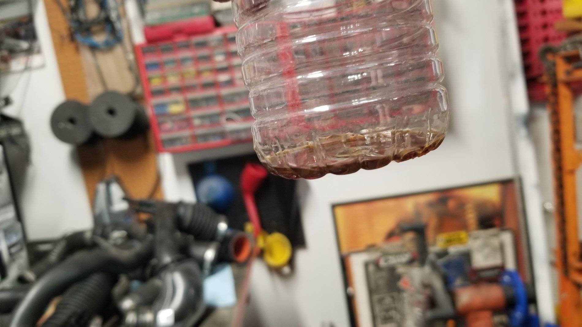

And thanks. But from what I'm seeing, I'm not convinced that this small amount of "junk" in 1100 miles will be an issue. What oil are you running? Do you use 93 octane top tier fuel?
I'm not trying to single you out John. You seem to be asking questions in a genuine search for knowledge so I am trying to help offer what could be answers from my viewpoint. You are right that does not seem like much stuff over roughly a thousand miles. Extrapolate that amount out over 150,000 plus miles and it does add up. I've kept most of my vehicles well past 150k.
Hard to tell from that picture but wild guess let's say that is roughly half an ounce that got collected. Half an ounce per thousand miles times 150 comes to 75 ounces which is almost 2 and a quarter liters. That is a fair amount of stuff being fed into the intake track over the lifetime of owning a vehicle.
