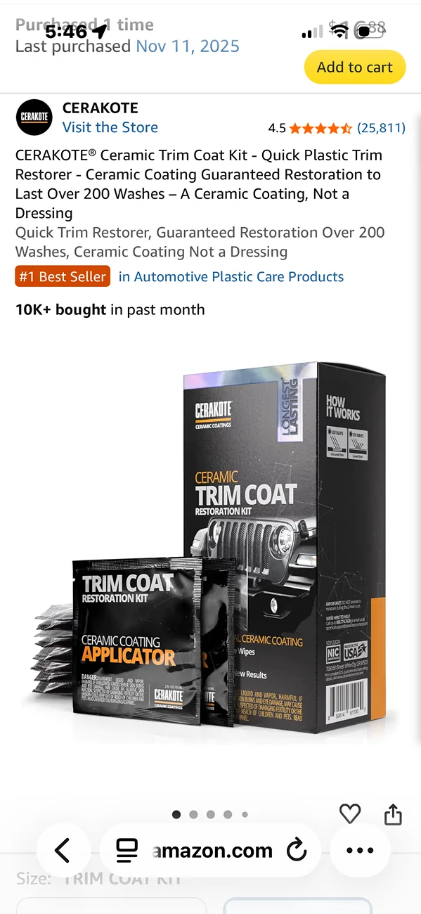

I watched Todd from Project Farm’s YouTube channel where he tests everything. He did a test Car Plastic Trim Protector/Restore Video which came out with Ceracoat Trim Coat as the best. Amazon Amazon Price for Ceracoat. It is currently less than $17.
Ford Ranger Protection For Exterior Plastics? IMG_3478
I have been using it on my truck for 8 months in the Texas sun. All the parts I originally treated look like new—some I missed, aged rather quickly and I coated them a month ago to look like new again. Exceptional product, inexpensive, and easy to get. Watch the video from Project Farm.

You have to be very careful with the Cerakote trim stuff. It is quite permanent so make sure you don’t get it on ANYTHING you don’t want it on forever. Like… forEVER. I used it on my top bed and tailgate rails, and probably will apply to the top of the bumper cover. But only ever use it on textured plastic. Nothing smooth or it can look terrible if not done perfectly
Cerakote is pretty adamant that it is not a protectant, but a RESTORE product. Mine seems to be OK on 4 month old plastics that sit in the Colorado sun, but it isn’t really what it is designed for

Years ago I used to use a Rustoleum product called ā€œWipe Newā€, it came in a small 3oz bottle which many times had leaked in the box when new. Once it was open it was kind of use or throw away because it hardened. This Ceracoat seems almost exactly the same but is far easier to use and comes in several wipes. They seem to work the same, Especially on smooth or shinny plastic it goes on with streaks and splotched—and I have never figured out how to get it off once it is on there. It is permanent. With both products, if I am applying anywhere close to a painted surface, or any chance of accidentally touching an unwanted surface, I blue tape mask it off first. My bed rails were masked to the painted body. I have yet to use it under hood, but the old Wipe New I found worked exceptionally well on all the black under-hood plastics (air boxes, engine covers, fuse box, etc.) of Mercedes, BMW, etc. it withstood heat, had a slightly shinny finish and made future detailing a simple wipe or blow off the dust affair. But, you are so right. Maybe I should have mentioned some of the techniques that need to be followed. I was not the original OP, but some of the products that were getting praise, I had used before and didn’t think they were all that great. I watch all of Project Farm videos and you can’t argue with his testing—that is where I first learned about the Ceracoat for the trim, and when I went to buy it, I also found out Ceracoat also has a product for paint which I am testing on my kid’s Honda Civic. So far, on my truck ($1300 pro ceramic job) after 1 year still looks good and beads water. On kid’s Honda, 6 months on $19 Ceracoat Ceramic for paint—and it looks just as good and we put it on. I’m rethinking pro ceramic jobs.
