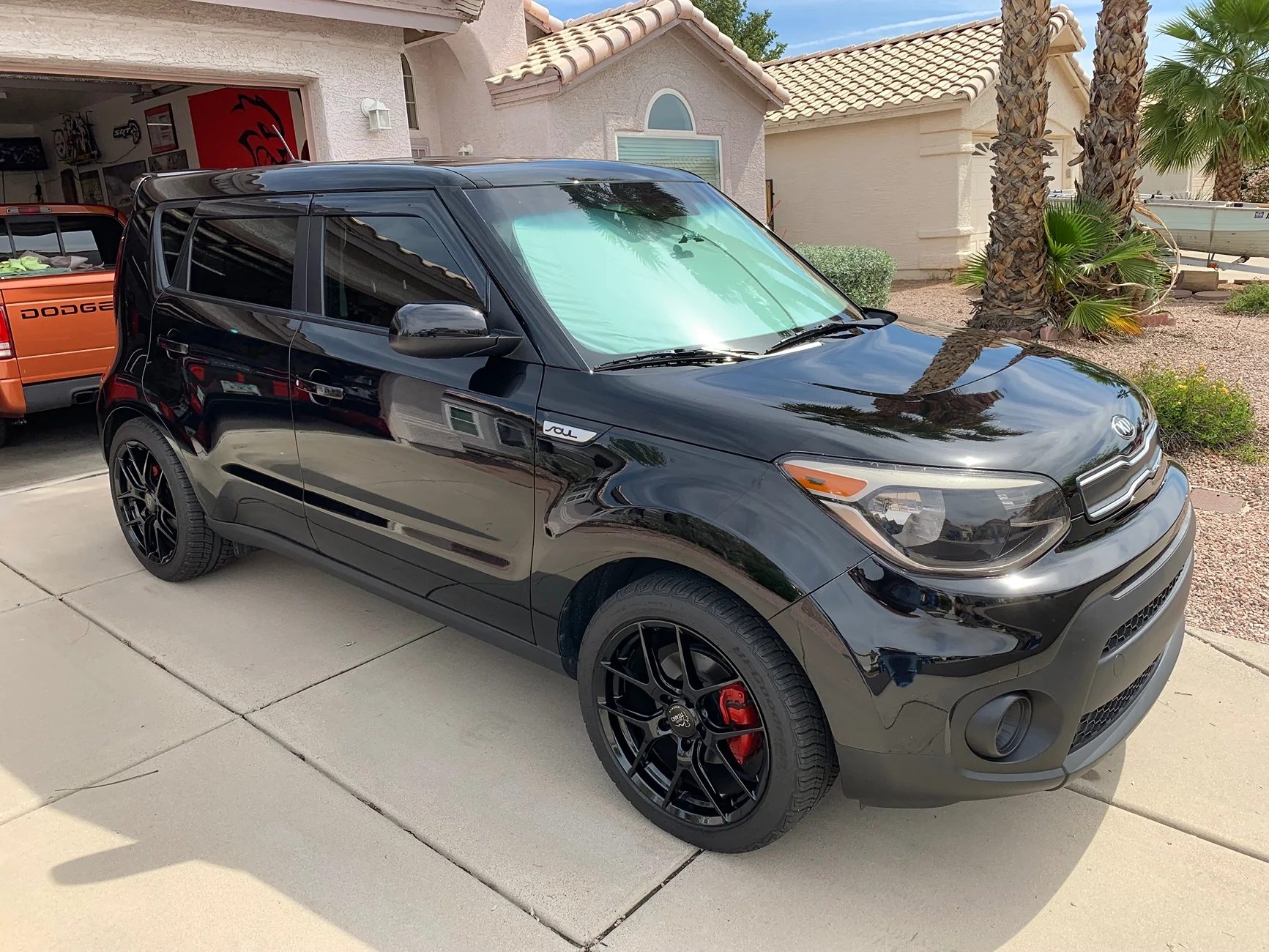

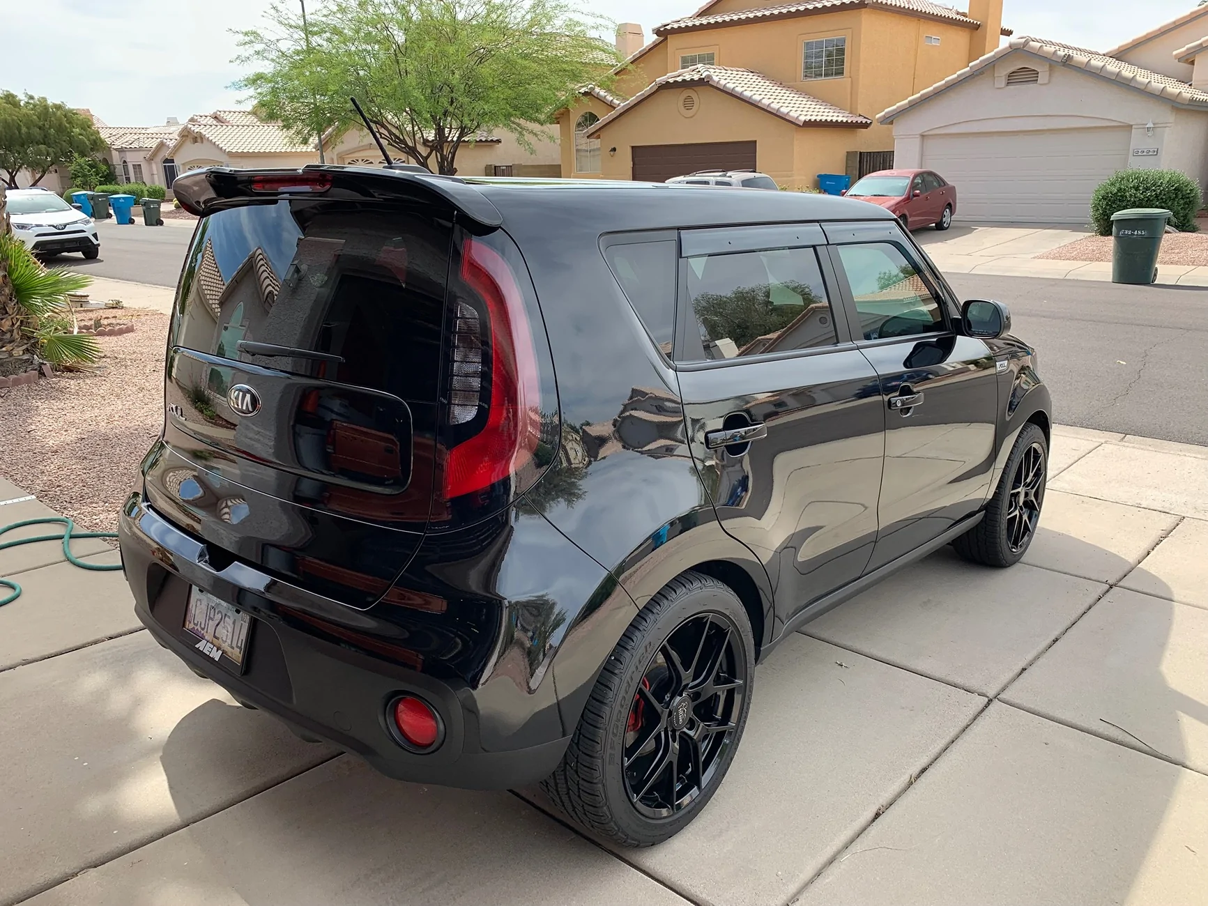

If you are using something other than the clear color, do you have any pictures to share? I am wondering how dark the "tint" really is and how it'd look with a black appearance package.
Not on my Ranger,but used it on a little Kia Soul I had as an airport beater car,and it was perfect.The pictures make it look lighter than it was to the eye.
But gave it a perfect amount of tint.

That does look really nice. Can you tell at night that your headlights are any less bright?
Funny enough,I work graves,but living in Phx,there’s street lights everywhere,so I really didn’t notice a difference,but I would imagine out in the country,it would definitely be less bright.
