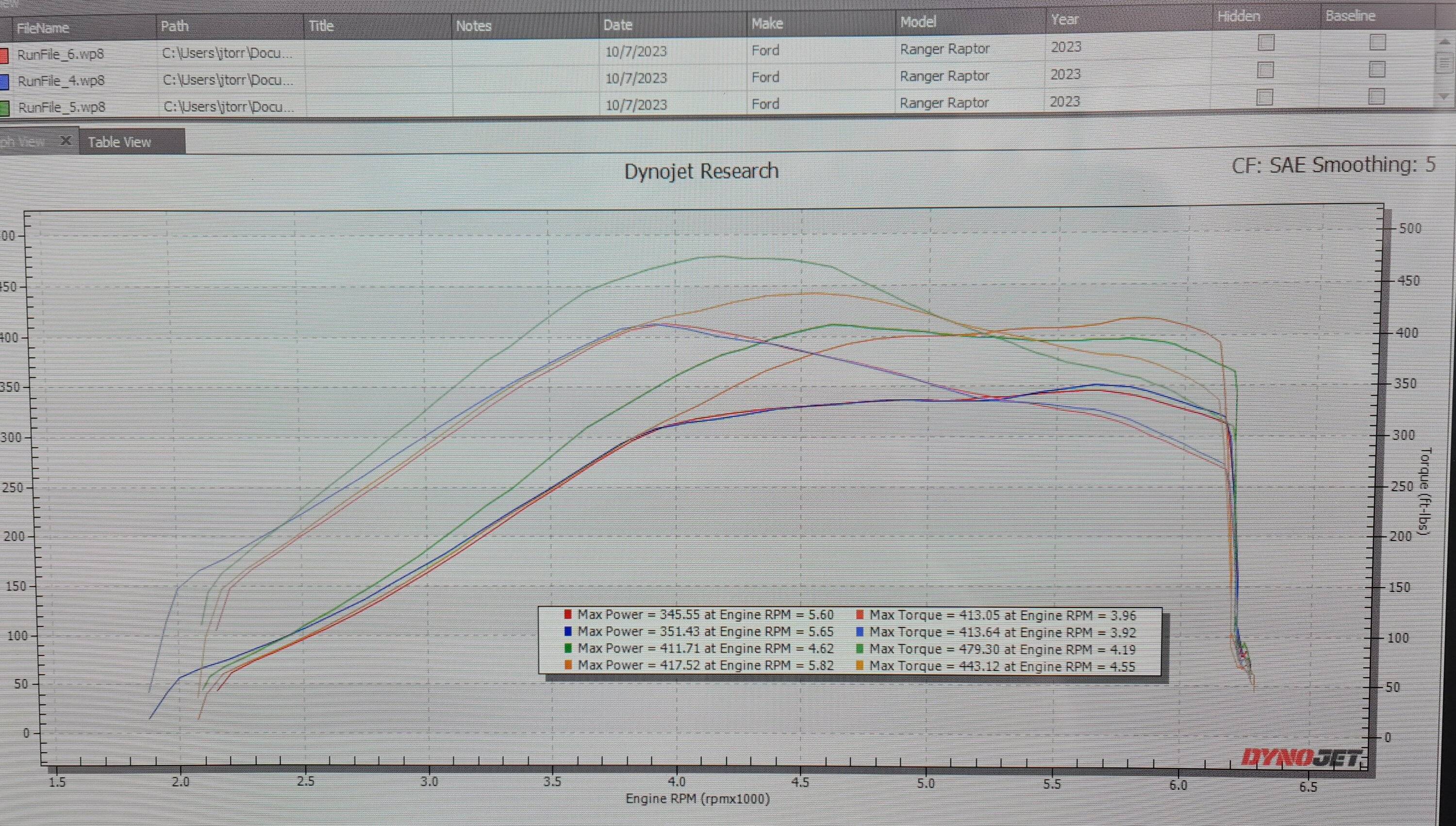

Yesterday I was able to take the truck to the dyno, gains were noticeable; from 345 whp & 413 wtq in the stock map to 417 whp and 479 wtq in the highest boost map with meth.
I did all runs in 4th gear, as we didnt want the tires to go too high on speed to orevent overheating and loose too much rubber at the dyno.

Nice numbers !!

I realized later that I used the exhaust in sport mode, never tried the output in full open mode, or in baja mode.

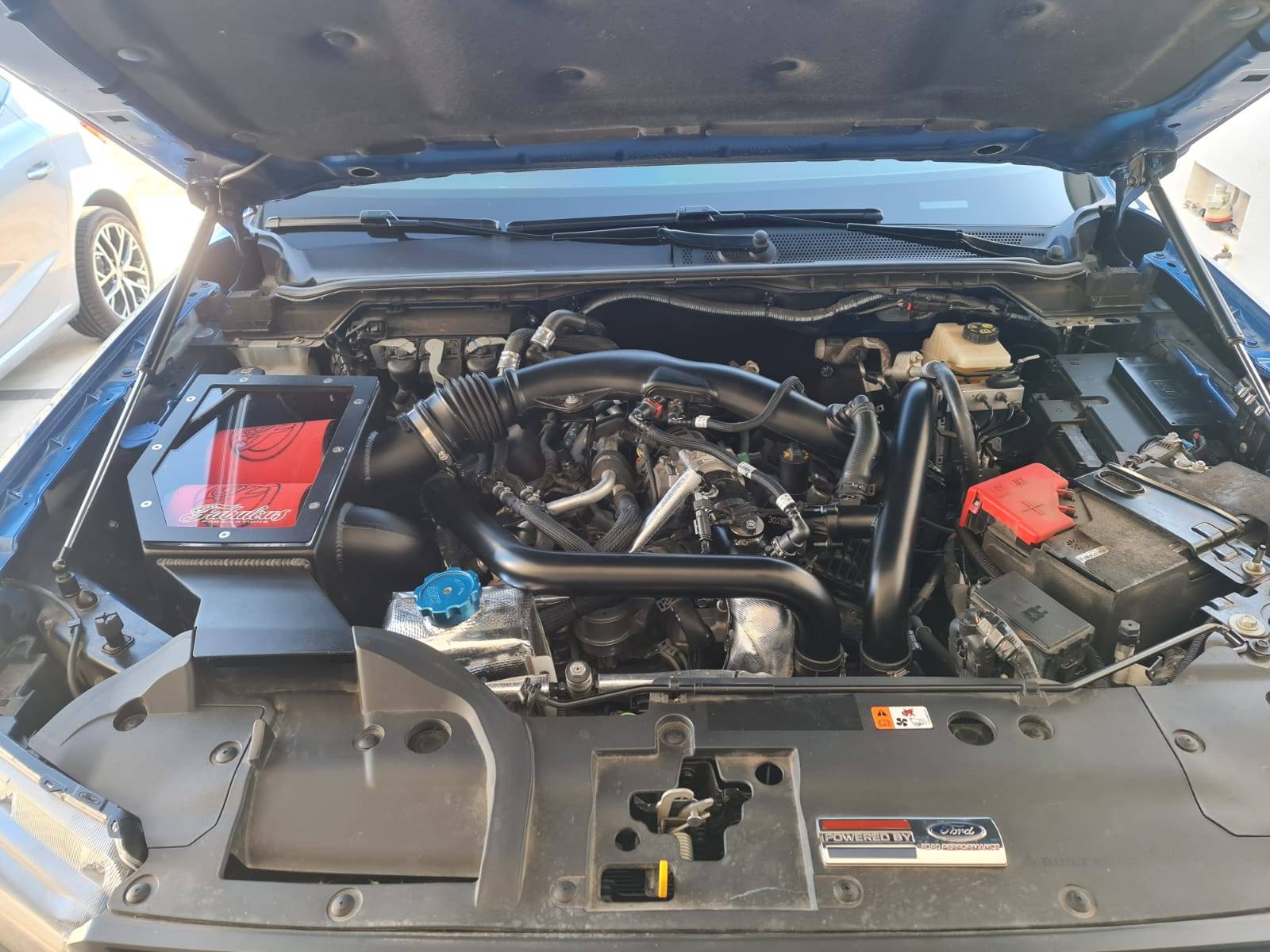

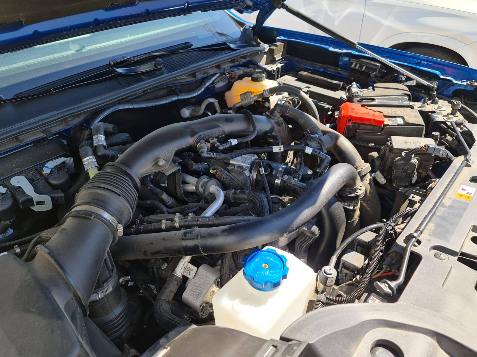

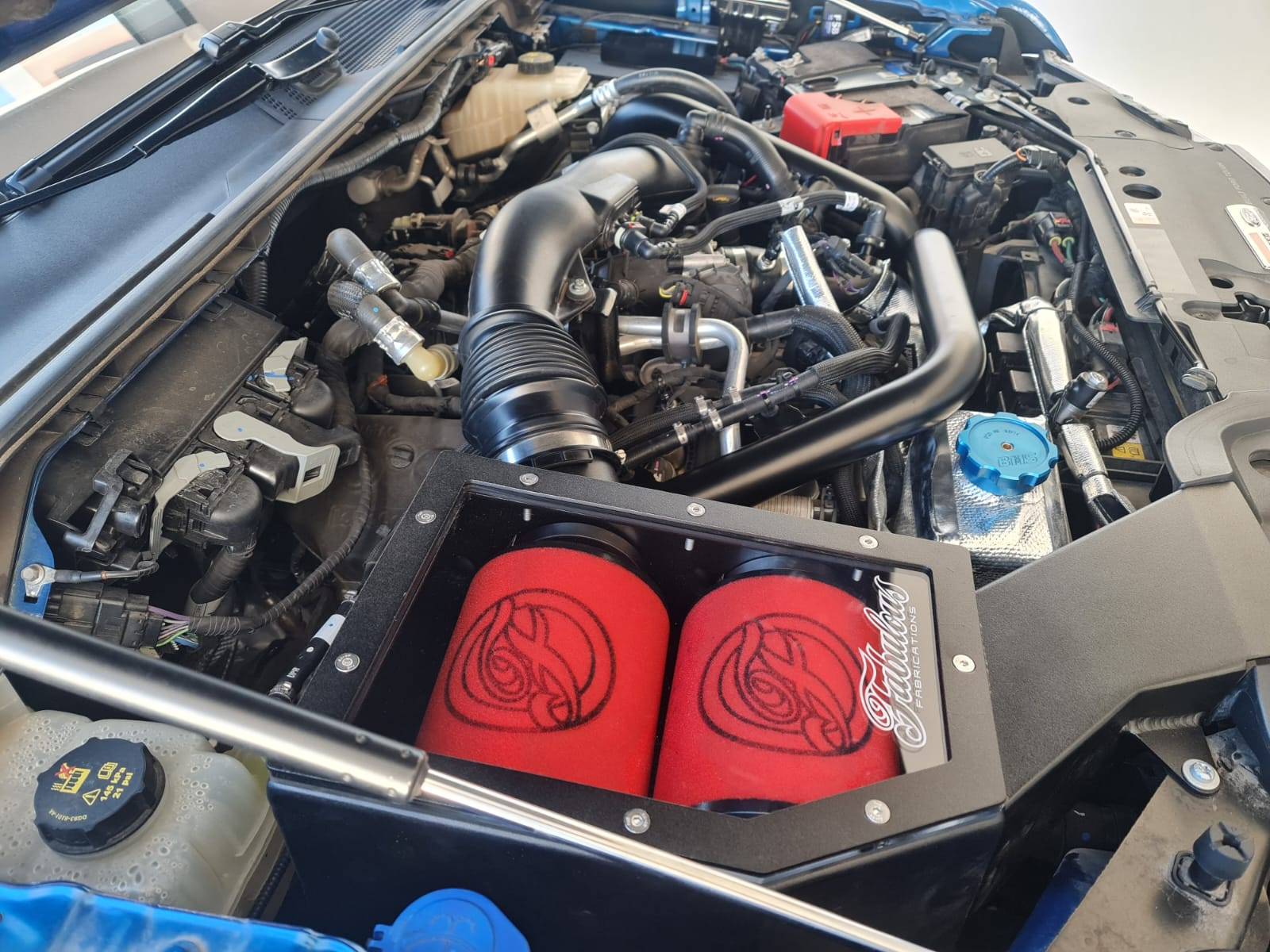

I finally installed my larger intercooler and intake. They look awesome. In theory the intercooler is 40% larger, it was considerable larger than the stock unit, also a lot heavier, I hope that allows for better heat transfer, they advertise 20 degrees celsius less than the stock unit.
Will take it to the dyno after christmas, in January, to see the gains.

Which intercooler did you go with? Fenix? Dynomotive?
