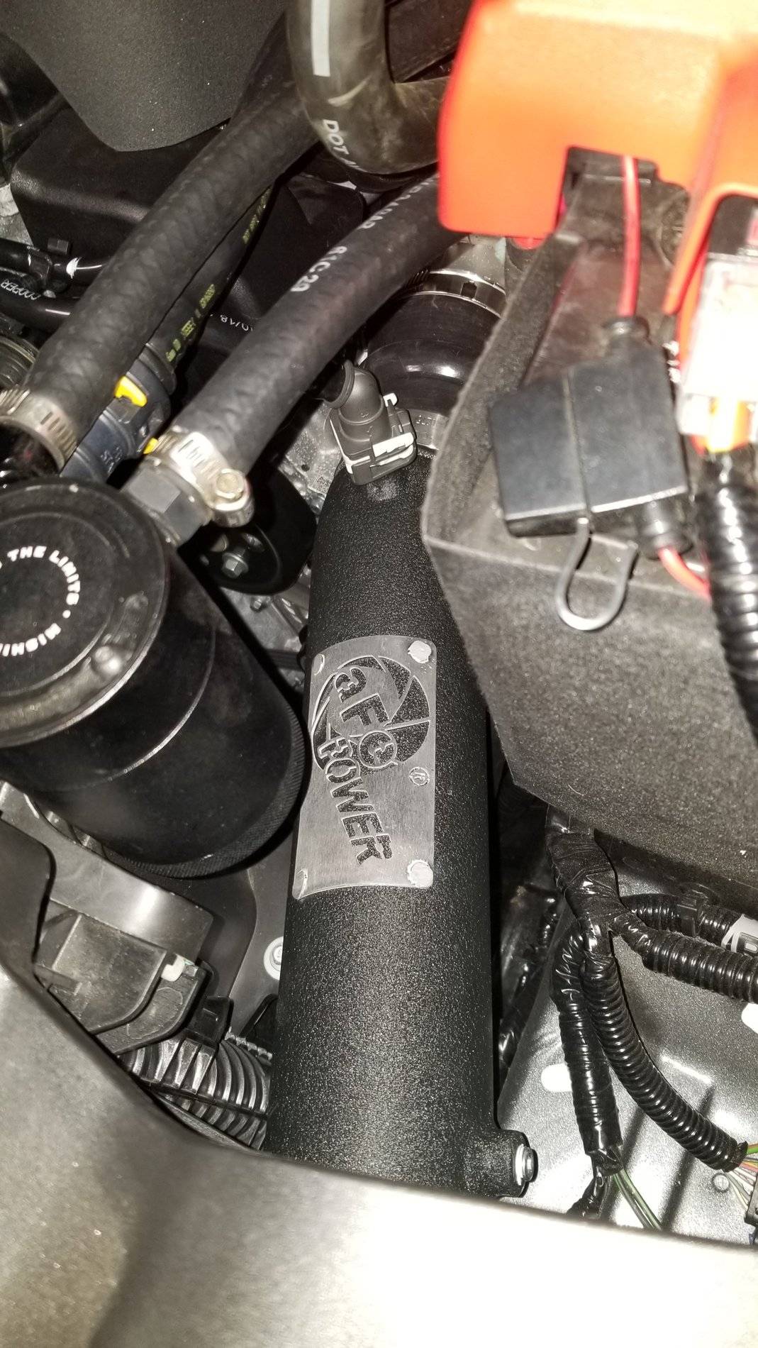

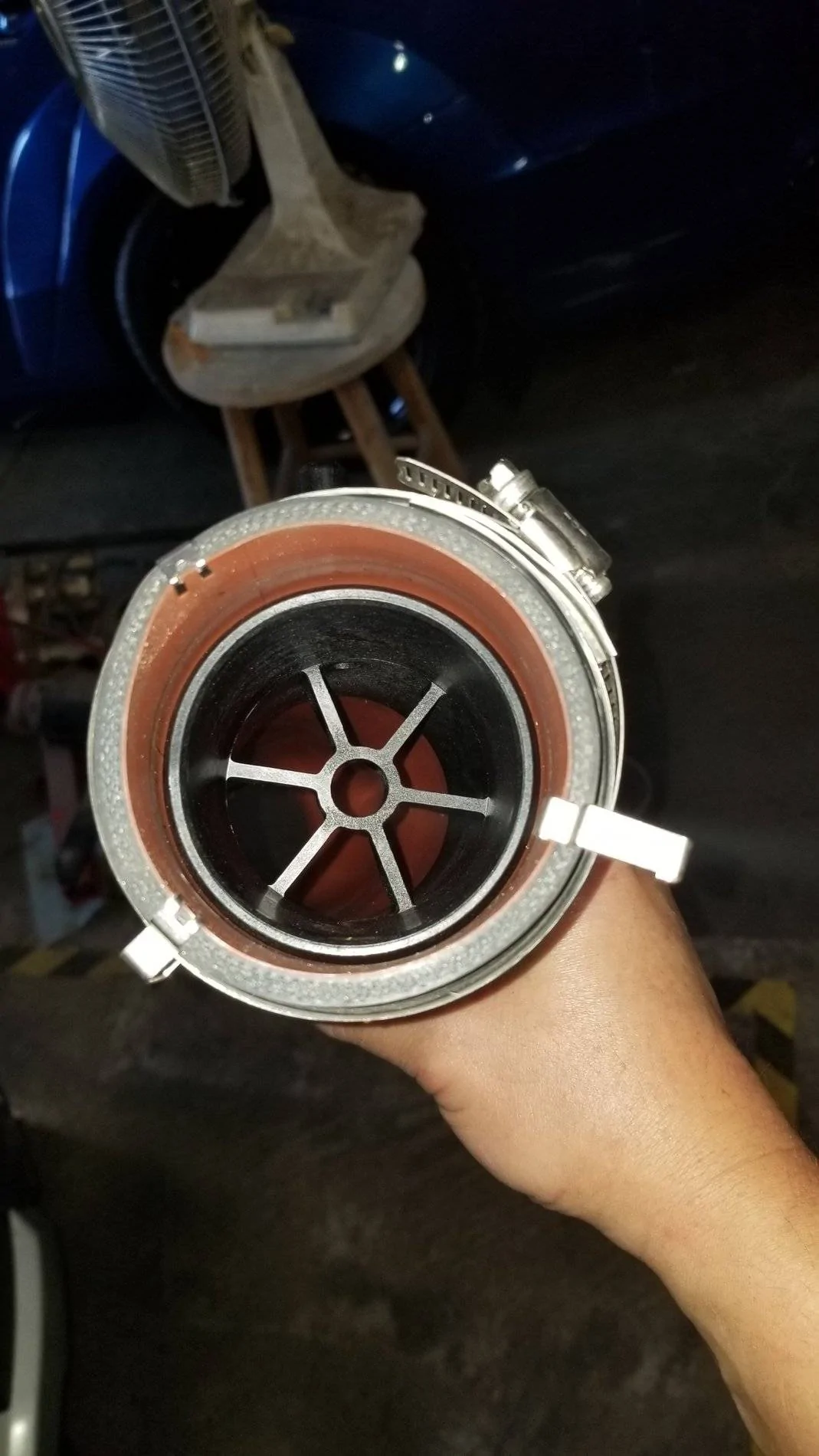

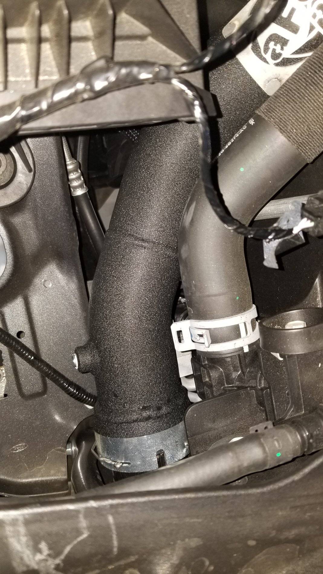

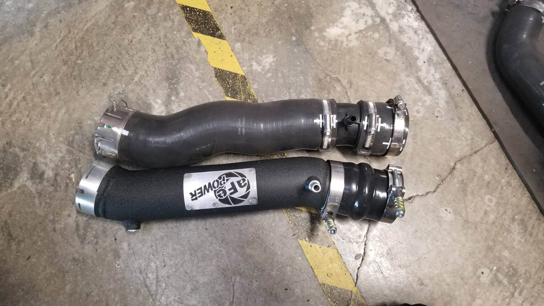

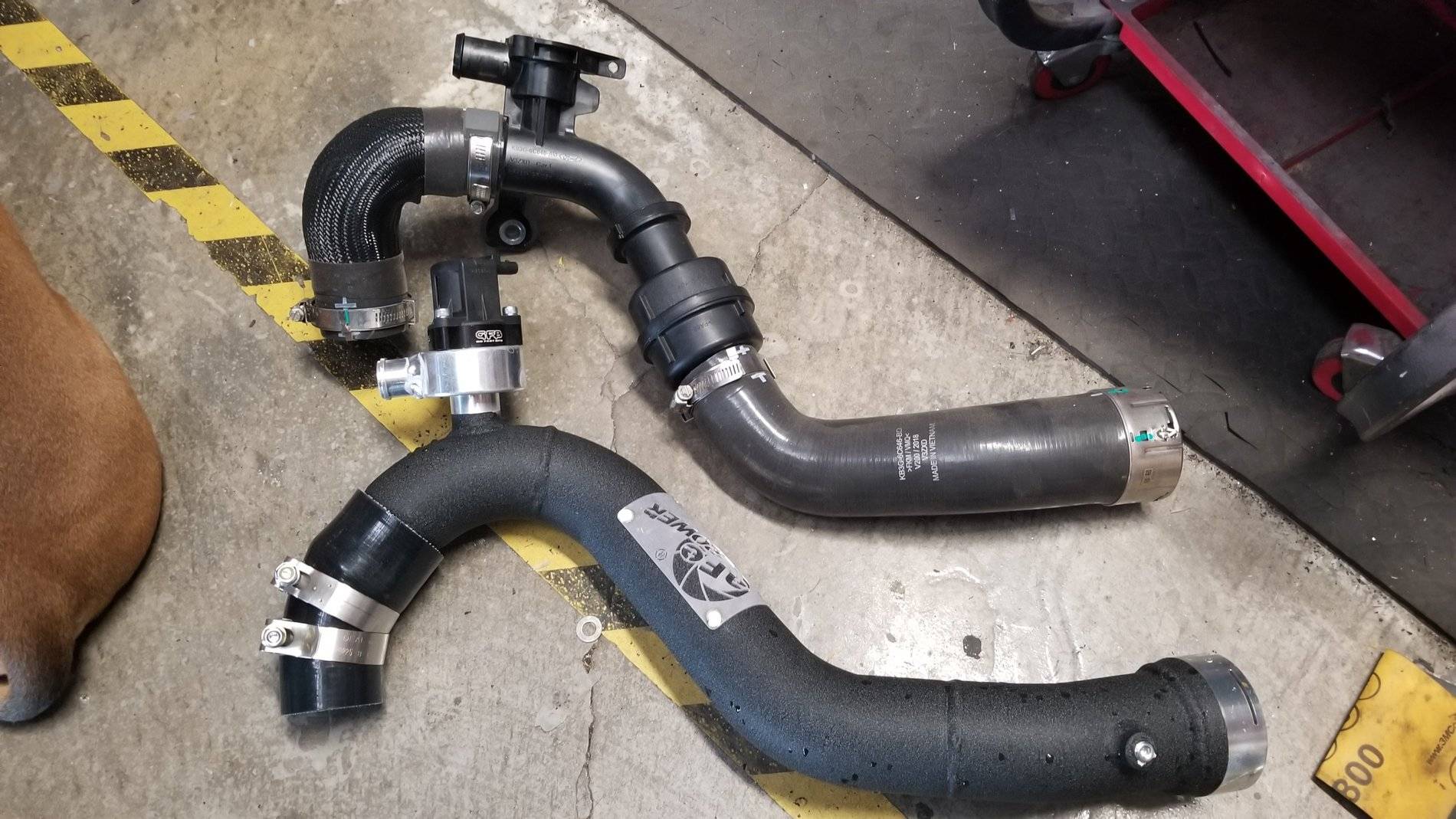

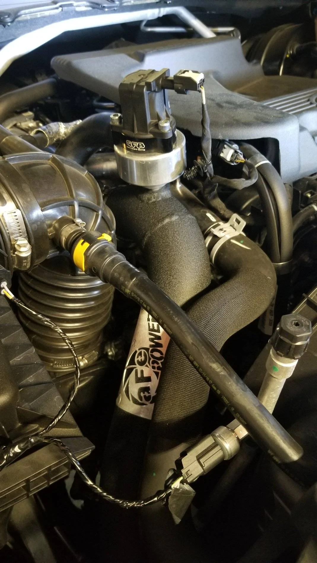

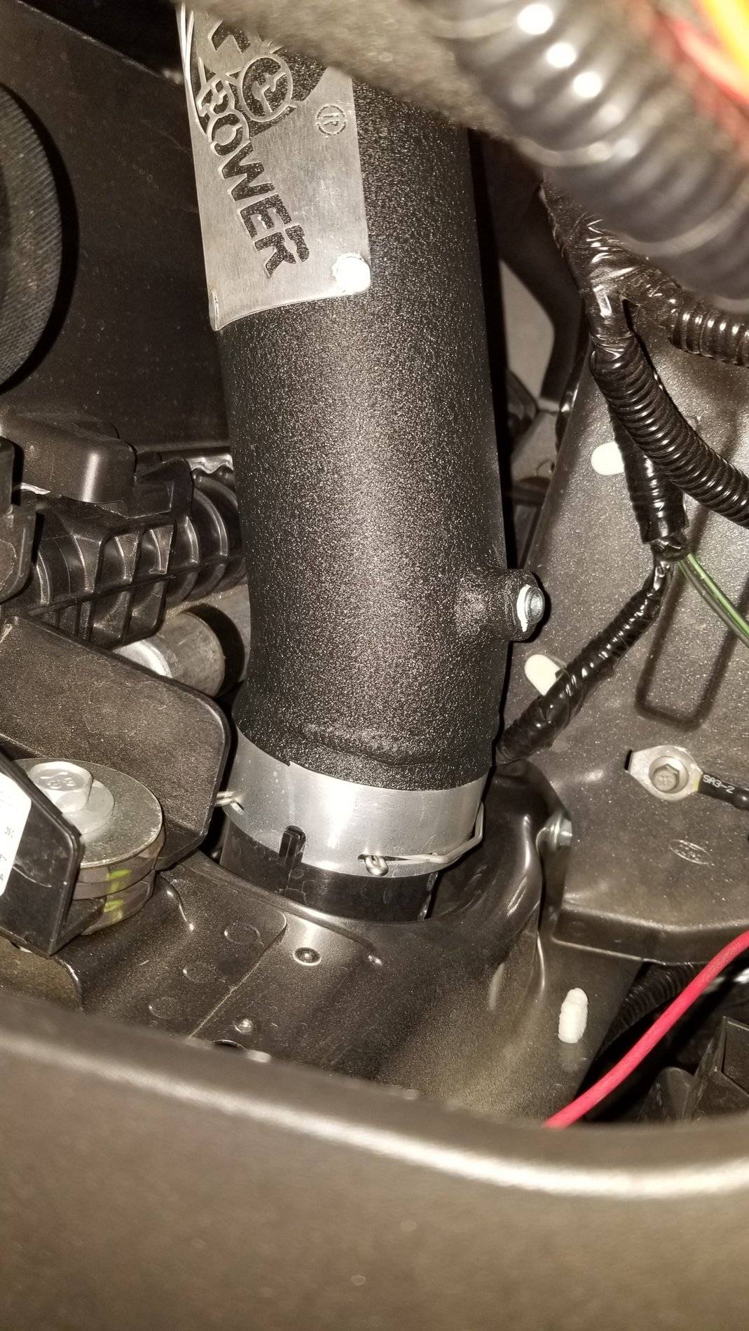

Charge pipes installed. Probably not much gain on the intercooler to throttle body but definitely on the turbo to intercooler side. Reused the stock clamp on the throttle body as it was almost impossible to install the clamp included. Also a restriction in the large pipe with the turbulence vanes or whatever you want to call them. I checked and with the GFB DV+ it just barely clears the underhood insulation.

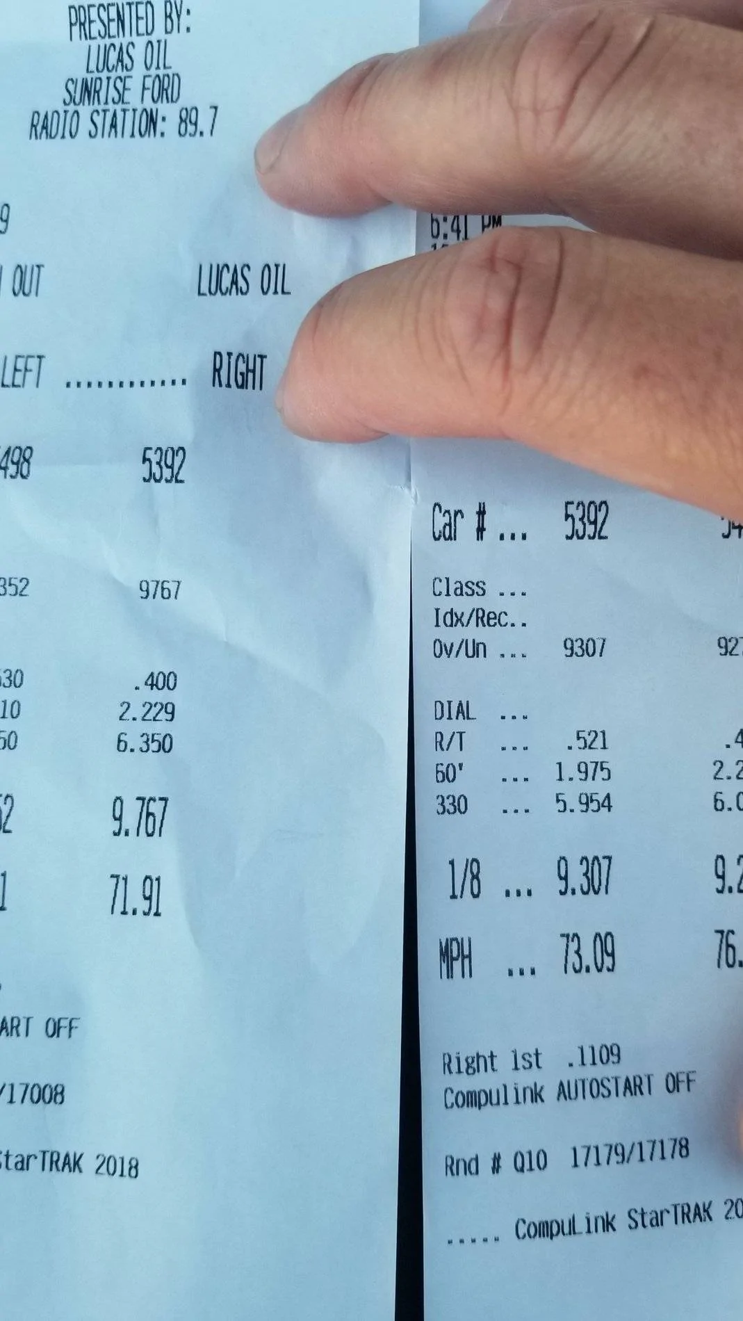

Almost a half second with 87 octane Unleashed tune 87°f.
I installed mine last night...got the hot side on thinking that was the harder one to tackle...the cold side was a bear and you're right, no way to use their clamps...all just TOO SMALL. The electric connector on GFB does touch the liner as I can see a slight print. Would've been nice if AFE had a choice of RED wrinkle paint to stand out but I'm happy too...:clap:

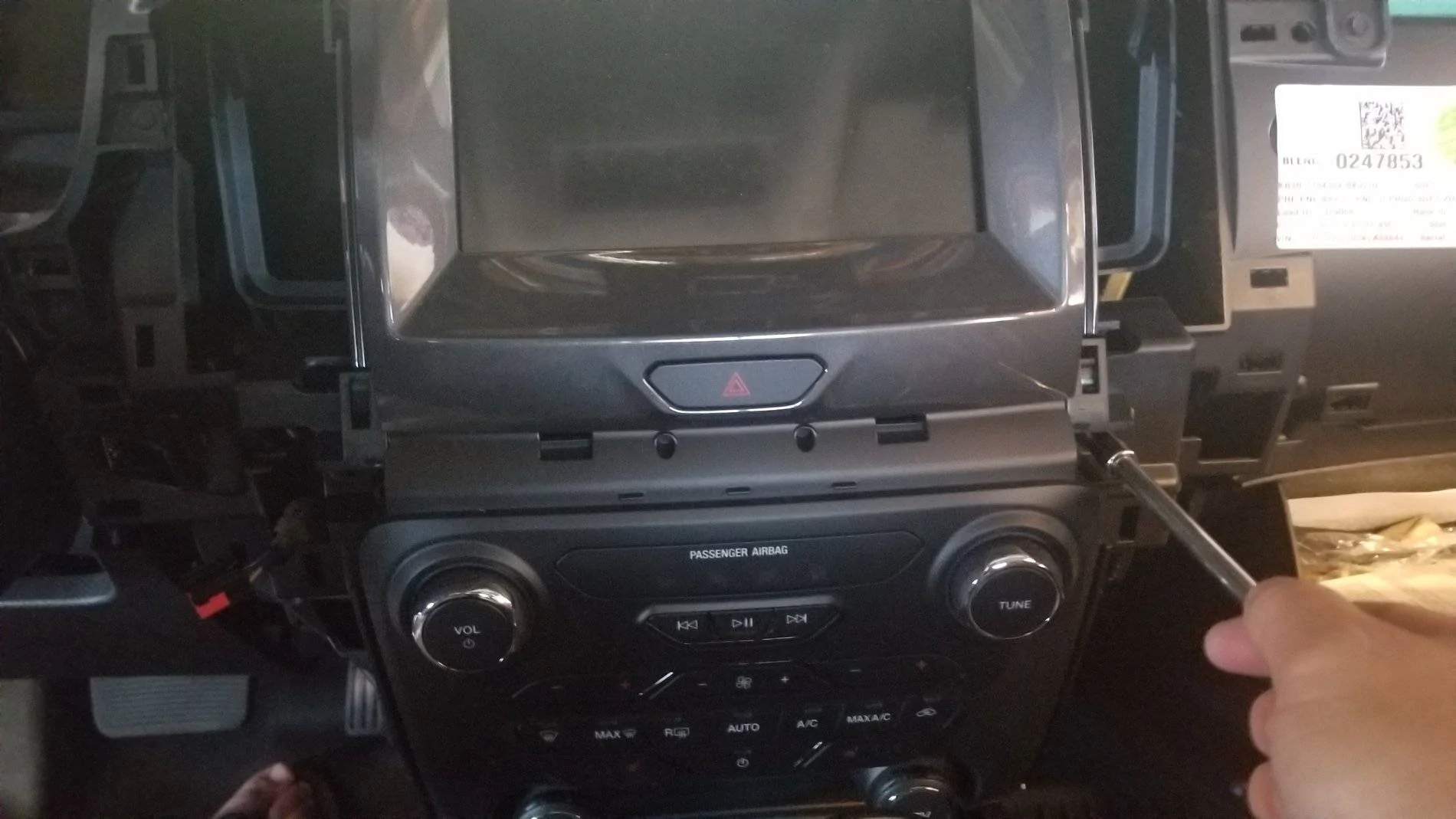

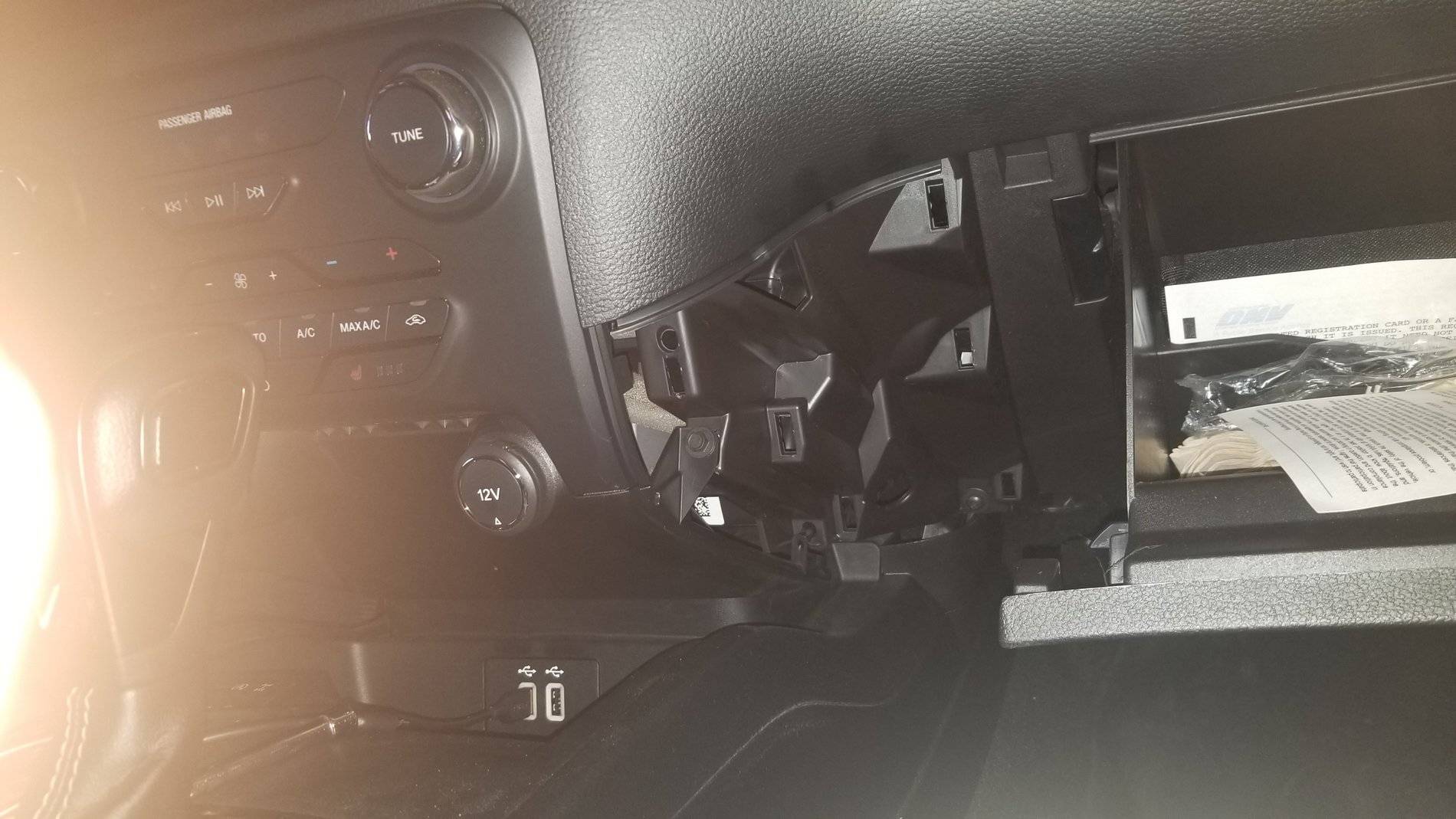

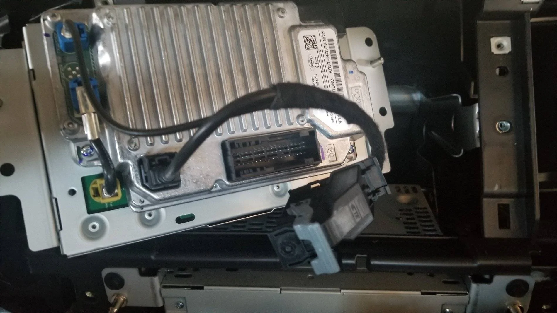

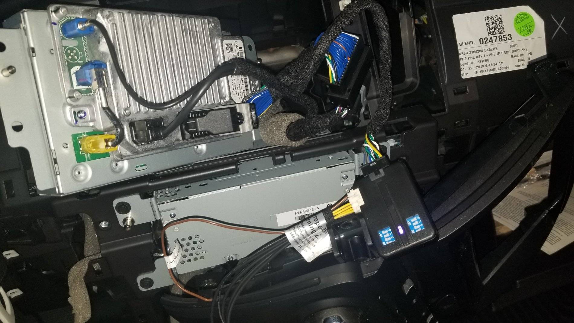

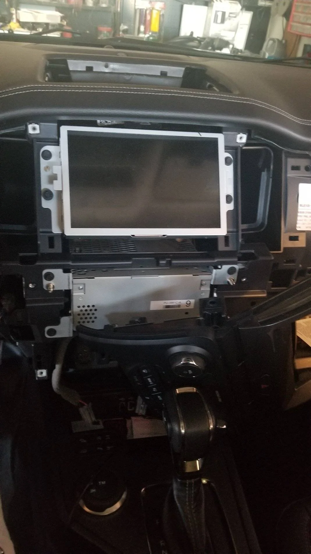

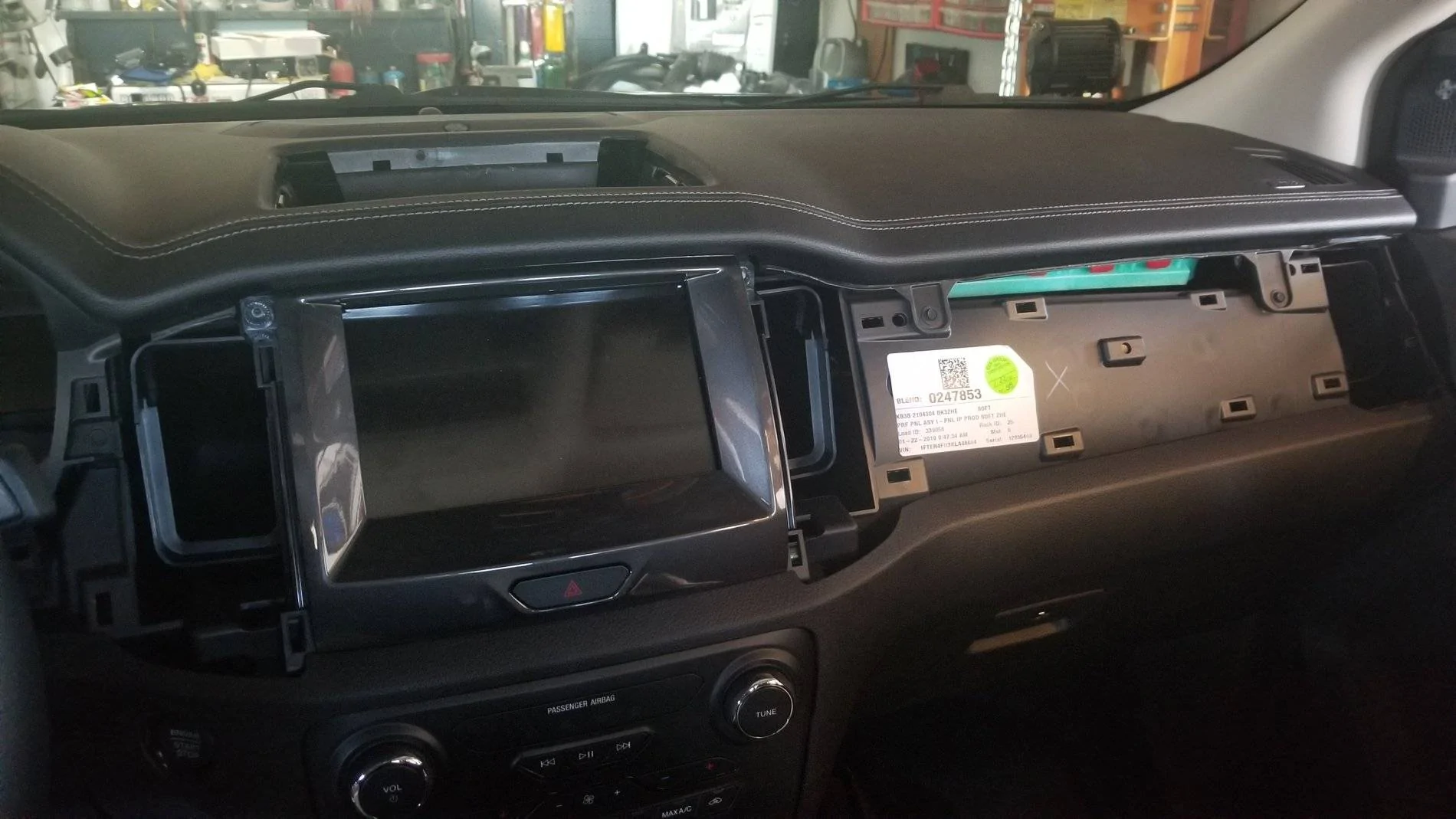

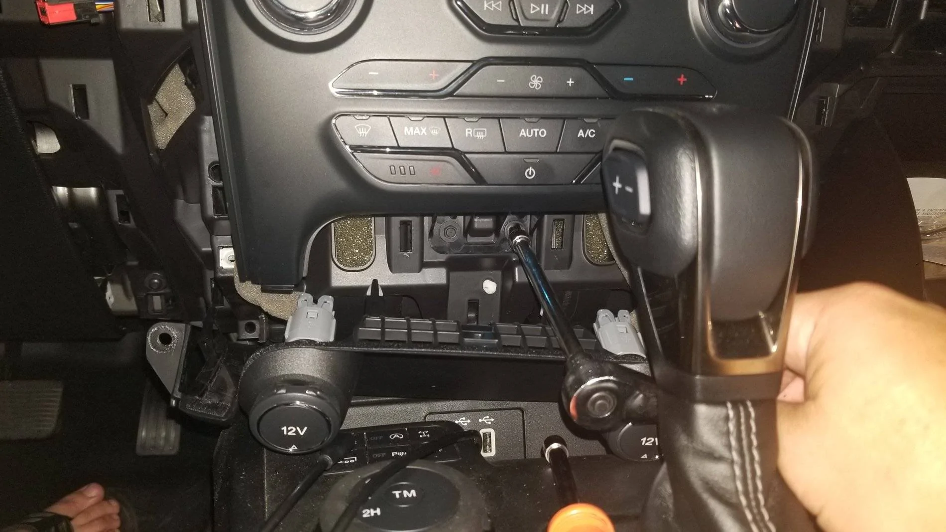

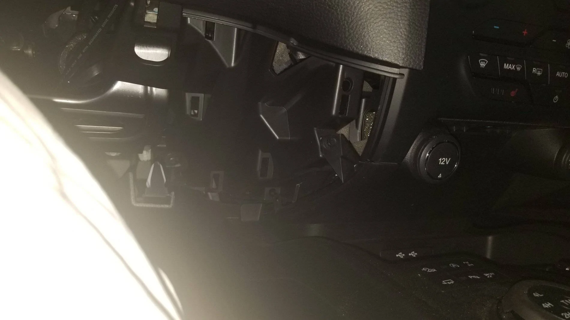

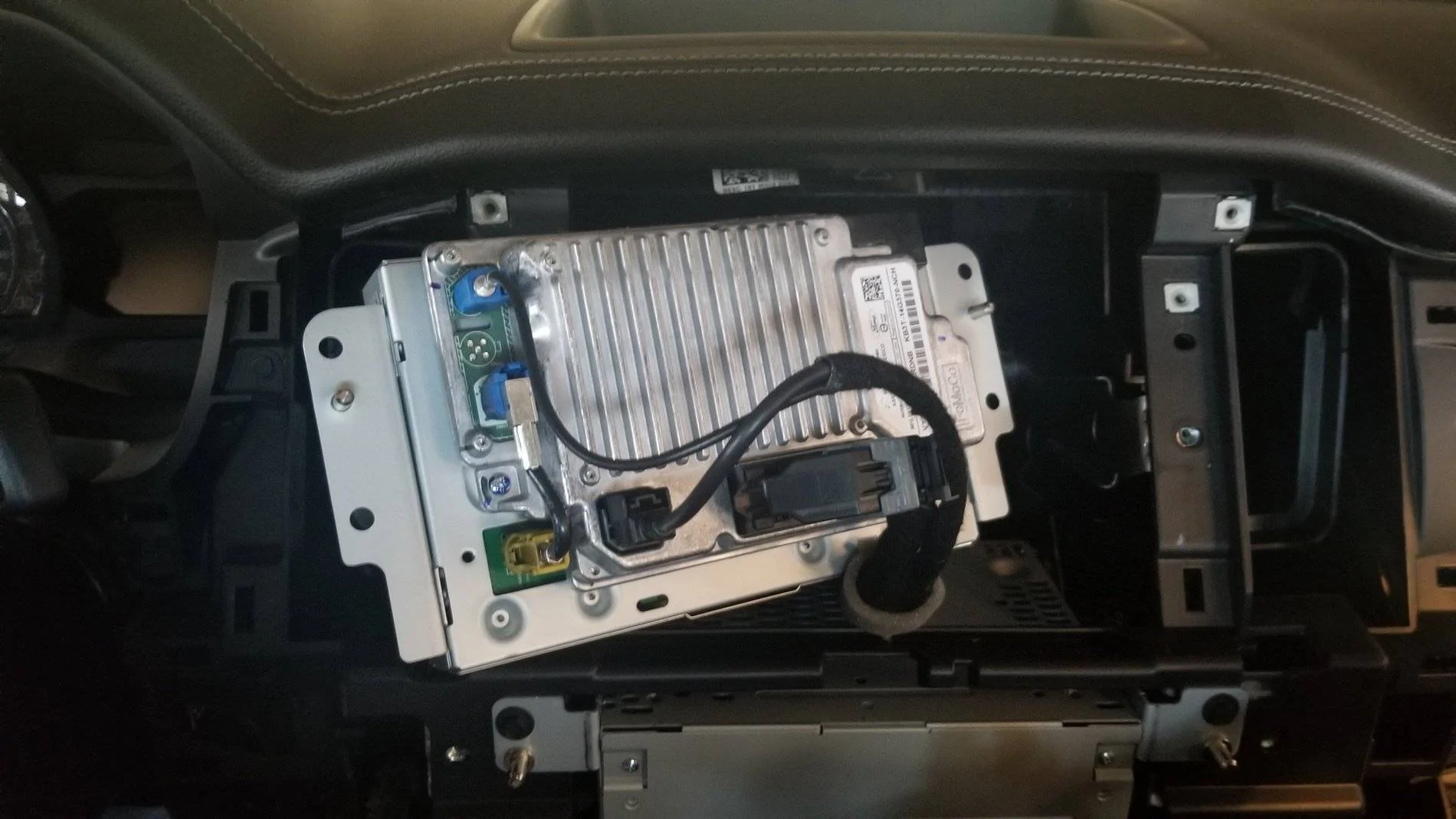

4 way camera integration module. This module allows adding both front and side cameras to the stock SYNC 2 or 3 system. I didn't order a camera yet because I wasn't sure it would be compatible. You can manually toggle the front and rear camera manually with the radio power button. When it functions automatically the front comes one once it the radio fully boots up and you shift into neutral or drive and then shuts off above 7 mph, the sides activate when toy hot the turn signals and reverse as normal in reverse.
Lower the volume on this one the music on this one as the satellite was cutting on and off in the garage.

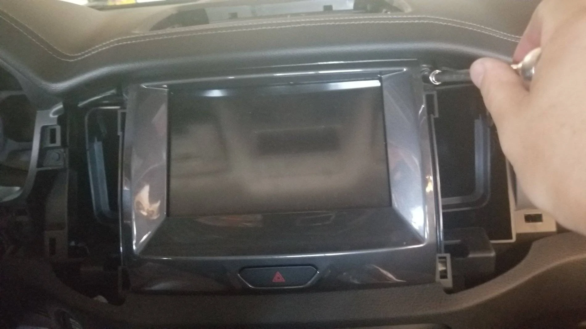

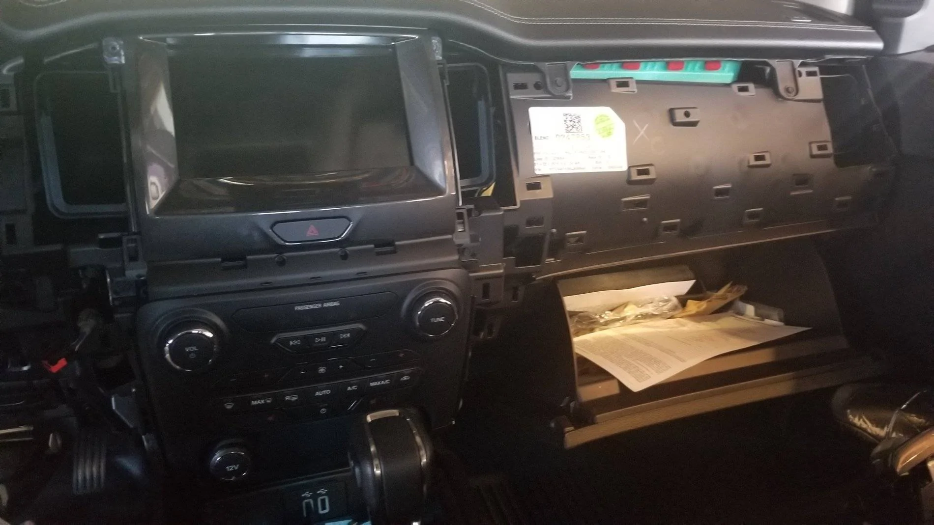

Install required removing all these panels just to get to the APIM. Simply plugs in between the harness. Run the wires for the camera and make the connections. I'll be looking for a decent front camera next and then buttoning everything up.
