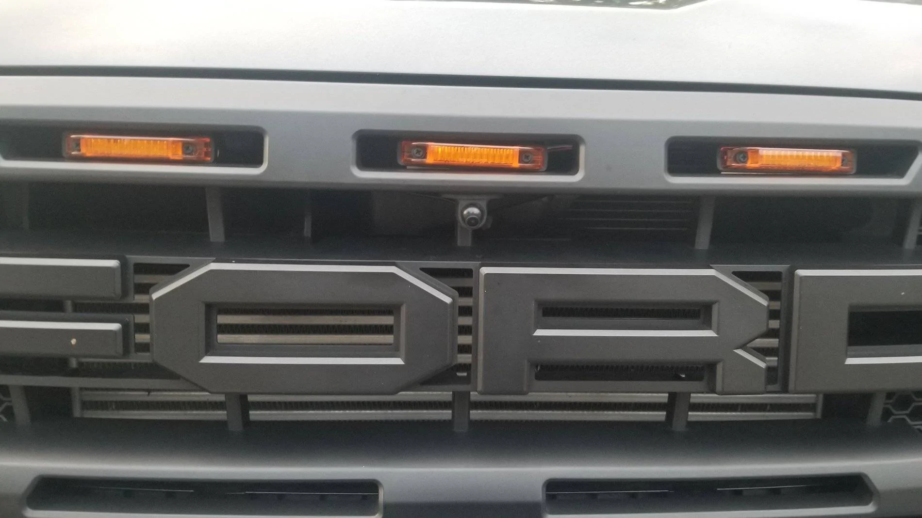

Could you please list the part numbers for your camera and the module you used and how you installed the camera to the front of the Ranger.
Thanks
RCMUSTANG
RCMUSTANG
Ray
Jan 22, 2019
1,513
540
Los Angeles
1989 Mustang 2017 Fusion
https://www.amazon.com/Multi-Camera...coding=UTF8&psc=1&refRID=H6RM04XZ9S349Z9G025S
Cameras are really up to you. There's a ton of styles. But this is what I used. I changed up the wiring to make running the cable through the grommet eaiser. I had a spare 4 pin wire cable. The rca cable it comes with is too much of a chore to get through the grommet. I went through the harness grommet on the passenger side. I just routed the cable from the camera through the engine compartment next to the airbox and under the expansion tank into the grommet into the cab.
https://www.amazon.com/RAAYOO-Unive...coding=UTF8&psc=1&refRID=041E4Y25E6H3207D13KV
Here's a pic of the camera mounted.

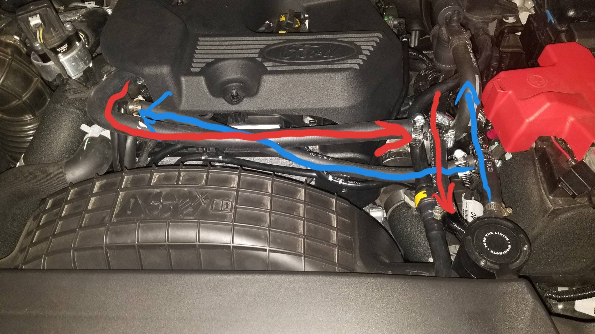

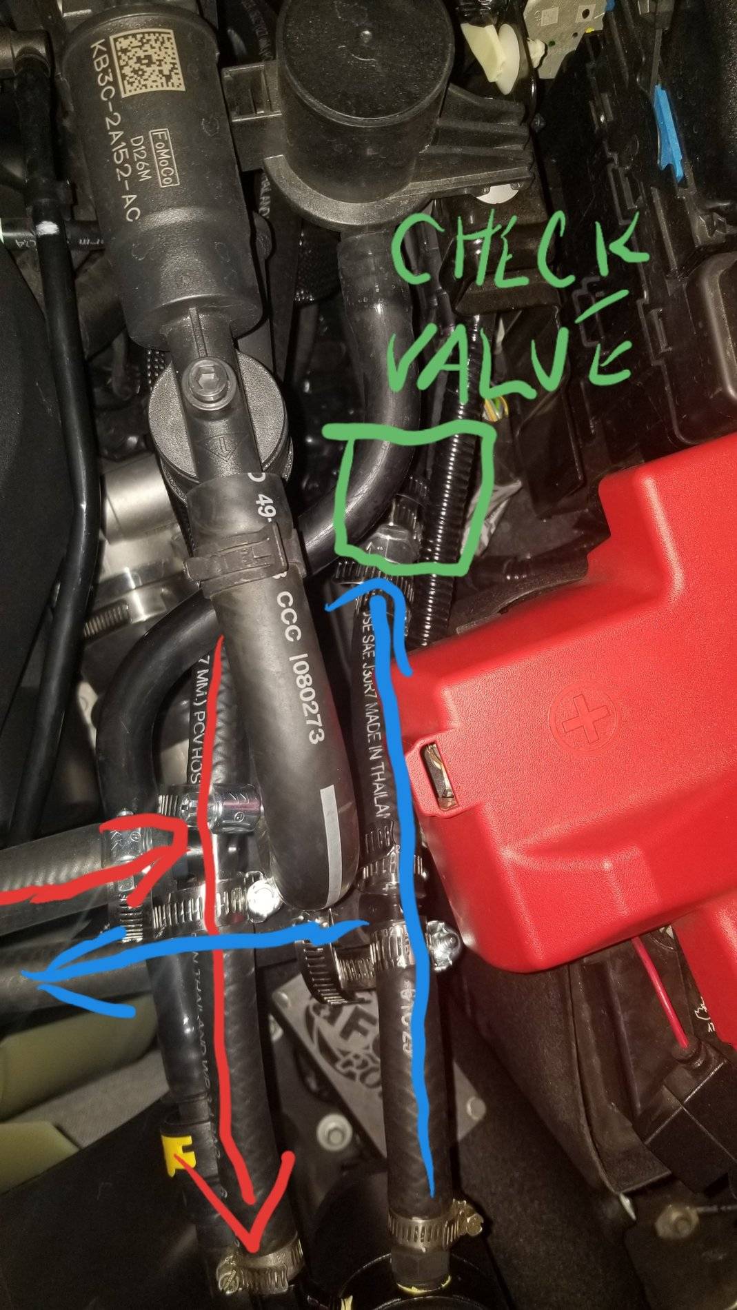

Update on the oil catch can. I made it so that the single can will work on the breather side as well.
Air flow directions to and from the can.
Ford Ranger RCMUSTANG's Magnetic FX4 20190809_153947
Placement of the one way check valve back to the intake. That way boost won't start pushing back into the can in the opposite flow direction.
Ford Ranger RCMUSTANG's Magnetic FX4 20190809_154154

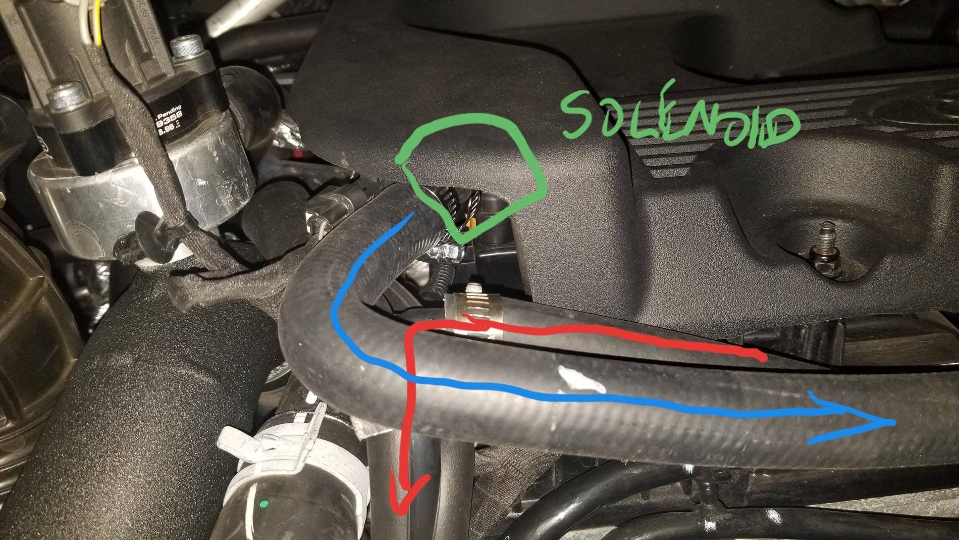

Breather side. Once vacuum goes away and the vent solenoid opens it now pulls through the can from the valve cover into the intake side of the turbo.
Ford Ranger RCMUSTANG's Magnetic FX4 20190809_154126
Thanks for posting that. Question: is the solenoid the electrical piece that is already in the breather line? Or is it something you added? Thanks.
It's stock.

It's stock.
OK I thought that was a flow sensor of some sort. I guess it's not. One more quick question: The hose connector on the valve cover side of the breather tube seems different than the others (at least on our truck) and I haven't yet been able to find the quick release mechanism. Was yours like that too?
Thanks
I believe it opens up when under boost to allow it to vent as the pcv closes. I gave up on releasing it and dealt with it attached.
LOL! At least I'm not the only one. I'll probably end up doing the same. Better than trying to force it and breaking it, or even worse breaking the male mating connector on the valve cover. My guess is that there must be a special service tool for releasing it unlike the other ones which are QR.

Eventually I'll ask my buddy at the dealer.

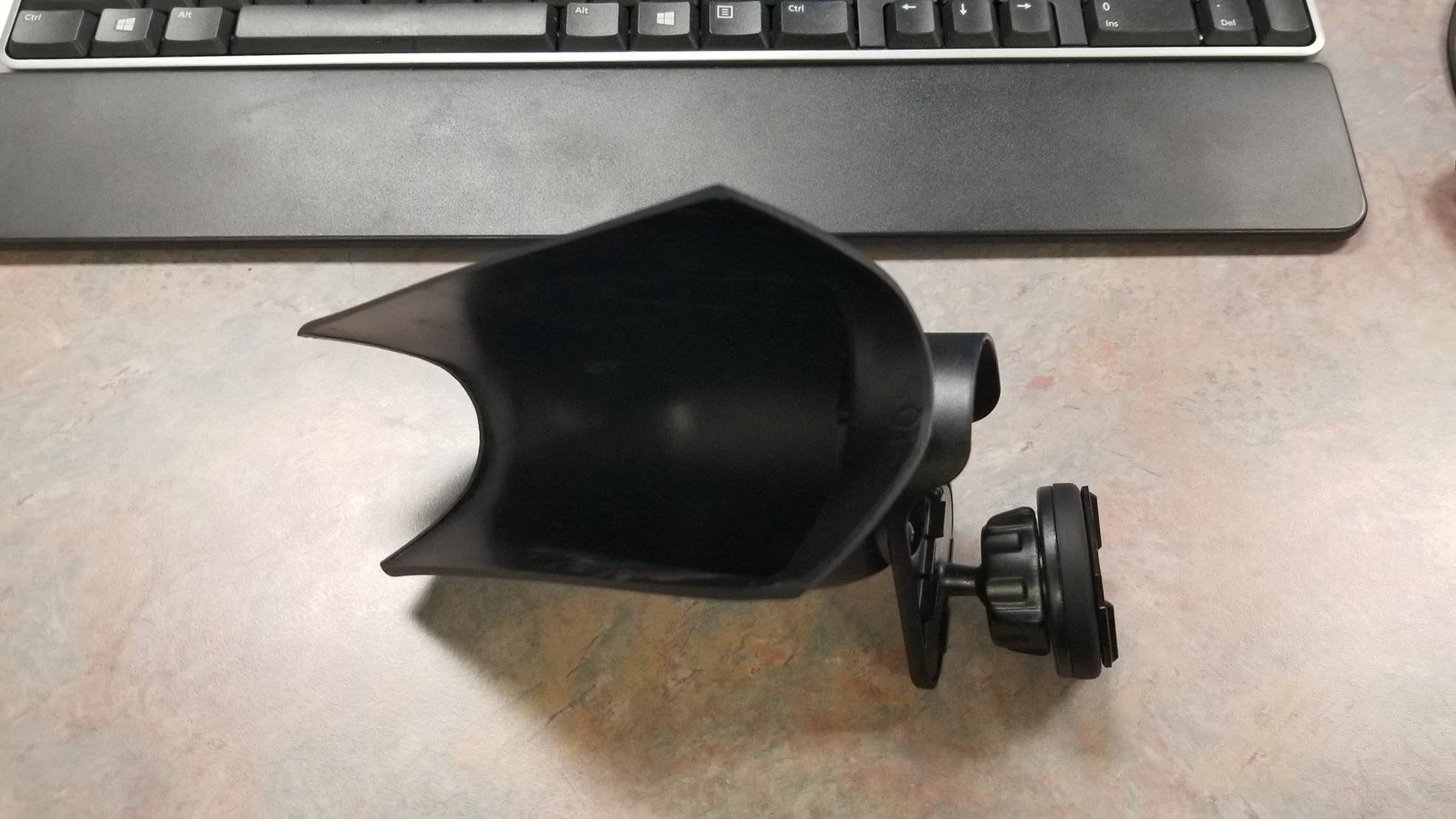

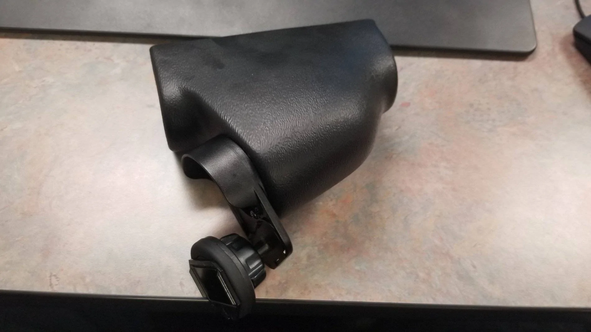

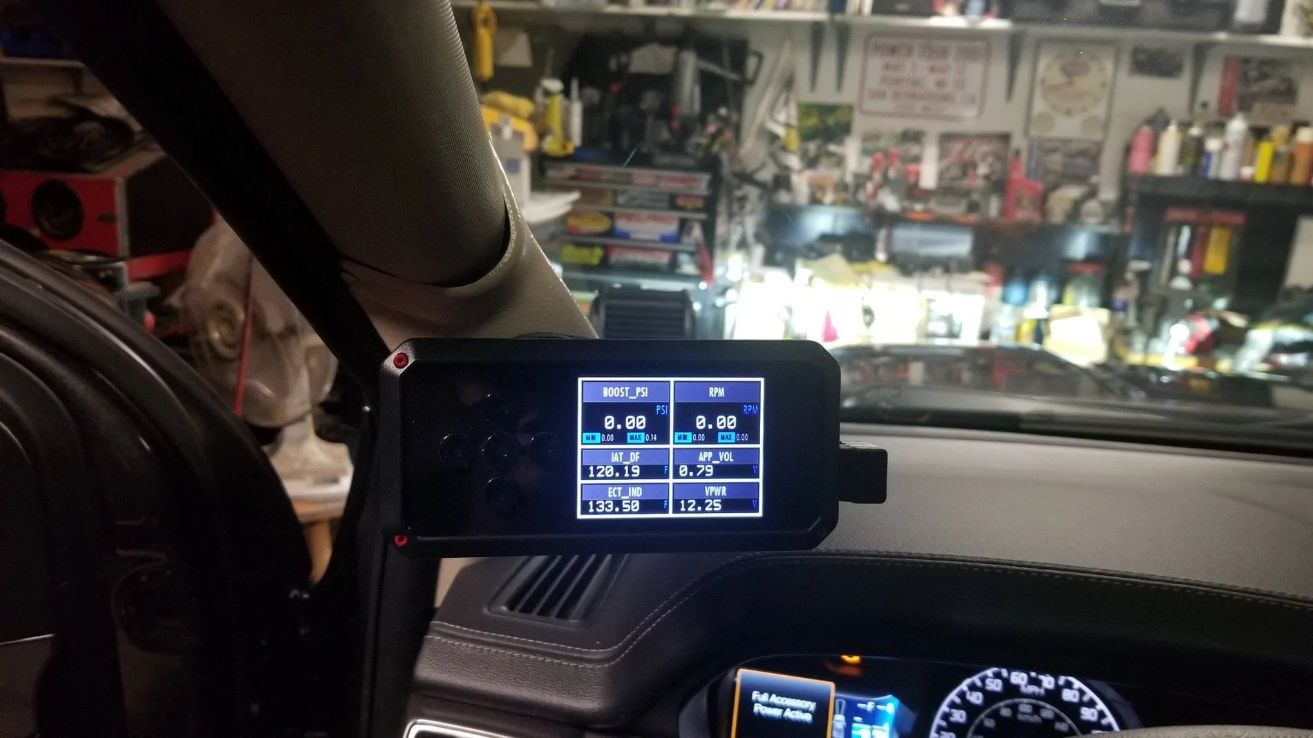

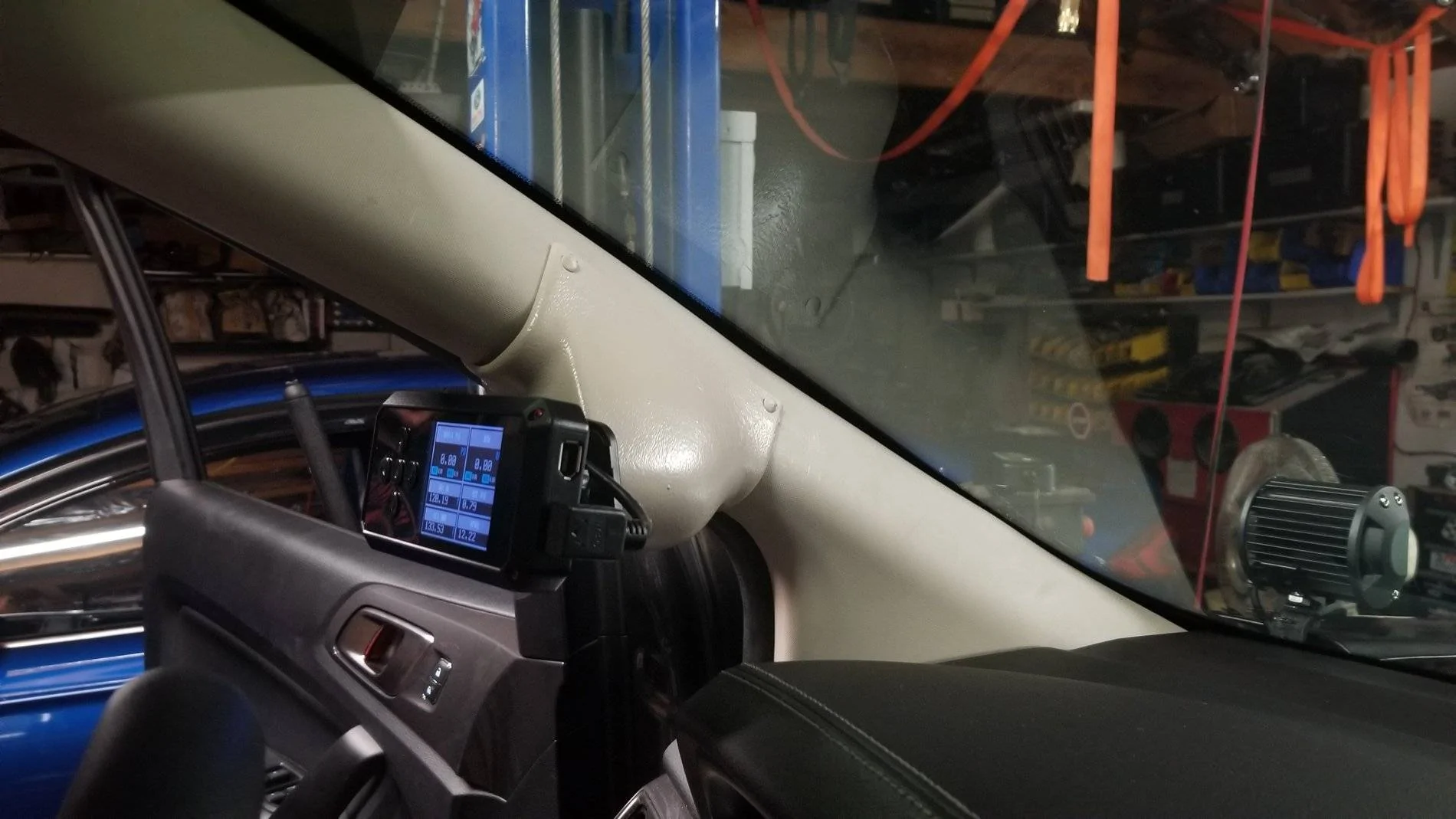

Found a close enough A pillar pod mount with adapter for the BDX tuner.
Ford Ranger RCMUSTANG's Magnetic FX4 20190815_202006
Ford Ranger RCMUSTANG's Magnetic FX4 20190815_202001
Ford Ranger RCMUSTANG's Magnetic FX4 20190815_181351
Ford Ranger RCMUSTANG's Magnetic FX4 20190815_180442
Ford Ranger RCMUSTANG's Magnetic FX4 20190815_093557
Ford Ranger RCMUSTANG's Magnetic FX4 20190815_093537
Ford Ranger RCMUSTANG's Magnetic FX4 20190815_093531

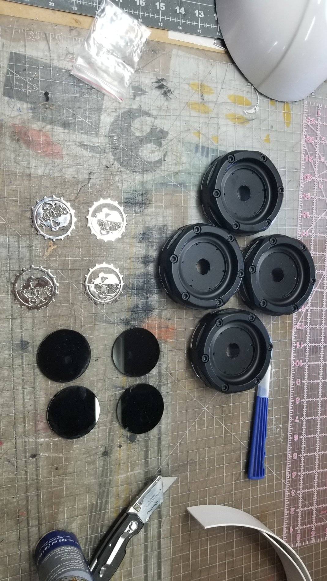

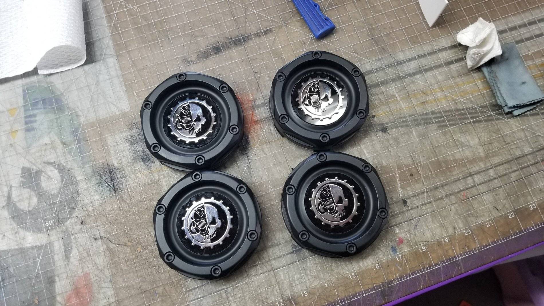

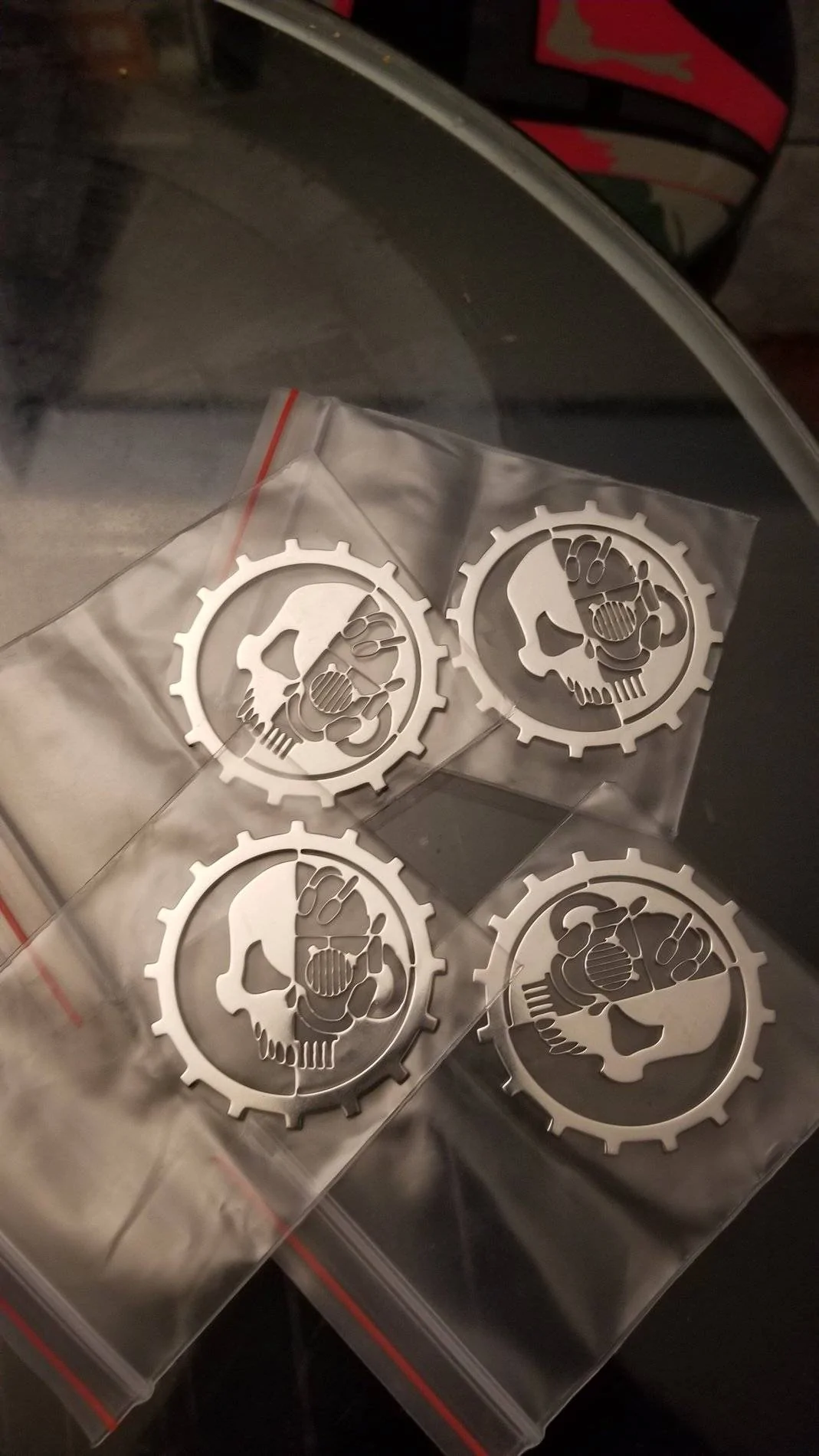

Finally for the emblems and finishes modifying the Fuel Shok center caps.
Ford Ranger RCMUSTANG's Magnetic FX4 20190821_151143
Ford Ranger RCMUSTANG's Magnetic FX4 20190821_162758
Ford Ranger RCMUSTANG's Magnetic FX4 20190821_173957
