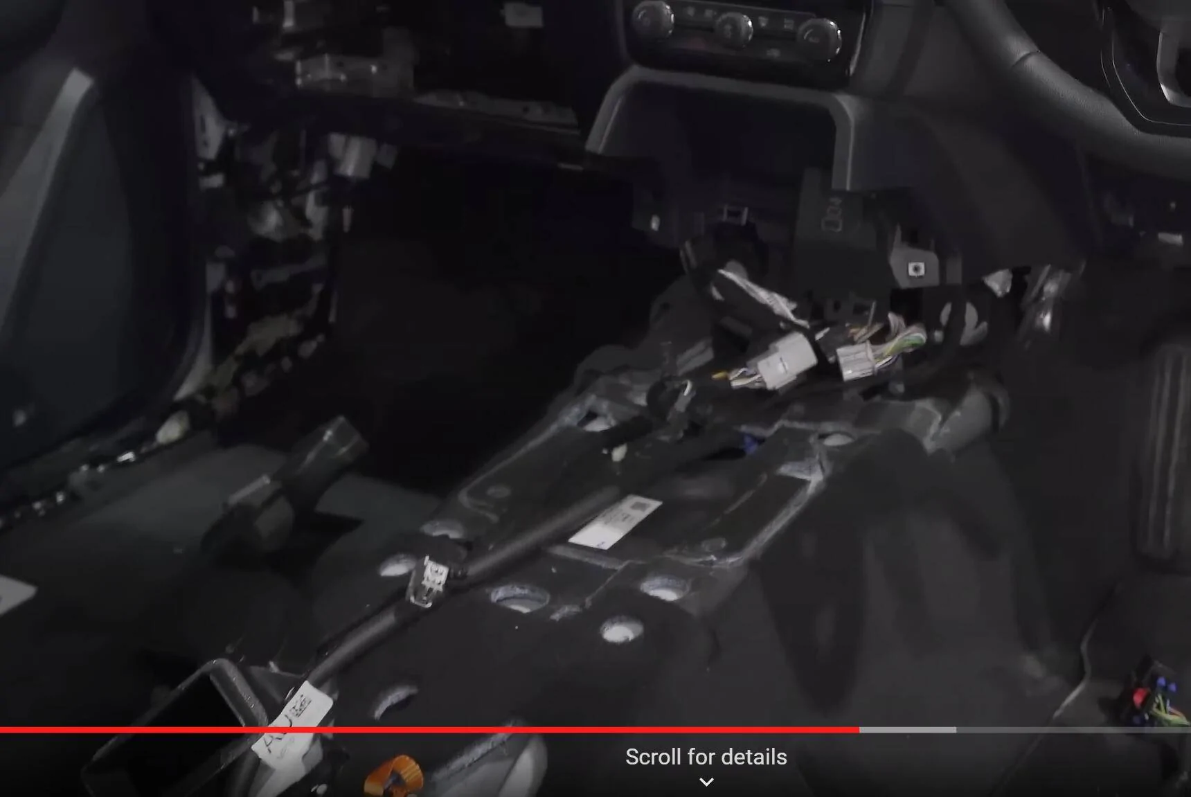

You can see in this screen grab from a youtube teardown of a ranger in Australia that there is a path molded under the console for a duct to run.

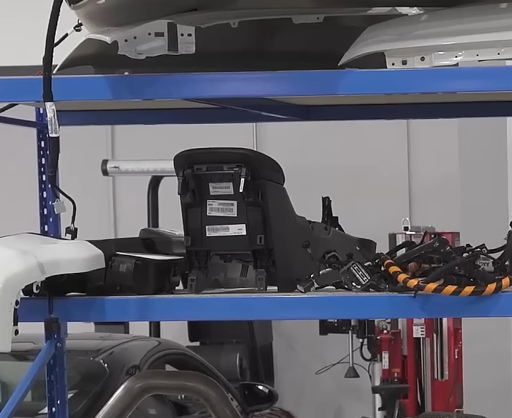

In the second screen grab there is a duct laying on the floor next to the trans tunnel that may be the duct they use on the global models.

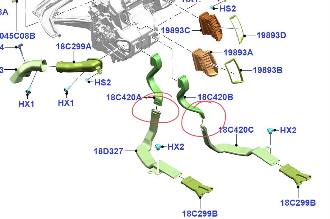

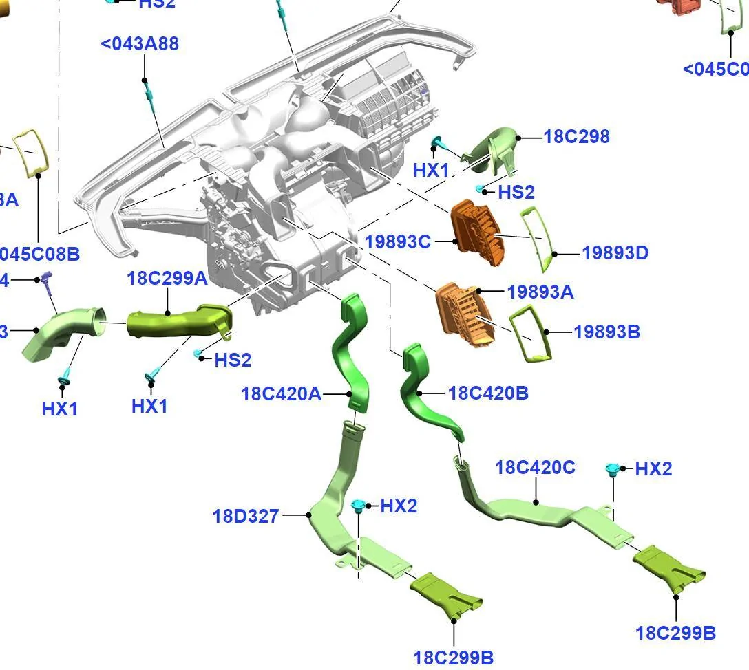

On the previous gen there are two ducts that connect to the center of the heater core box and run down the side of the tunnel under the front seats for air. That's likely how the US 6g ranger is configured. Those ducts are probably plugged into the same spot the center console one would go into and will need to be moved.
If someone outside the US has access to parts diagrams for the new rangers they could confirm. Otherwise we'll have to wait until the US one releases and the parts retailers upload the new exploded diagrams.
The biggest hang-ups will be Ford using a different heater core case for the US spec (unlikely) or the parts being directional, meaning you'd have to import parts from a LHD vehicle for it to fit the US console.
