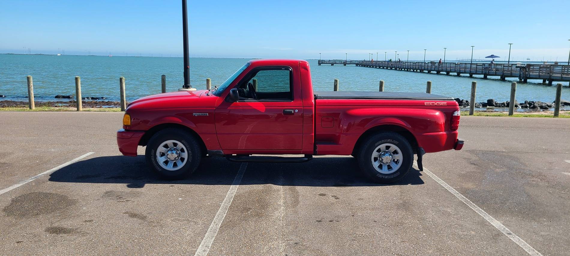

Flipping the hangers should only be around 2, maybe 3. I did that on my 04 ranger but that requires grinding the rivets off and using bolts to remount the spring hanger to the frame.
Moving the spring from above the axle to under is like a 5 inch drop
768
543
Aircraft examiner
Ford Ranger Rear end lowering? IMG_1393
This was stock height
