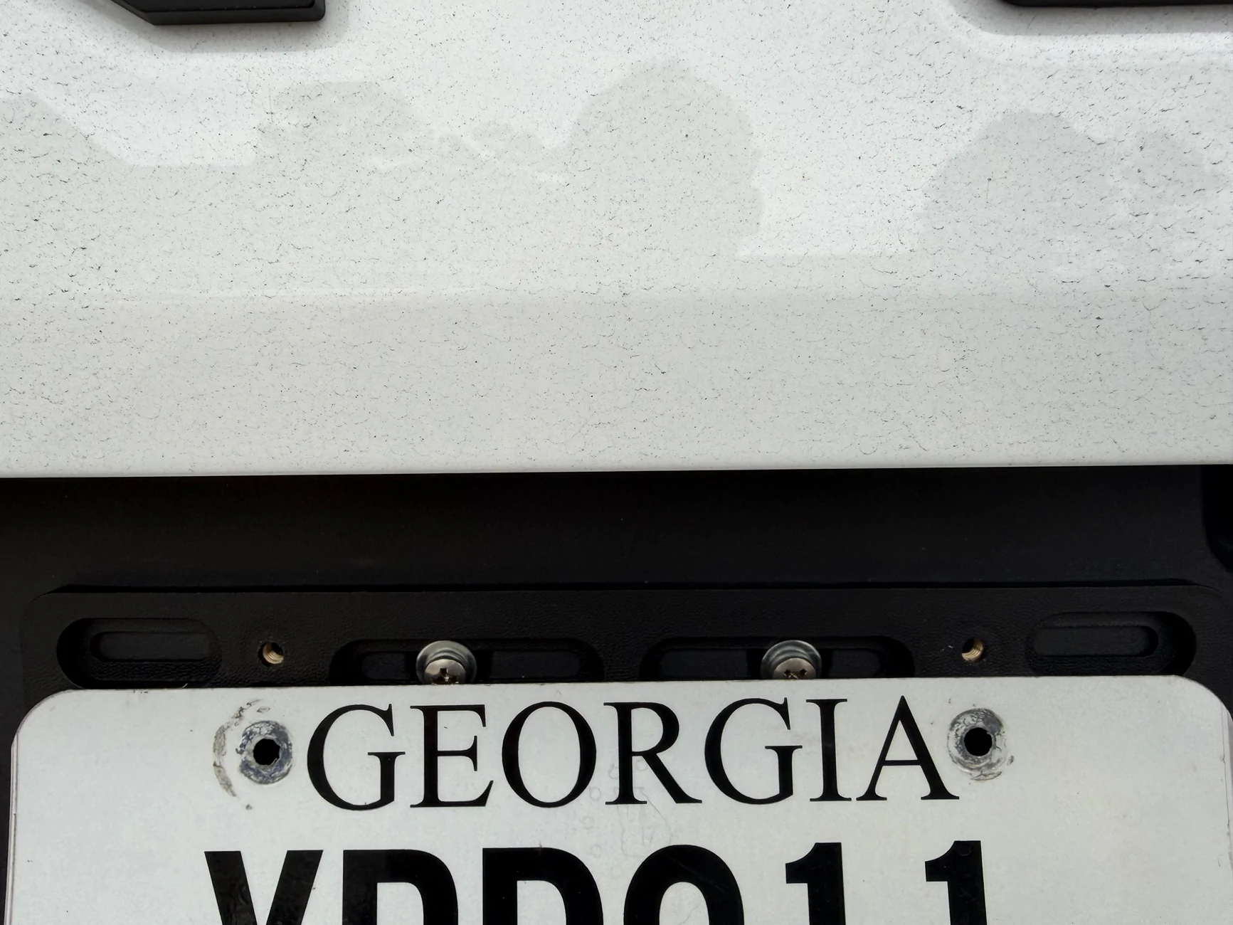

I bought this bracket and frame kit from Amazon. The bracket can be attached to the two threaded inserts in the bumper through the slots in the bracket. Then, mount the license plate to the bracket using the 4 threaded inserts in the bracket. Keeps you from having to screw your plate directly into the plastic area. My dealer had screwed the dealer tag directly into the plastic. When I removed it, I sealed the holes with black epoxy and then attached the bracket.

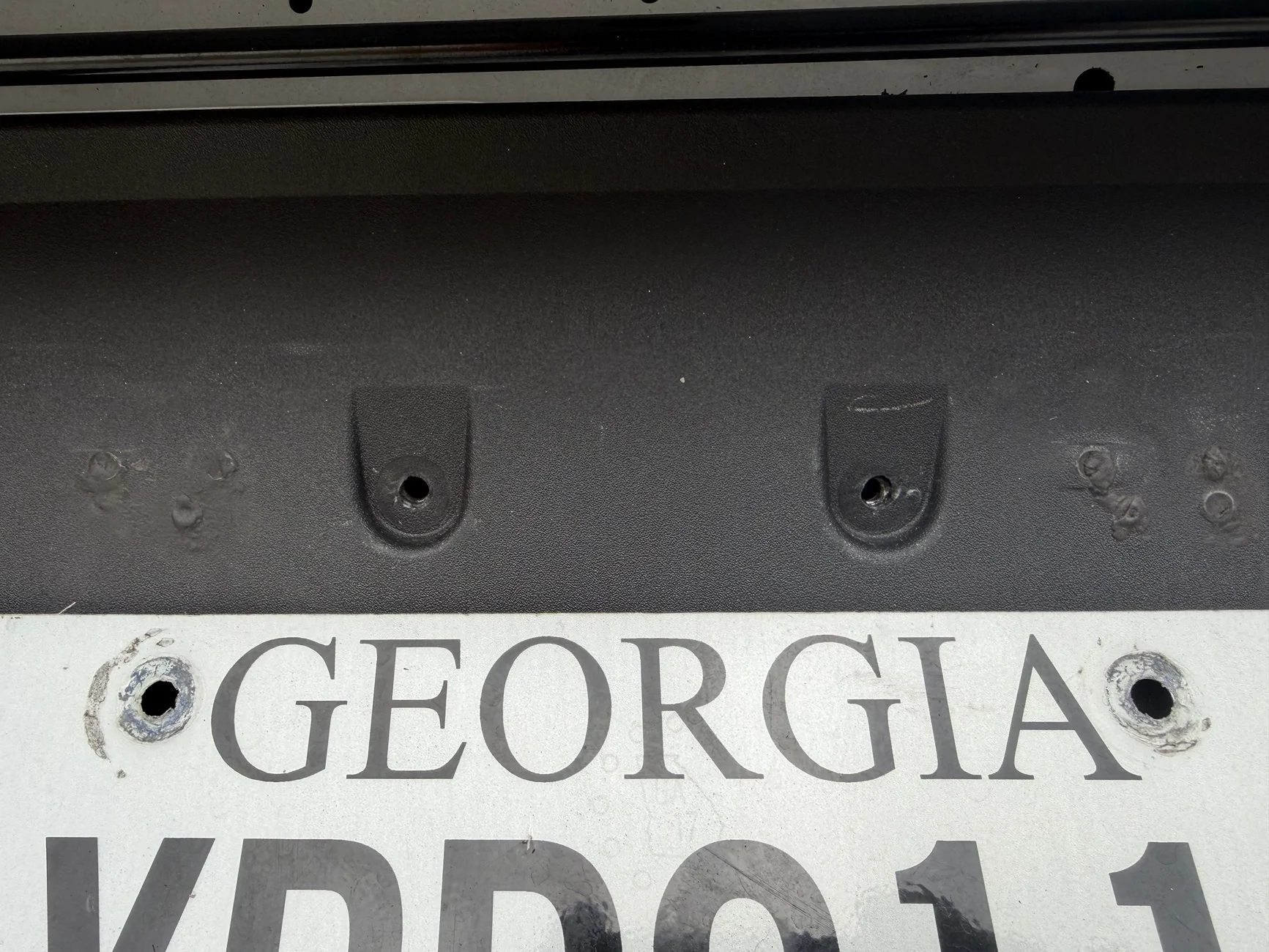

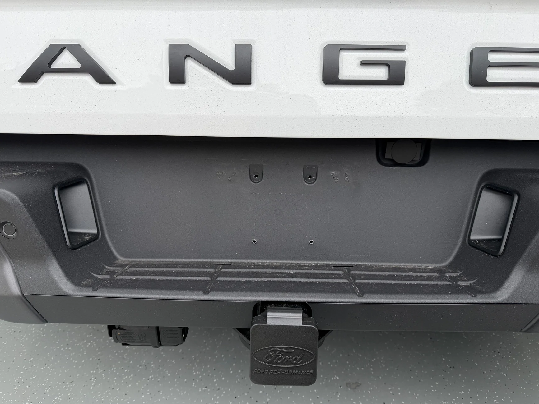

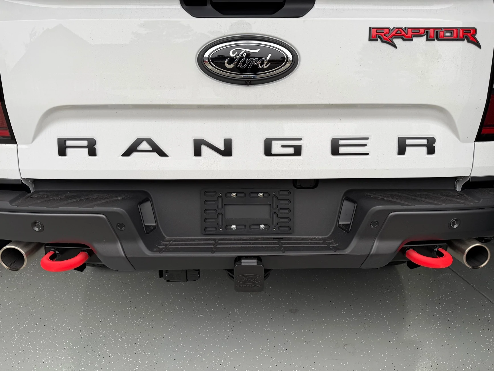

Hmm, mine is a North America build also, but the holes in the mounting area don’t match the spacing of the license plate holes. Hence, the mounting bracket. Maybe there was supposed to be something there that the dealer never installed. They just screwed the dealer tag straight into the plastic and it wasn’t even straight. That’s why I filled the holes and bought the bracket.
