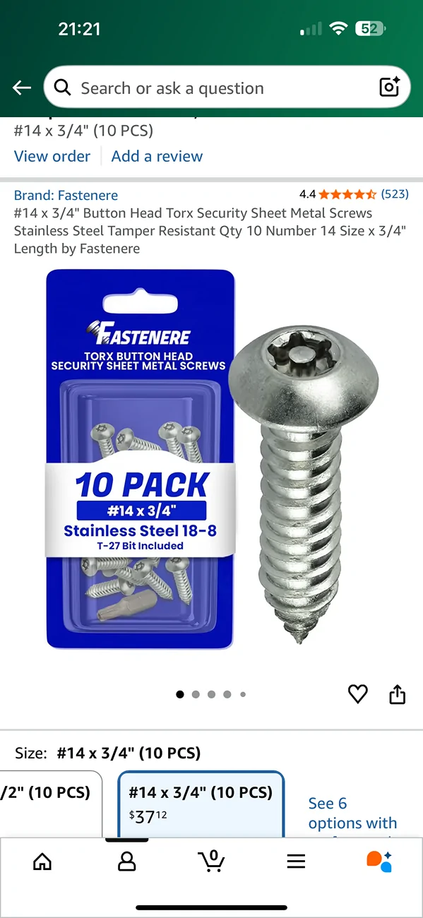

After reading the 5G forum for security screws and taillight theft, I ordered a set of #14 screws for my ‘25 Lariat. Found they don’t fit; the stock bolt holes are too narrow. Anyone find some or know the # size that fit? Preferably on Amazon (Canadian here).

from the photos of the guy the theft happened to, they popped in the lock/handle on the back of the tailgate and use a screwdriver to open the mechanism; tonneau or not. No garage here unfortunately but I figure any attempt as small as a security screw is a good preventative measure. If they really want them, they’ll get them but they’ll have to work for it. 🤷🏻‍♂️ I’ll look into the metric screws, thanks.

The tail lights are fastened on the 6G trucks with M6x1.0 threaded fasteners. You could get the same security Torx drive on an appropriate fastener and that would work for you.

I forgot to mention, if you go with these screws, do not use an impact driver on them. Hand tighten and loosen only. You will break the small tabs of the driver bit with an impact driver.

Found these:
https://a.co/d/baZTyTD
Thanks for the help everyone. I’ll report back with my findings.
center punch or small flat head screwdriver and a hammer, knocks the pin out, and you can use a standard torx bit then. after doing it before when I snapped my security torx bit on a rusty bolt. was able to get it out a full torx bit. you want speciality security bolts, that canadian tire or princessauto doesnt carry the exact bit/tool needed to get them out. lol
