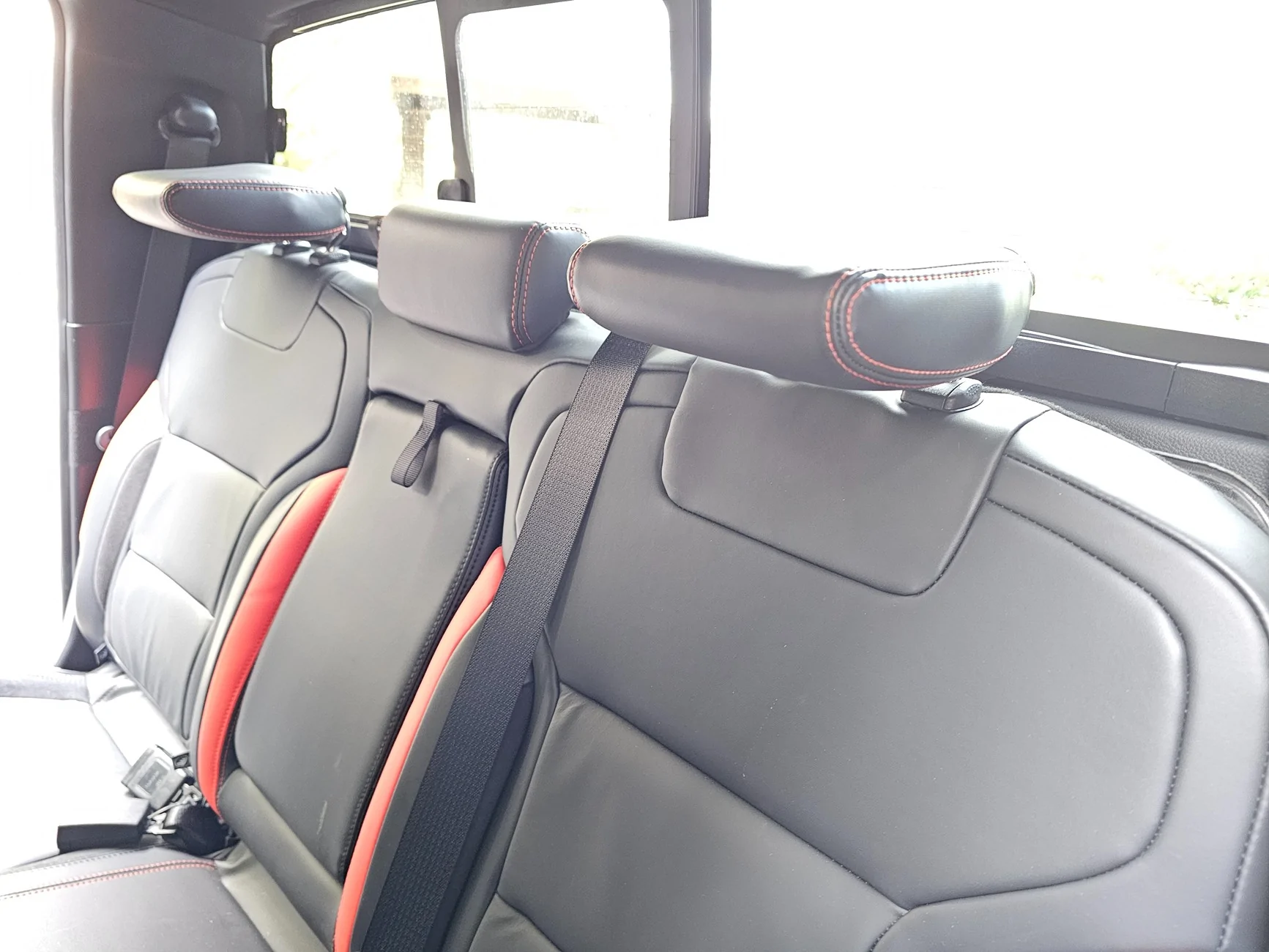

I moved my covers over to some 5g folding headrests.
Smart idea! Now I need to find some because that looks great!

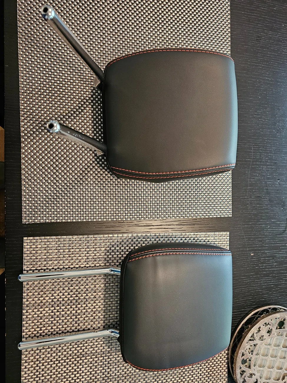

OK. This was the easiest upgrde ever.
Ford Ranger Rear Seat Headrest Replacement Ford headrests

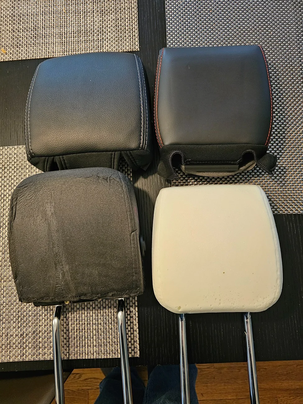

Stripped the covers from both the new ones (folding) and the original ones (Raptor).
Ford Ranger Rear Seat Headrest Replacement 20260225_122236
Switched the cover around. Did not even bother cutting a hole through the material. You can feel and press the fold button through with no issues.
Ford Ranger Rear Seat Headrest Replacement 20260225_121822
That's it. Folding headrests with the proper red piping...
Ford Ranger Rear Seat Headrest Replacement 20260225_122901
Took 15 minutes at most...

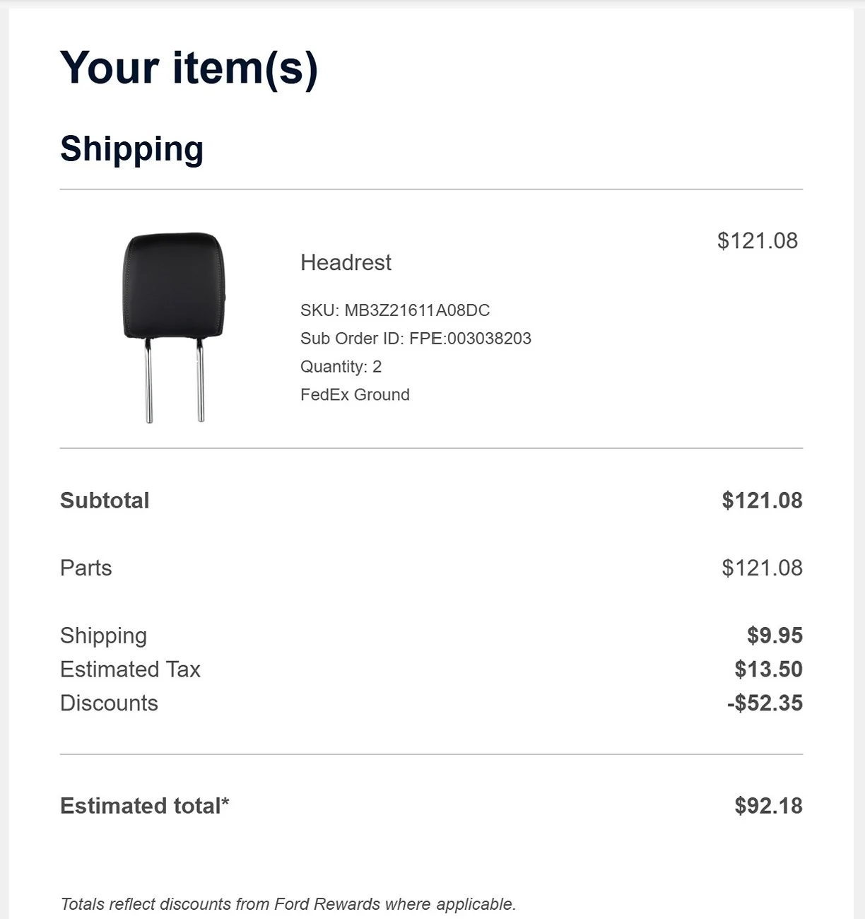

@bossy -- Thank you so much for post #96 with all the pictures and the correct part number. I just placed an order through Ford for the same 2 headrests as in your post and am very excited to finally be getting a clean, tidy solution to this glaring oversight by Ford. Much appreciated!
fordgt
Jul 27, 2024
92
718
688
2024 Ranger XLT
Yes, I just ordered mine from Lakeland Ford. $48 each and $12 shipping. A few places had them a few dollars cheaper but shipping was almost 3x’s as much.
