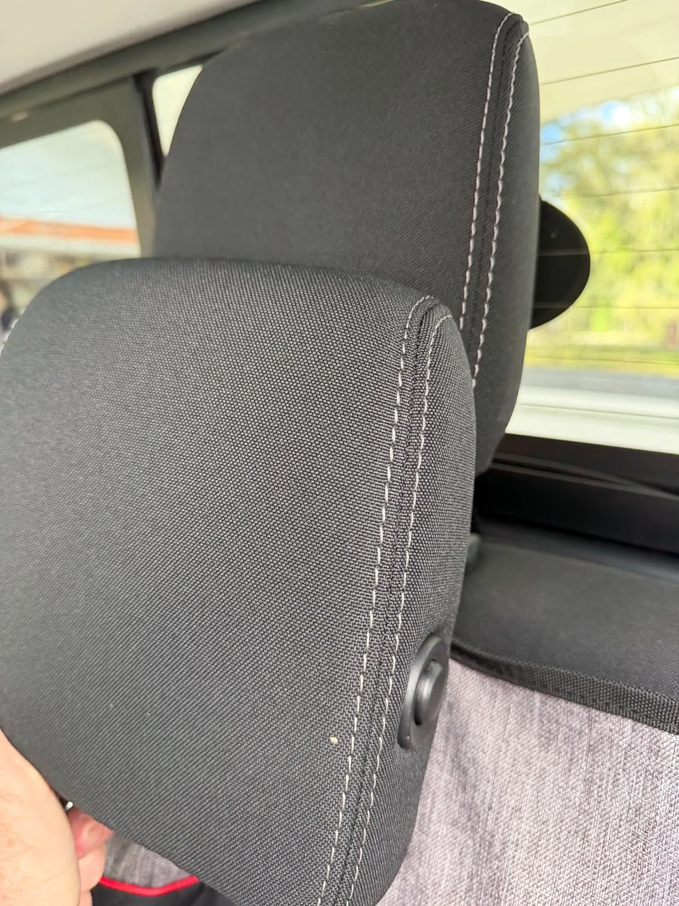

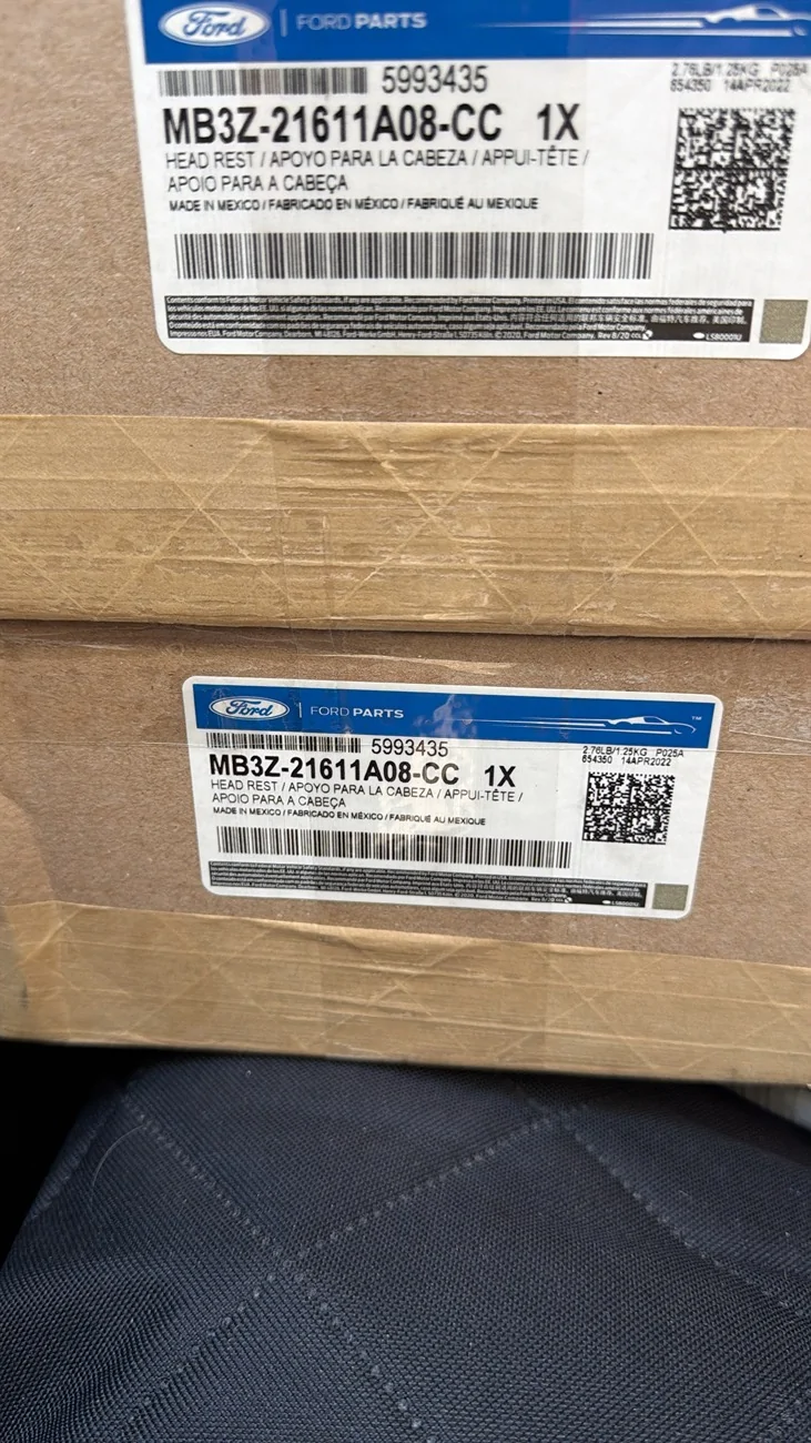

Got mine today! $47 each plus $13 shipping from Lakelandford.com
Ordered Friday received them today. Same color cloth and stitching!

Is it me or the picture but the weave on the fabric doesn’t look as tight as the original?
I looked again but it was getting dark. I will put them side by side tomorrow.
