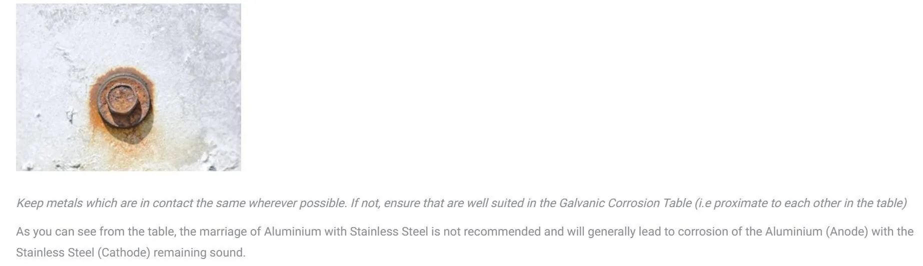

I like the product. Any concern about aluminum and having dissimilar metals (aluminum and steel)
bolted to each other? Aluminum and stainless would be a concern, but aluminum and steel in contact can also be in a corrosive environment.
Note: This, from your website, will help alleviate most of my concerns.
  • NON-CORROSIVE
    Marine Grade Aluminum alloy
    Coated in zinc primer and powder coating to protect from oxidation and enhance the appearance
  • NON-CORROSIVE
We apply a zinc-flake process to our fasteners and galvanize our aluminum skid plates before applying Akzo Nobel coating. As a result, no issues have been reported thus far from any market including humid and salty Asia and Australia.
